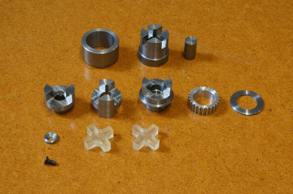

        I have made my own coupling for connecting my Westbury Seagull to its starter. It is a double coupling and is 9/16″ OD. It incorporates a belt drive for the water pump. The parts of the mould used to cast the polyurethane rubber spiders are at the top of the photo. The first ones I made were too soft. 70 Shore was about right.

                Nice work Charles, I may yet end up making the part attached to the engine and keep an eye open for a coupling that can donate the motor end and rubber spider

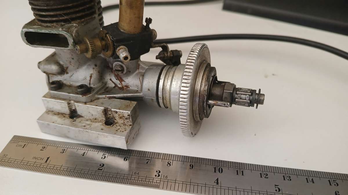

                        Looking at a few images of the Stinger engines it looks like the prop driver may have a grun screw to retain it. If so that should make it easy to replace unlike ones that have the “D” shaped hole. In that case you would not need such a deep recessed “cup” shaped flywheel.
                        I don’t think a particularly large flywheel would be needed. From my days of running 1/8th scale buggies there was very little in the way of flywheels, just the combined clutch and knurled ring for the friction starter and they were usually aluminium. A piece of 50mm steel should be quite adequate and being directly coupled to the motor once that is spinning it will have some flywheel effect.
