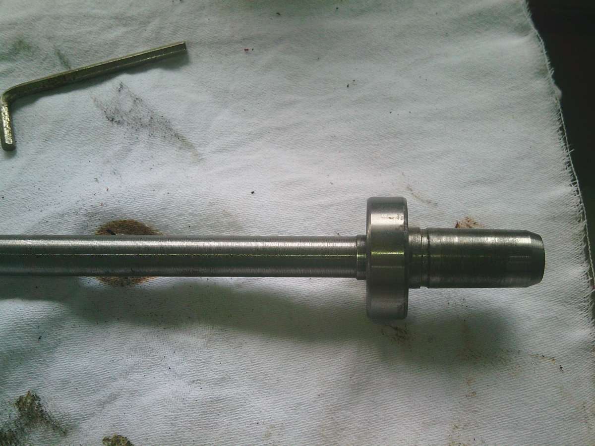

      I have spent the last few days restoring a Trademaster drill press which had a lot of rust on the main shaft. It also turns out that the chuck is both jammed (it will not turn) and it was stuck on . I managed to get it off the spindle after many attempts (bloody thing always use to fall off when I didn’t want it to. )
      I think I will need a new chuck. What is that taper on the spindle in the photo ? The chuck is marked B16 1.5-13mm.
      What would you soak a jammed chuck in for 24 hours to try to get it moving ? I was quoted $80 for a new one.
      DSCF0007
      #829751
      Hollowpoint
        @hollowpoint
        B16 is the taper. It’s a very common size so you should have no bother finding one.
