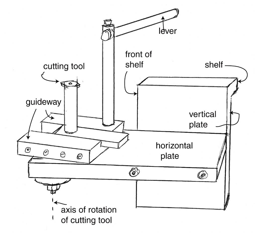

                        I bought a Repton RT1 ball-making attachment from Chronos several months ago and I find it excellent. I have used it for making small stainless steel knobs for optical devices and the surfaces were so good that they needed little finishing with emery paper and metal polish.
                        The only fault I have found is a lack of information: for example the type of insert is not specified. I found that for steel the rhomboidal carbide inserts (Tungaloy type P GRADE , DCMT11T304-24) that fit my lathe tools happened to be right for the ball turner. There is also no information about dimensions, just the airy statement that it ‘fits all lathes’, which is not true.
                        I have attached a sketch of the device. The whole caboodle is supported by the shelf, which fits into the toolpost of the lathe. Your toolholder must be capable of accommodating the 9.5 mm thick shelf, which many quick-change types on small lathes cannot. The axis of rotation of the tool is fixed at 62 mm from the front of the shelf. If your toolholder cannot be retracted by this distance from the lathe centre you cannot fit the Repton: this rules out my EMCO Compact 5 lathe. Another requirement is that the lathe centre is at least 78mm above the bed, since the cutting tool is at this height above the end of the screw underneath the horizontal plate. A problem highlighted in an earlier posting is that the clearance between the handle and the lower surface of the shelf is maximally 120mm. This is quite generous, but apparently some toolposts need more: to check this, measure the height from the bottom of a tool shank to the highest point on your toolholder. If more than 120mm, your are OK. On my Colchester Master there is no problem fitting the Repton and I think this would be true of most larger lathes.
                        It would seem that this product is good but lacks vital sales information.

                          Correction: I made a mistake in my recent post: near the end it should have said 'If less than 120mm, you are OK because the handle will clear the top of your toolpost'.
