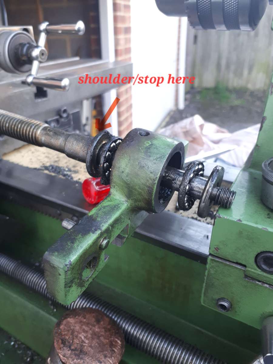

                          Here’s the original 20211102_155021
                          #826032
                            Seeing your arrowed “stop” looks like you may be dealing with endplay and not the screw rotating/play in the nut/screw.
                            Can you confirm if the issue you have is
                            1. The screw and handwheel slowly rotating under cutting loads
                            2. An in-out movement where the cross slide can be pushed pulled back and forth by either the cutter or just by hand.

                                Yes, it’s a no. 2 for Jason B, and the photo is the original trapezoidal crossslide screw, John ( I did write original)

                                  #826040
                                    So that is unlikely to be caused buy your current ballscrew and nut setup. The problem is the screw moving within the casting and no extra nuts or loctite will help
                                    Can you post a similar photo of what your replacement ball screw looks like.
                                    Ideally you would modify the ball screw to create a shoulder at the fixed end which typically involves reducing the diameter. Turn a “washer” which then slips onto the reduced diameter and becomes your “stop” and could be loctited in place.
                                    You then reuse the thrust bearing arrangement of the original with the bearing now running aganst your “washer” and the casting on one side and the other side has the bearing against the casting and handwheel.
                                    You wil also need to add the keyway if that was present on the old one to locate the dial and handwheel plus t  ethread for the nyloc nut that adjusts the bearings preset.

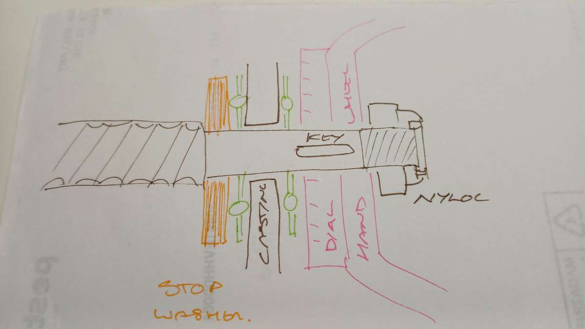

                                      Something like this. You may need to bush the diameter back up if the reduced diameter makes it a loose fit in the casting or the dial/handwheel bores are to big.

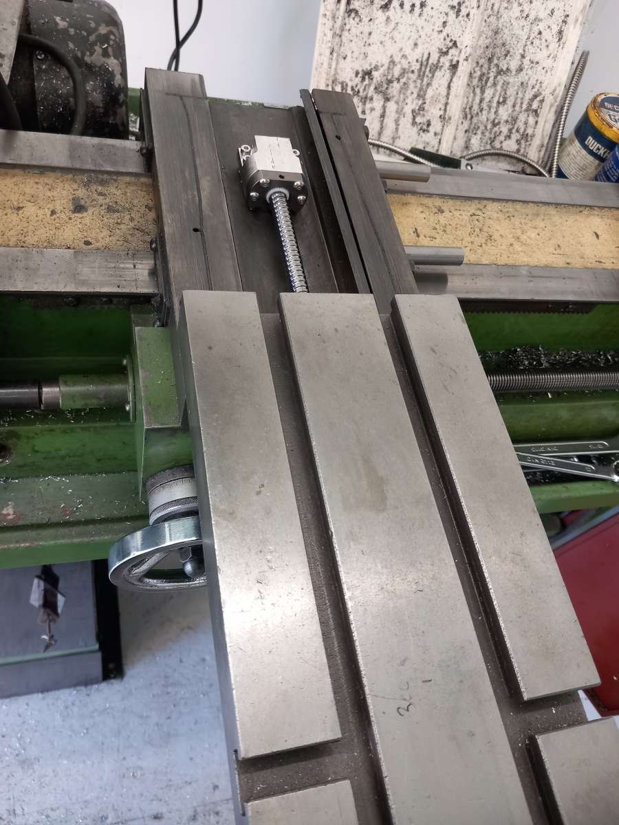

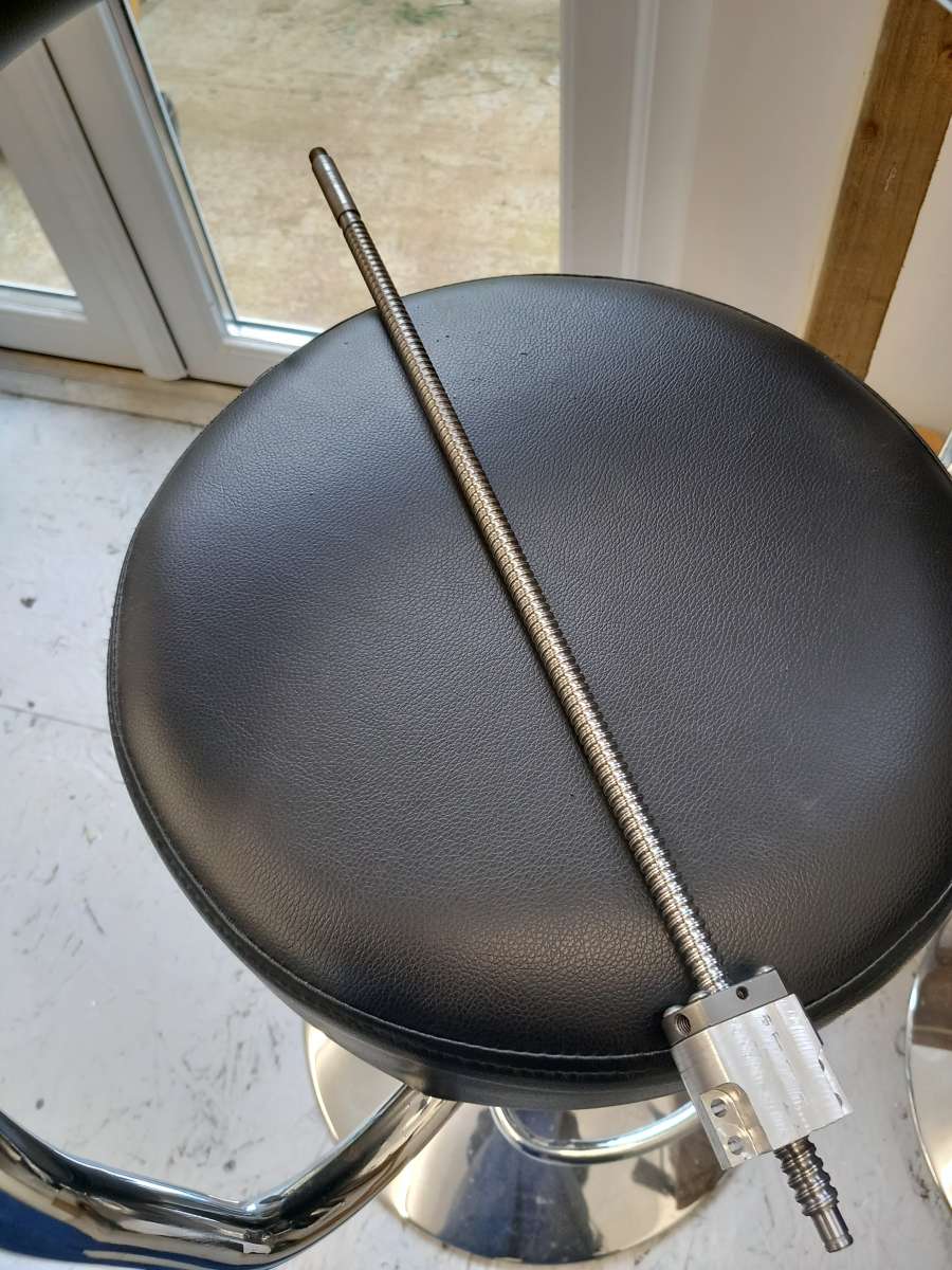

                                                20230513_18132320230510_182606
                                                #826288
                                                georgelane314
                                                  @georgelane314
                                                  The two photos are from about 2 years ago when I first machined the ballscrew and made the aluminium housing for the nut. You can just see the groove in the top left of the photo on the stool. I’ll attach a pic of it in situ, but of the opposite end to the problem, unfortunately. 20230524_104439

                                                    You are lacking that disc for the thrust bearings to work against.

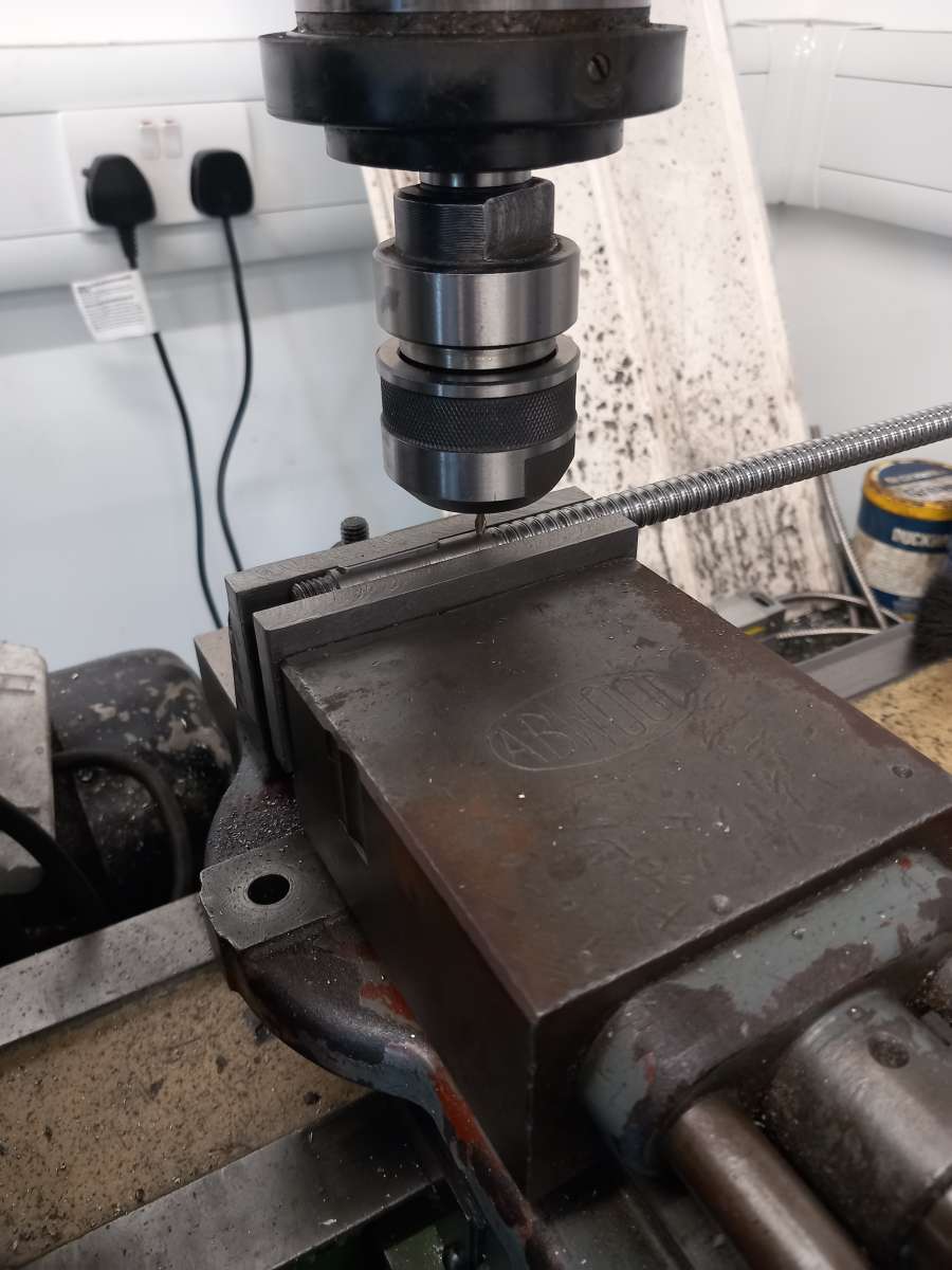

                                                    The photo where you are drilling, is that for  apin to join the new screw to the old end? If so can the pin be driven out and the two parts separated. You could then turn down a bit more of the screw and say a 3-4mm thick “washer” which would then act as your stop

                                                      In response to JasonB’s last comment, I recall that drilling was impossible, but I managed to turn it using a diamond tipped insert. This is an old picture when I had no idea about cutting the original screw, and the positioning of the mill might be just to stop the ballscrew tipping up in the vice! TBH I can’t remember.
