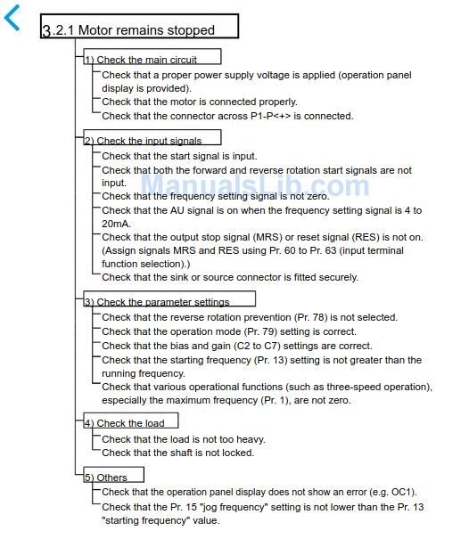

      My Myford ML7-R has stopped working! It runs on a 3 phase 370W motor (delta configured) and I've tracked the issue down to the Mitsubishi S500 inverter which whilst the display appears to show an output frequency, there is no supply voltage to drive the motor.
      **LINK**
      **LINK**
      I have tried various diagnostics including a factory reset, but it looks like my inverter has given up. The resistance of the motor windings are all healthy.

                    #443314
                      Posted by Mark B on 25/12/2019 17:35:42:.
                      So I need a new inverter!
                      Did the 'various diagnostics' include everything recommended in the manual (p146?)
                      Proudly owning older or posher VFD's can be double-edged in that they often come with a full set of bells and whistles, highly configurable and flexible, but not necessarily easy to configure or wire up. Not everyone enjoys reading a few hundred pages of rocket-science instructions and complicated wiring options! Cheaper VFD's tend to be much simpler (fewer options), and most new posh units have sensible default settings that will enable a basic set-up to 'just work'.
                      The Mitubishi manual lists several checks in the Troubleshooting section, not all of which are obvious.
                      I'd double-check all the wiring because a VFD that has a display, no errors, and zero output may be legitimately 'off' due to a faulty control input – loose wire, short, broken link, duff switch etc.

                        Mark B
                          @markb43031
                          Thanks for the page link above, these are exactly the diagnostic steps I've been following. It looks like the control part of the inverter is fine, but the power end fails to deliver any output. I've also had the thing apart and checked the multi plug connectors inside. There are no obvious burned components or popped capacitors either. Its is frustrating as given the unit is supposed to be so cleaver and can report all sort of errors, its got no idea of a very significant fault it clearly has.
                          Also thanks for the replies about the replacement inverters. 50/50 split here and I'm also on the fence. I've used a WEG CFW100 inverter on a small instrument/watch makers lathe and it was was easy to set up.
