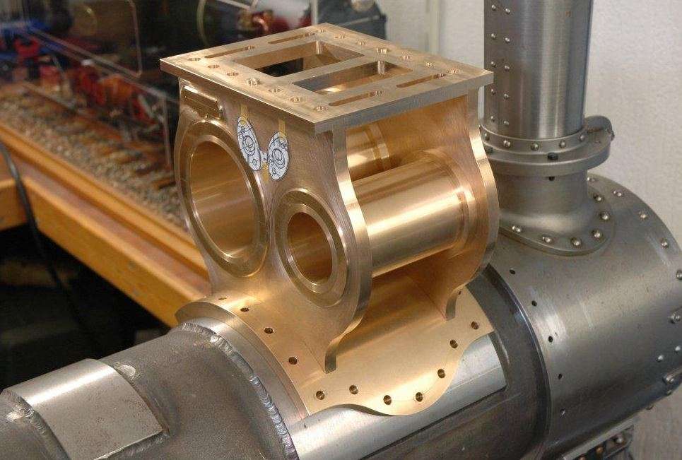

                              The horn brackets are another contender for silver soldering, Build it up with more material on the parts to be machined and treat the fabrication as a casting doing the final work after soldering. If you can stick bits of wood together to make a pattern then silversoldering bits of metal together is not a lot different and you don’t have to worry about getting the metal to flow into thin section castings.
                              I’ve an almost complete set of Superba castings but am unlikely to make the engine now. However Even when I was likely to have built it not many of those castings were going to get used and now I have the CNC even less would be used. The Hornbrackets would have been fabricated.
                              A bronze cylinder would have the advantage that it is easily silver soldered be it a full fabrication or just the ability to add bits that would not be so easy with Cast Iron. There is a very nice R3 Fowler on TT with built up cylinder, another Dutch guy. Similar cylinder in here for a “Big Lion”

                                Yes, that’s just the sort of thing I had in mind for a fabricated cylinder. I haven’t got time to look now, but it looks like there are some other unconventional techniques described in that .pdf.
                                I was thinking more in terms of 3D printing patterns – though that means doing battle with a 3D printer. Still, I’m told they’re less contrary now than the early one I had, and disposed of.

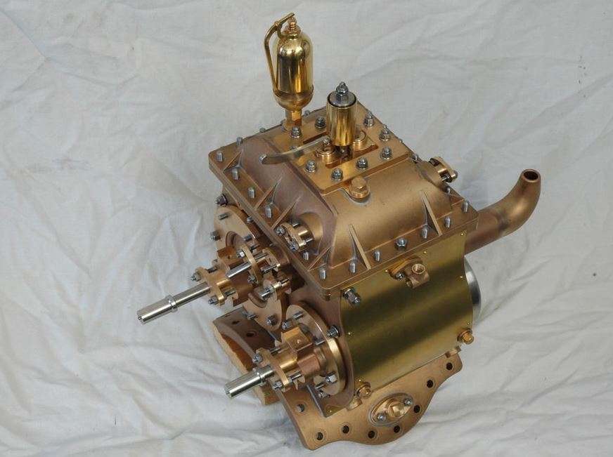

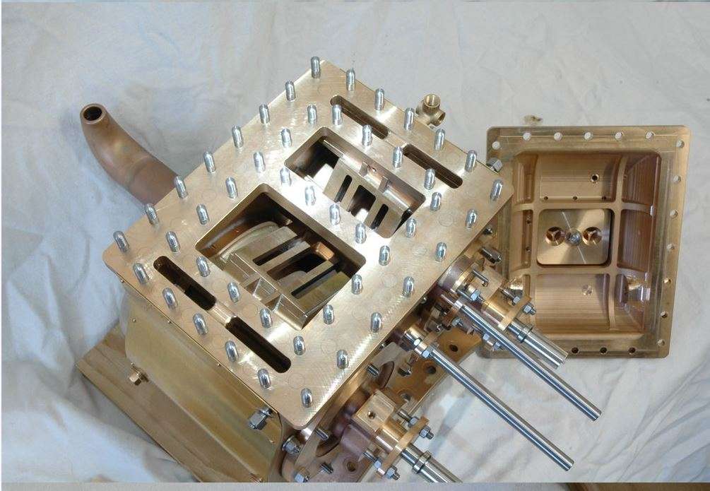

                                  r3 1
                                  r3 2
                                  r3 3
