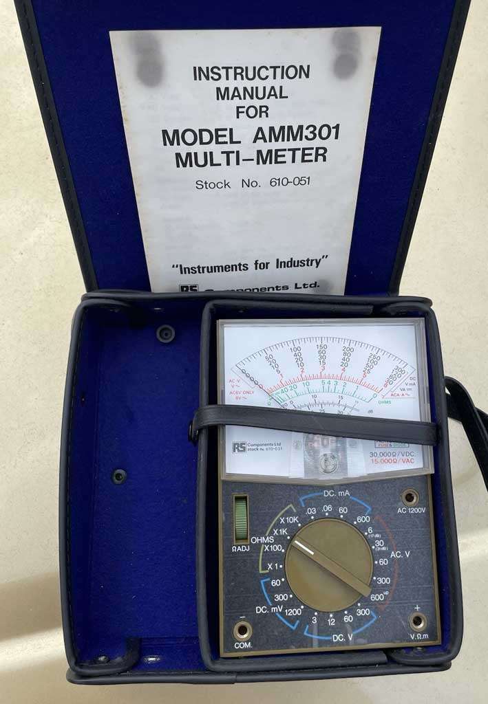

                      Robert Atkinson 2
                        @robertatkinson2
                        Hi Dave,
                        If you can wait a few days I have a job lot of stuff coming in which has a couple of RS Components AMM301 multimeters amongst it. They look virtually unused. They are 30 kilohm per volt, large scale. Resistance to 2M in 4 ranges. They have a tautband movement so very rugged. Only two short falls. Current is only up to 600mA (you can use a shunt) and the sockets will not take shrouded plugs so not suitable for mains.
                        Random picture from web of one.
                        Let me know if you want one.
                        Robert.AMM301

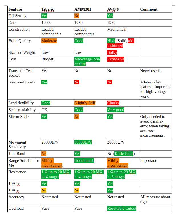

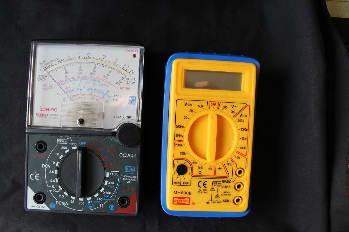

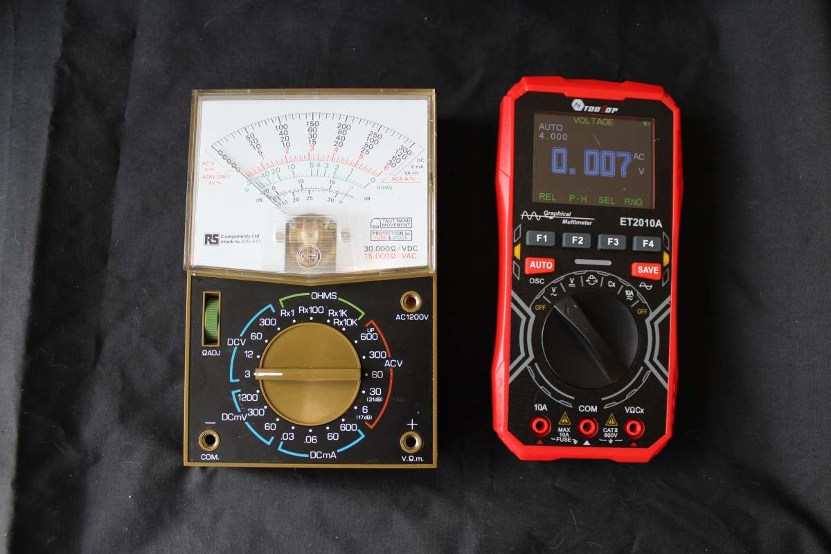

                                  Quick update.  I’ve received the ET2010A DVM recommended by Huub and Robert’s RS meter.  Robert’s meter needed TLC because batteries had leaked, doing some interesting damage.
                                  What I use at the moment, both budget meters.  I also have an Avo 8.  The analogue meter started this thread by sticking, read on for twist at the end!
                                  Their application is mainly low voltage electronics.   In general the DVM is used when values are measured accurately, whilst the analogue meter is good for “does the needle jump” tests, continuity and such.
                                  IMG_5391
                                  Robert supplied a nice RS-Components meter, expensive when new, and made circa 1980 at the pinnacle of analogue meter development, just before Digital meters kicked off big time.
                                  My old meters above replaced by:
                                  IMG_5392
                                  Same functions as my original meters, but both are an improvement.
                                  Analogue meters as scored by me: your mileage may differ!  Best match to my needs is the RS meter, my old meter does surprisingly well, and the much venerated Avo8 scores a lot of reds.  Mainly because it’s a boat-anchor.
                                  Screenshot From 2025-11-18 17-54-15
                                  Nothing is perfect!  The RS meter pre-dates shrouded leads, dodgy when measuring high-voltages.  Doesn’t matter for low-voltage work.  Also missing, no OFF switch, a small thing.  The meter comes in a decent case, which is good.  The Avo8 wins whenever I need to measure a heavy AC current, otherwise rarely allowed out to play.

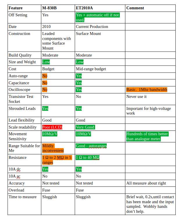

                                  Old and new DVMs compared.  Both budget instruments; the ET2010A wins:
                                  Screenshot From 2025-11-18 18-11-34
                                  In conclusion:
                                  • Both replacement meters are improvements – I’m pleased.
                                  • None of these meters are suitable for high-voltage or rough work.  They’re great for genteel electronics, rather too delicate for bash about automotive work, and an electrician is advised to buy a CAT rated meter.   Although the Avo is built like a battleship, they don’t like being dropped.  Accuracy not tested beyond ‘close enough’.  Not in the same league as a bench meter.  Fortunately I don’t need one.

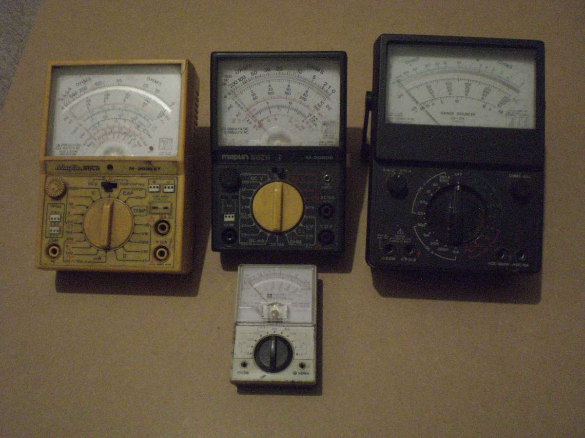

                                              Hi, I’ve got a few analogue multimeters, but I don’t use them very much now.
                                              CIMG3489
                                              However, although the black one with the yellow selector is okay as far as the electrics are concerned, it’s un-useable, as the the plastic part that holds and turns the selection  contactor is broken, and although I’ve thought of ways to fix it, I haven’t found a suitable solution, I dare say a new one could be printed these days, but I don’t know anyone in my part of the world, who would be able to do it. It was a black selector originally, but that one broke, and Maplin Electronics, at the time sent me that new yellow one. The other black one on the right, is a Micronta range doubler, which was given to me by a workmate, many years ago. The little one is a TTC model C 1000M, which is fairly basic, but has had its uses, and was small enough for my tool box at work for occasional use, and doing checks on my car.
                                              Regards Nick.
