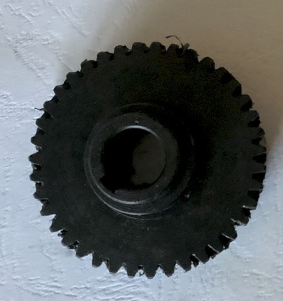

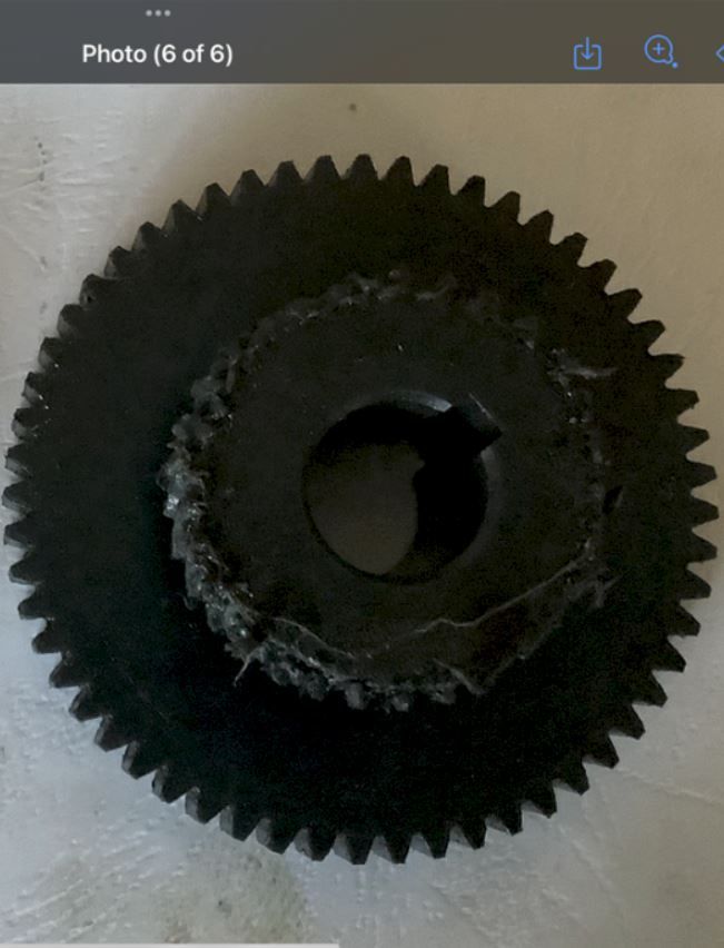

        Hi,
        I have an RDG 30VSM which has mashed its gears. Could someone please point me in the direction of where to get replacements, please? Looking at the forum, it seems they are similar to the Warco WM16, but the gearing looks different? Thank You.
        https://www.ebay.co.uk/itm/113999695630
        #590817

              Unfortunately no joy. The answer was "we got them from the same places as Warco".

                  Is it a 56 and a 31 tooth?
                  if so i have one

                    You can get an idea of what gears you require by measuring the OD of the mating gear, and counting the teeth, as well as the other dimensions..
                    The gears are likely to be Module, so Diameter in mm / (Tooth Count + 2) i= Module.
                    EXAMPLE
                    OD = 27.5 mm / (20+2 ) = 1.25 (Module ) for a 20 tooth 1.25 Mod gear.
                    The answer may well be 1.5, 1.25 or 1.
                    You could look at other importers to see if they import a similar machine (Possibly only in a different paint scheme) who could supply a replacement.
                    Likely places, once you have measured the gears, and knowing the tooth count of the damaged gear, might be Chester, Axminster Arc Euro, SPG, Amadeal etc.
                    Bear in mind that some machines, although superficially identical, may differ in detail. Depending on the manufacturer,, the keyway, for instance may differ, (Say 4 mm against 3 mm),
                    If all else fails and only the bore is different, you might have to bore out and bush a close approximation to get the machine running again.
                    Ultimately, you could approach someone like HPC, or Davall or Reliance gears, but their gears are likely to be costly and need modification to fit your machine.
                    The only other advice that I can give is not to work the machine quite so hard in future
                    The plastic gears are the weak point in the drive train and fail safe to protect other components, akin to a shear pin..

                        Posted by Ian Parkin on 21/03/2022 14:47:06:
                        if so i have one
                        The single Large Helical is 39. Large is 56 Fixed to 30

                                      Are you sure on the fixed pair of gears?
                                      i have a set off a 30vsm spare and they are 31 and 56 and the helical is 39

                                          Posted by Ian Parkin on 26/03/2022 10:20:29:
                                          Having recounted. You are correct! that gearing is what I need. THANK YOU!!
