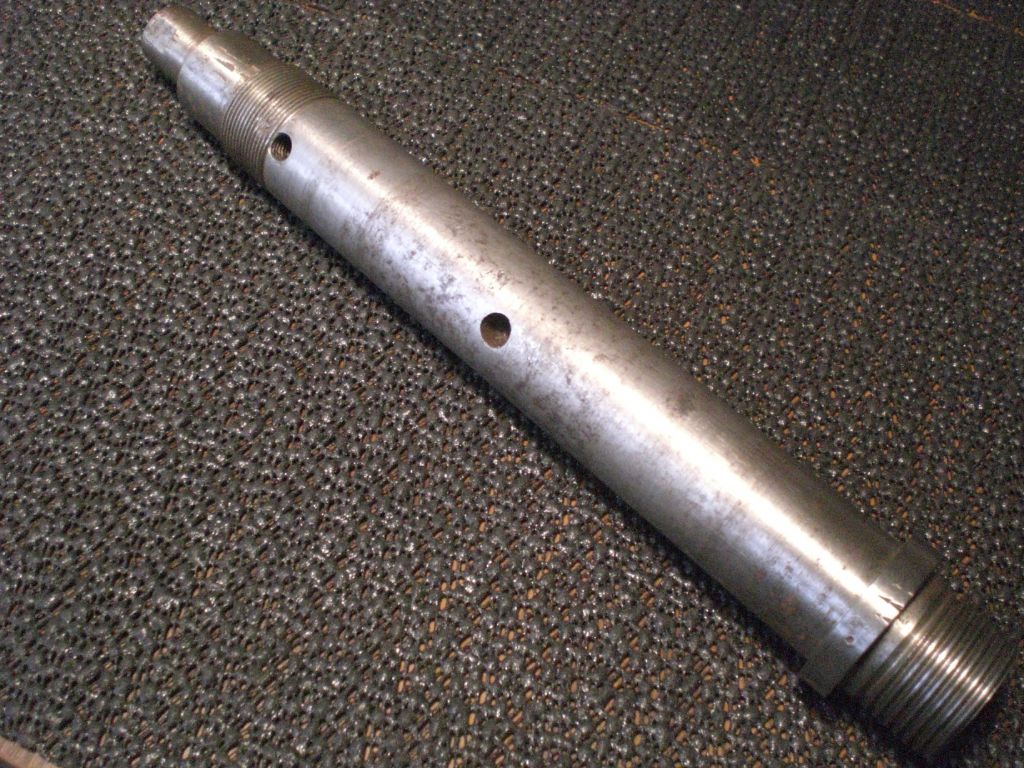

      Hello everyone, not only am I new to model engineering, I also seem a bit thick in understanding how change gear works.
      Let me be more specific , I have just a acquired an old Randa model A long bed, and one or two items are missing from the back gears, in trying to understand what should be there I find myself confused about the operation of the banjo lever at the back of the lathe.
      When operated it engages with the small fixed gear next to the flat belt pully, at the same time it engages with the large gear fixed on the back of the main shaft. Ahead of this there is a a small 30T gear which is also fixed to the shaft.
      Since the 30t gear is already fixed to the shaft, what function does the banjo serve?
      It would make more sense to me if the large gear and the 30t gear shared a common rotating shaft/tube independent of the main shaft, which on my lathe doesn't seem to be the case.
      Any help would be much appreciated.
      Thanks, Mike.

            Back gear and change gears are two different things.
            The back gear allows the spindle to run at lower speeds and with higher torque. When engaging it you should also disengage the direct drive. This may be done using a peg on the bull gear or by loosening a grub screw in or near to the drive pulleys.
            Change gears allow you to drive the feed screw at different speed ratios in sync with the spindle, either for screw cutting or power feeding.
            Many (most) lathe jobs use neither so I would not worry about them until you have done some straightforward jobs.

              Hi Clive and Andy, thank you for your speedy responses.
              I have had another look at the lathe and see the grub screw you spoke of, and sure enough on releasing it everything made clear sense to me.

                    Hi, on both the RandA type A & B lathes that I have, the spindle has a shallow hole for the pulley grub screw to lock into and this is directly in line with a dot punch mark on the register flange that the chuck backplate butts up against. Neither of these have an auto knock off for for the feed for screw cutting or turning. The threaded hole at the left hand end is for a cheese head screw that acts as a key, for the large back gear wheel that fits in this position, as seen in the bottom photo below.
