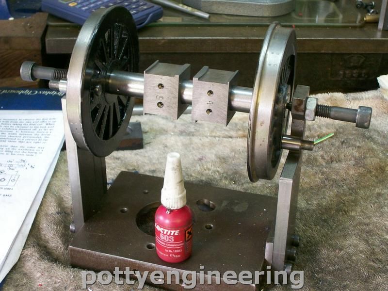

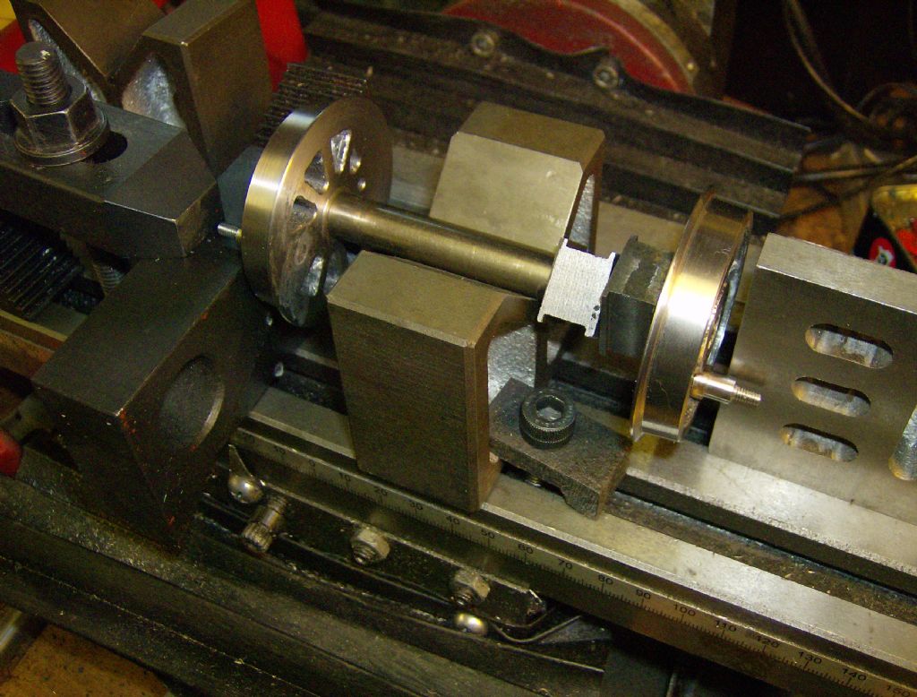

            My own approach is a bit cruder:

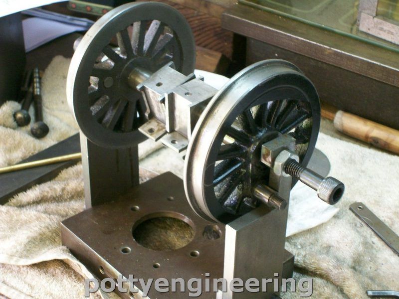

                I'm struggling to see what the query is it looks just the same as the set up I used with a borrowed jig from my club.

                  hi stew,
                  your club jig is exactly the same as the one i made. very good design.

                        Hi Steve
                        Using the lathe could you set the wheels in the four jaw chuck and on centre in the tail stock.
                        Then with a jack between the bed and one of the chuck jaws, set the crank pin against the top of a bar in place of a tool set in the tool post, that would be position one.
                        Then rotate the four jaw and set the jack under the next jaw and move the cross slide and tool bar to the other crank pin and set the pin against the tool bar, that would be position 2.
                        That should get the desired angle within a fraction of a degree, chucks are pretty accurate and the lathe is giving you good axial centering.
                        The jack is just a short length of bar stock with faced ends machined to fit flat against the underside of a jaw and the top of the bed, handy for various marking out and machining jobs. Unless all your chucks have the same thickness jaws you will need a separate jack for each chuck.

                                  re duncan's very valid point re me i accept my comments were misplaced and on closer study of ME not justified. my apologies. i was thinking of something else recently in print.
                                  Stew's method is what i use with loctited wheels.

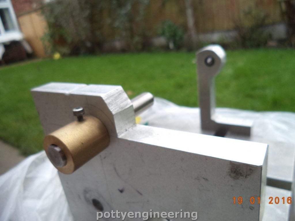

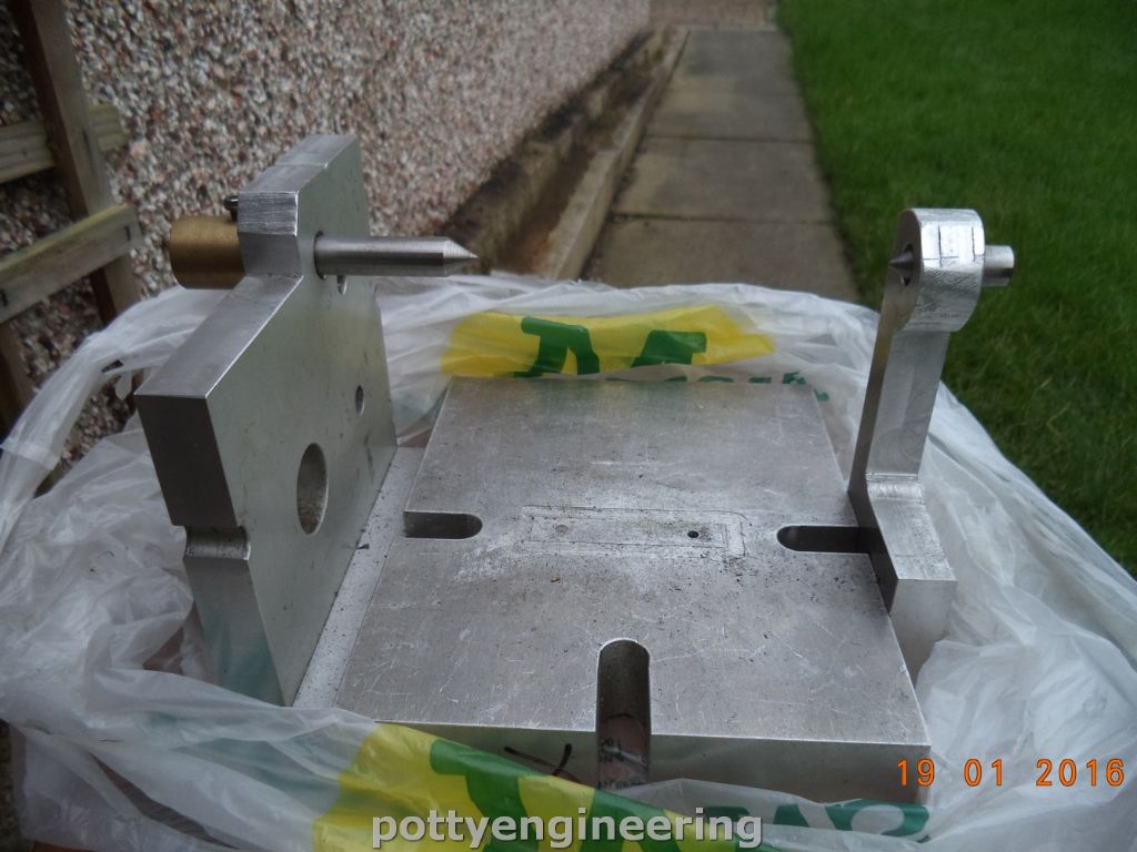

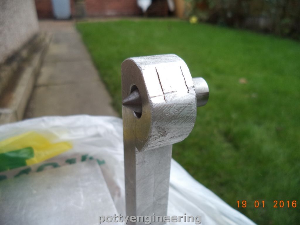

                                    .Just to add a little extra slat to the discussion.
                                    I bought my loco part finished, it had been made with more enthusiasm that skill, to cut a long story short I had to remake the axle boxes and axles and replace the crank pins in the wheels the only thing I used as bought was the wheels. I had one hell of a job to get the drive rod to turn over things just kept locking up, tried all sorts to fix it without success.
                                    Any way in desperation I made a new quartering jig as I didn't like using the screwed centres the thread was a bit sloppy and I thought that was introducing error in the quartering. I change the design to have one fixed centre the other was just a plain rod a close fit in a long bush to control the slop, See pictures.
                                    Even with this improvement to the quartering it still wouldn't turn over, I'd checked everything and rechecked it the only thing I hadn't checked was the crank pin centres as I thought no one would get something so fundamental wrong, in the end I checked them and yes they was up to 3mm difference in the six wheels no two were the same, so I recut the so they were all the same put in some oversized crank pins and as if by magic the motion was a smooth as silk.
                                    The moral of the story is you really need to get an understanding of the critical features that make a loco work, and never, never assume something is correct when following on from someone else.
                                    Stew
