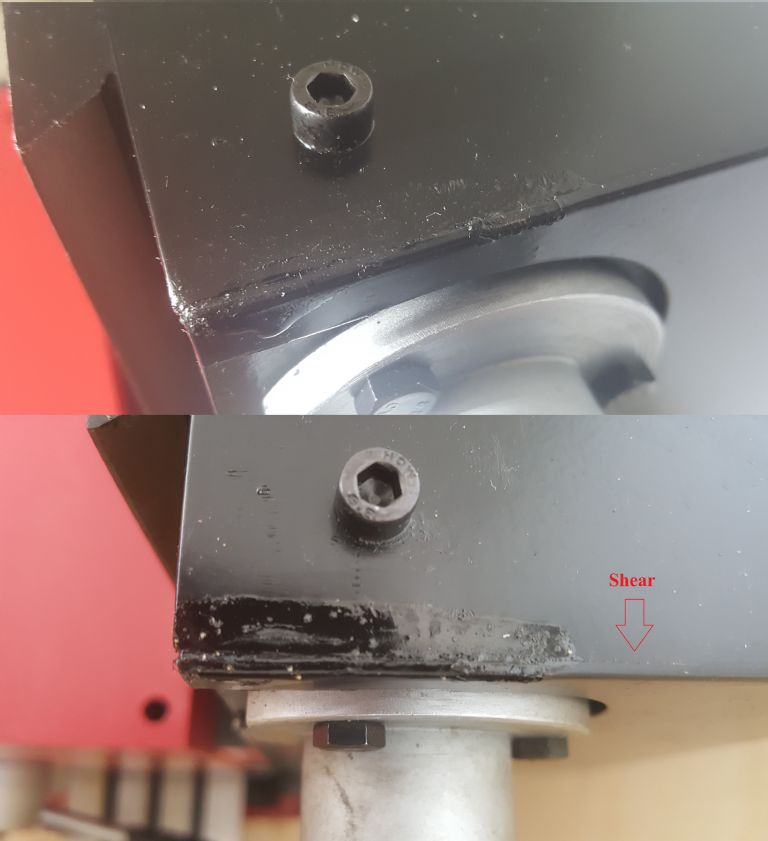

            I am surprised to read that a corner of the top-back cover on the second machine had 'sheared apart'. Could you show some pictures of this?.
            It is true that most Chinese factories will touch up paintwork where it may have come off, be it SIEG or any other. With reference to alignment, ALL Chinese machines in this price range are first assembled, and then checked and adjusted for alignment. Possibly not the best practice, but that is the way it is.

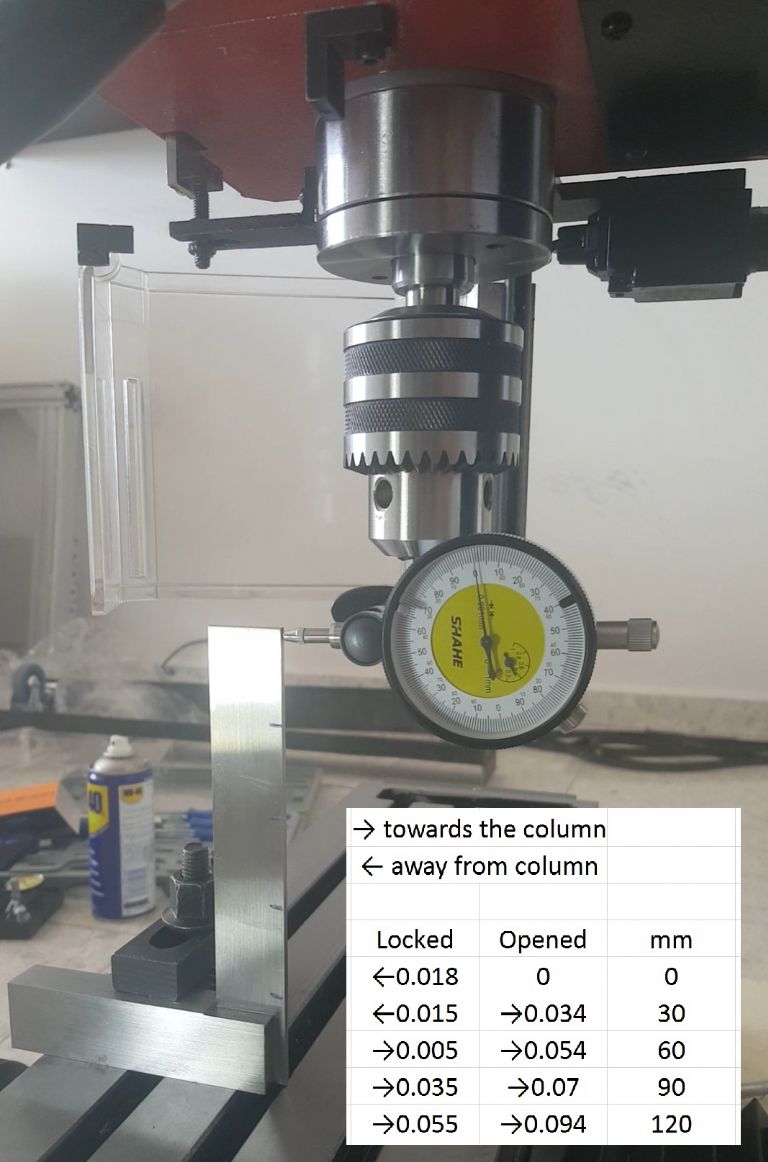

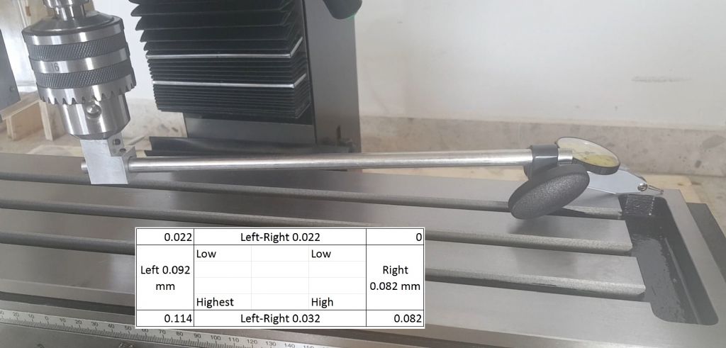

                    At first, I used a centering Indicator to measure the table normality relative to the spindle, however the Supplier gave me a number of a co-worker who is a Mechanical Engineer and he said that this is not a valid test. So according to him (and videos seen on YouTube) I built a rigid angle made from a rod of 10mm diameter of SS304 and 20mm aluminum block that I connected to the spindle and measured the end of the table. The radius was 35cm and I measured the right side to deviate by 0.2 mm and the left side to deviate by 0.12 mm the left to right deviation was 0.42mm! When I used parallel to measure the flatness of the table it was across the y axis about 0.04mm, I could see light going through easily. When compared to my old x-y table this looked terrible to me… I also measured the table height relative to the head which was around 0.1 mm on top of that I had paint that fell of at some places and rust on bolts and the overall experience was not good. So the seller gave me the option to get a replacement. – It is unfortunate that at this time I didn’t thought to adjust the gibs.
                    When I got the new mill, this time I reassembled the gibs and tighten them properly (first only in x and y than also in z). I used the centering indicator that I was told is not a good indication and it was spot on! 0.01mm deviation over 20cm.
                    And when I used my right-angle tool that I have built I measured 0.12mm on the right side, 0.16mm on the left and 0.09mm right to left. That made me think – “great” I can shim the column and it will be perfect!. Then I measured the table relative to the head not the spindle. I got 0.09 mm change on the right, 0.13 mm on the left and 0.03mm right to left. So again, only need to adjust the column. BUT – in the first measurement, the higher side of the table was the one close to me, on the second measurement the higher side was the side next to the column! At this point I knew I don’t have a problem on my x axis only on my y axis but then I found out:

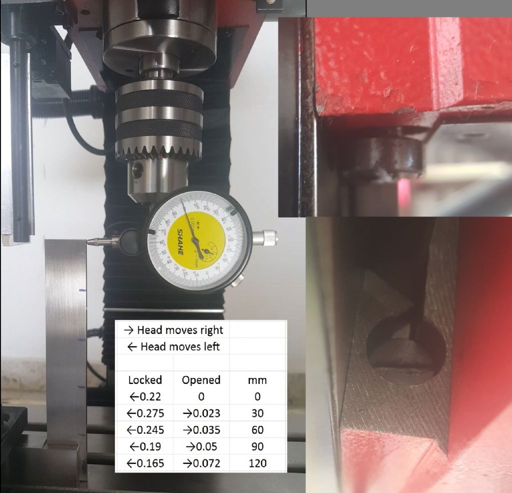

                      I saw that when I tighten the head the dials move all over the place, so I measured its movement, and the head moved to the left by 0.2 mm when locked. So I tighten the gib all the way down the movement only changed to 0.1mm which is still not good compared to 0.05mm in x and y axis. I then moved the head up and at some point the head got stuck! After some inspection I could see that first the head is not centered it is pushed to the left, and second that the milling done on the column bed is uneven. And in essence, the bed has a trapezoidal shape. So I either lock the gib all the way in and lose ~7cm of the top of the column or release it and have a play of ~0.15mm when locking. So at this point I thought maybe it doesn’t matter if I lock it all the time but again I was wrong! I took a machinist right angle tool and attached it to the table. And marked every 3 cm the height, then I measured the movement of the head relative to the table, I found out that when I don’t lock the head I move 0.1 mm in one direction, when I tighten it I move in the other direction by 0.16mm and that is over 15cm.
                      So, from the last measurements I realized that my readings are changing relative to the height of the head, that is why I got a spot-on measurement with the centering dial and not with the tool I made. (The height with the centering dial is probably the same height for which they adjusted the gib since it is tight at the top and loose at the bottom).
                      Regarding one of the comments, the second mill cover at the back was sheared at the top as if it got hammered and sheared open, and they simply someone took a brush and painted on top of it (the brush was full of sand or something of the sort&hellip

                          Nir, as mentioned by Ketan it would help to see some photos of how you are testing the machine then those answering will be better informed to offer help. There is nor restriction on how many posts you need to make to add photos either hosted elsewhere or added as described here.

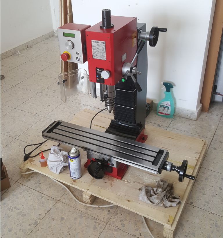

                            I didn’t took the machine apart, I check it still in its box, I added some wood blocks underneath to reduce the movement of the mill, I am sure it will change when I pace it on a proper table, but I don’t buy the claim that it will change completely, it will move probably but no more than a few hundreds (~0.02 mm). I only cleaned it truly and removed the gibs, cleaned them, applied little engine oil to them by hand and locked it until I had proper resistance on the handles. Which gave about 0.05mm movement in the x and y. But as I mentioned, I have the real problem in the z axis, as I described earlier.
                            When I said 100% true, I meant that I didn’t made the parallels myself, I bought them, and they are supposed to be within a 0.01mm accuracy.
                            My intension is to have the ability to make two part with a few holes at certain location, and not worry that the holes will be aligned, I am tired of making bigger holes to account for deviation of my old press drill. I have no idea what I will do with it in the future but milling accurate parts could help me a lot. For my work real 0.1 mm will be perfect but over ~50cm. Error adds up as you already know, and I expected this machine to be a lot more accurate.
                            The serial number on the first mill I got was 90415 and the one on the new mill is 90414.
                            Since everyone seem to not trust my measurements, I have an idea, I can ask the seller to check the first machine that I already returned, by a professional, it will cost me around 200 USD. And if he confirms that the machine is inaccurate, we know the problem is with the machine. If he confirms otherwise, we know that I am the problem, and I can ask him to return the machine to me – but then I will be sure I got a good mill.
                            As for your videos, I did the same tests, except that I used the chuck since the ER collet that I ordered a month ago is still on its way… And buying it here is not an option.
                            I am afraid from the rust since I know that it may shorten the life of the circuitry.
                            The paint is just cosmetics – but it indicates the “quality assurance”
                            Note I have a different panel and a feed lock handle.

                                                Drill chuck is fine for that test, I get about 0.01mm when locking the head sideways but nothing measurable front to back. My head winds up with what I feel is a good compromise between too loose or too tight to turn without excess effort. resistance, you do need to use top and bottom screws when adjusting the tapered gib. Has not caused me any problems assembling engines and I use tight clearance holes for example M3 clearance will be drilled 3mm for general use, if I want it a bit tighter 2.9mm is still OK with commercial cap head screws.
                                                I had a check of the flatnessof the table on my Sx2.7, a 0.0015" ( 0.04mm) was the thinnest feeler gauge that I had used with a 152mm long parallel. It would not go under.

                                                  The following measurement I did maybe 10 time, I locked the right angle tool that I made to the chuck and after each measurement I removed the tool and attached it again in a slightly different direction, to make sure my readings have nothing to do with the chuck, the video shows just one test. But the results are the average and the deviation is within 0.006 mm (not 0.002 mm).
                                                  I may add that not all measurements are terrible but they add up and in the end I can have serious deviations… What's the point of having an accurate DRO to within 0.01mm (mins seppoesd to be 0.001mm) If every time I change the height of the head my last coordinates changes?

                                                      The red lines indicate the measurement in the x axis that where in the range of 0.03 mm***
