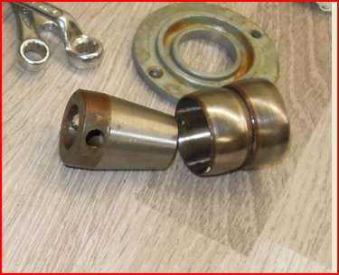

      The drive pulley on the motor of my mid 60’s Herbert B drill sits on a tapered sleeve, as you can see above. I want to make/find some larger pulleys so have measured (using gauging balls) the taper (total angle) to be 16 deg. 42mins., or 3.52″/ft.
      There may be some error in my measurement of course, but from the application and my approximation, can anyone deduce the actual taper spec this component is likely to be please?

          You did all the math and still missed it. It works out to a ratio if 0,300014. The accuracy is impressive.

              Nothing, except that whole numbers tends to be intentional. So it stands to reason that the taper is in fact 16°42′ or 3/10.

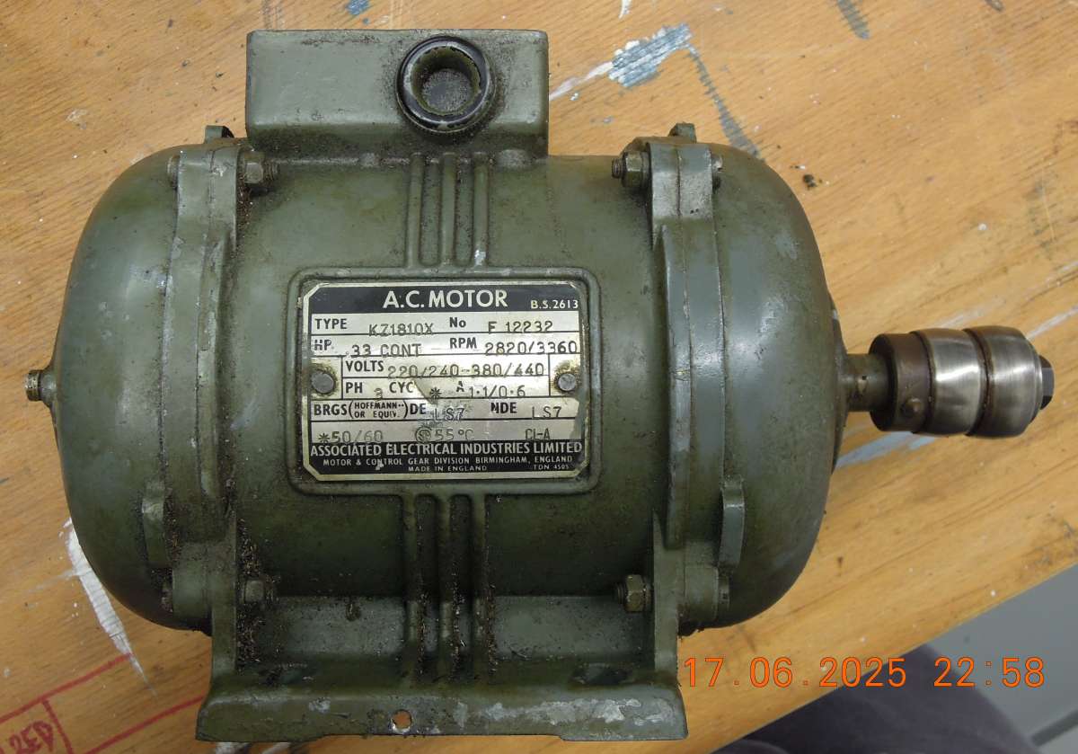

                    Questions:  How are you driving this motor? If 3 phase mains or converter, run it from a 220V VFD after setting the motor to delta configuration
                    A VFD should likely provide an adequate increase in drive speed.  Might even exceed the design limits of the drill?  I’m assuming, here, the motor spindle is running on ball bearings, not sleeve type.

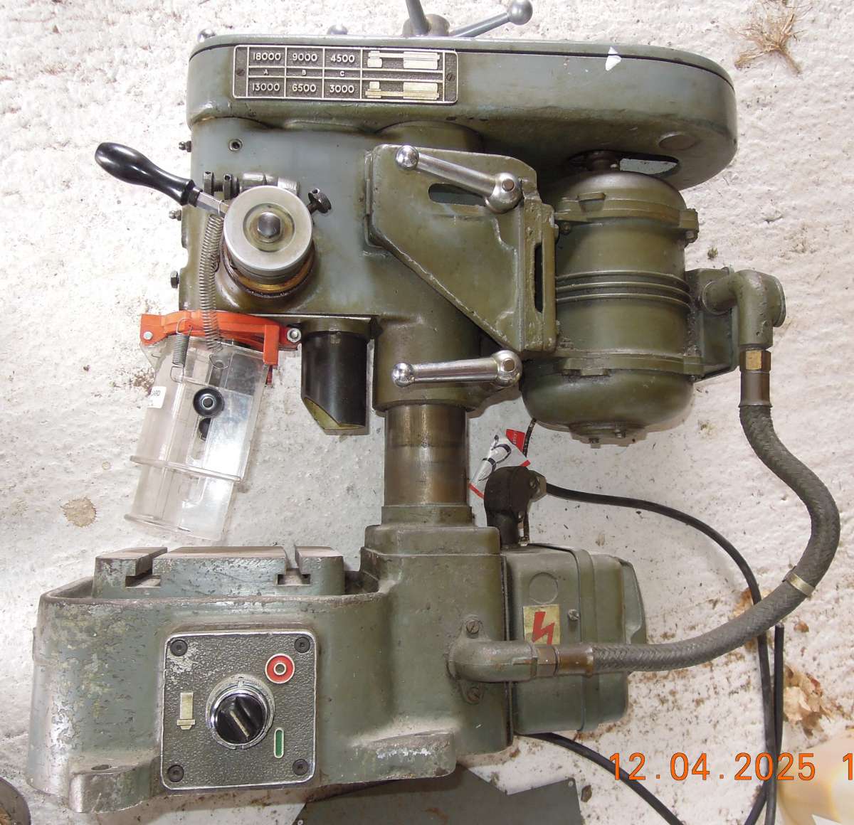

                      NDIY    I’ll be running it from a rotary converter. This drill is designed to run up to 18000RPM. It should come with a set of pulleys enabling this but unfortunately mine has only the smallest which will only give me approx. 2800RPM. As I already have a mill that can do 3600RPM I need to make a large pulley so I can get the benefits from this unit.
                      I intend to drill small holes in bearing rings for lubrication feed, so high speed will cut down the time spent doing this…but of course the real pleasure is just bringing and old machine back to a full life 🙂

                            Noel, I did wonder about doing as you suggest, it would certainly be an easy-to-do solution. But to run at 18k I think the taper fitting will best for minimising eccentricity and vibration in the driveline. I already have the AEI motor stripped and can see that its build quality is excellent for what appears to be just an ordinary 3ph industrial motor. When I see this sort of thing, I don’t like to compromise on other aspects, unless I really have to 🙂
                            Michael, thanks for the link on the drill overhaul. I hadn’t seen this one! Mine is similar to the green one so I will enjoy going through it later. Re the ‘herberttooling’ link, I had already been in contact with them. Sadly they informed me that they no longer sell any Herbert m/c tool parts, only general engineering components.

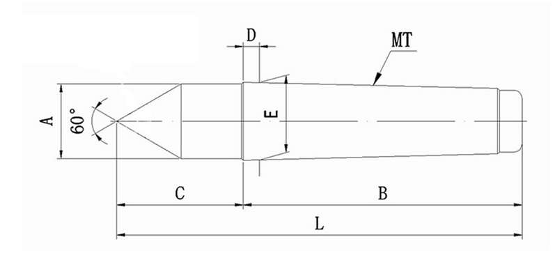

                                            mttaper
                                            That the drawing specifies a centre tip angle of 60° implies anything between 29 and 31° degrees will do.  It’s not critical.  Conversely, the taper is critical, and the necessary precision is in table defining A,B,C,D,E and L.

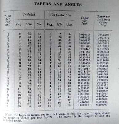

                                            This table from 1947 is useful:
                                            DSC06912
                                            Sorry about the blur, the taper per foot fractions are:   1/8, 3/16, 1/4, 5/16, 3/8, 7/16, 1/2, 9/16, 5/8, 11/16, 3/4, 13/16, 7/8, 15/16, 1, 1 1/4, 1 1/2, 1 3/4, 2, 2 1/2, 3, 3 1/2, 4, 4 1/2, 5 and 6
