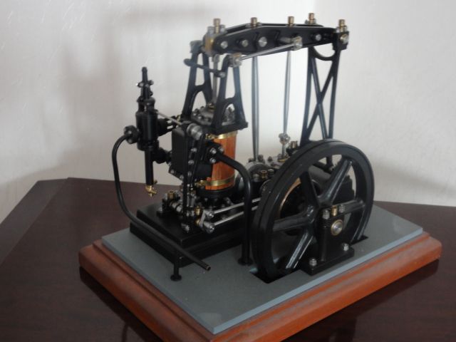

      I made Mogen Kildes double diagonal engine (ME4383) which is only my second engine and fitted a small air supply valve and a pressure gauge…see picture.
      The engine works great and only needs a couple of pounds of pressure to get it going and I thought to put a gauge after the air supply valve in order to give some indication of what the actual air pressure was.
      I was expecting that the pressure gauge might fluctuate a little but I think I will have to remove it due to the needle vibrating at an alarming rate and I don't think it will last long in its present situation.
      Is there any kind of a damper I could make? or will it have to be removed? Can anyone help…..thanks…Bob.

                      I had already made a stand to fix the gauge on and by sheer luck I made it a cylindrical pillar, it seemed obvious to coil the small pipe around it as many turns as I could, 1/2 an hour later and I tried again…. the indicator needle was now steady… pics below..
                      Many thanks great people….Bob.

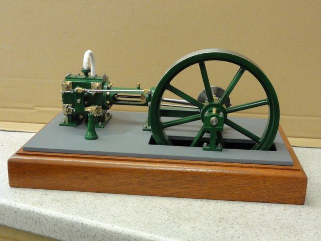

                                  If you want something fairly quick there is always Jason's Jowitt engine, the complications being the shape of the cylinder block and the need to make the poppet valves and the spoked flywheels.
