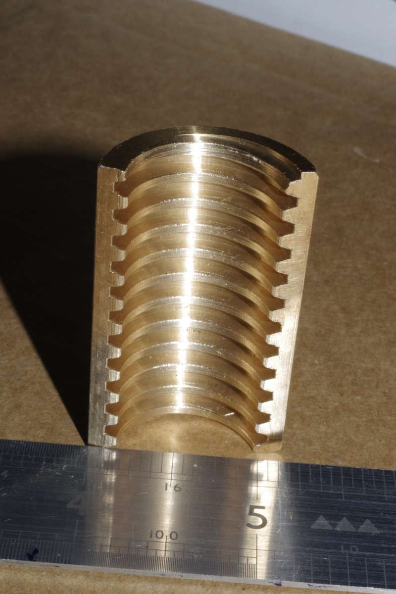

            Hi Miles I from time to time make leadscrew nuts for the M type lathe And they are the same square  thread as your lathe. The M type has only one side threaded and a blank top piece which stops the leadscrew lifting up away from the bottom threaded half. I have a jig to hold the threaded half and a boring bar which fits between the chuck and a tailstock centre and just traverse the saddle over bit by bit till the  thread is correct depth.
            20230818_154647 2
            23 finnished thread
            20230309_144745
            The boring bar Has a cutting piece which is the correct width of the thread and correct depth plus a few thou for clearance on outside diameter of leadscrew. the thread is correct depth when the core diameter touches the nut as it is the same diameter as  core diameter of the nut.
            I have the drawings of half nuts and tools I use for the M Type lathe I think you could use a similar item but you would have to move one half along to allow for  the pitch difference as it rotates around.
            Message me if you want any further info.
            David

                  I have screwcut 8tpi square thread halfnuts with no need for a die to finish it off with. The joy of square threads vs Acme or BSW etc is there is no angle to mate up between male and female .
                  So you grind the cutting tool to exactly the width you want the groove in the thread to be. IE say nominal plus one thou for clearance. For 8tpi grind it, and finish with an oilstone   to about .063″ . Then make your depth of cut a few thou deeper. Extra clearance on the oD makes no problem at all. It is a non contact surface. Likewise bore the hole to start with a few thou oversize for clearance.
                  I cut my thread like this in a bobbin -shaped piece of brass then split it lengthways with a hacksaw, cleaned it up with a file, dropped it on the leadscrew of the lathe used to cut it, and perfect fit. With a square thread it can’t be otherwise if you machine to the dimensions as described. I never trial fitted the nut on the leadscrew before hacksawing it in half and all was well.
