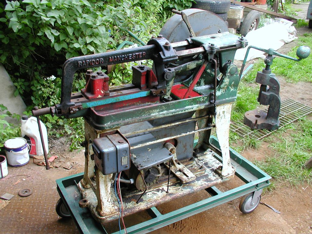

                                          Nicholas Farr
                                            @nicholasfarr14254
                                            Hi, my Rapidor cuts on the forward stroke and relieves on the return stroke, just as described in this advert,
                                            Rapidor Power Saw 1
                                            Rodney, nice looking saw, but unusual to see the blade on the left hand side of the vice.
