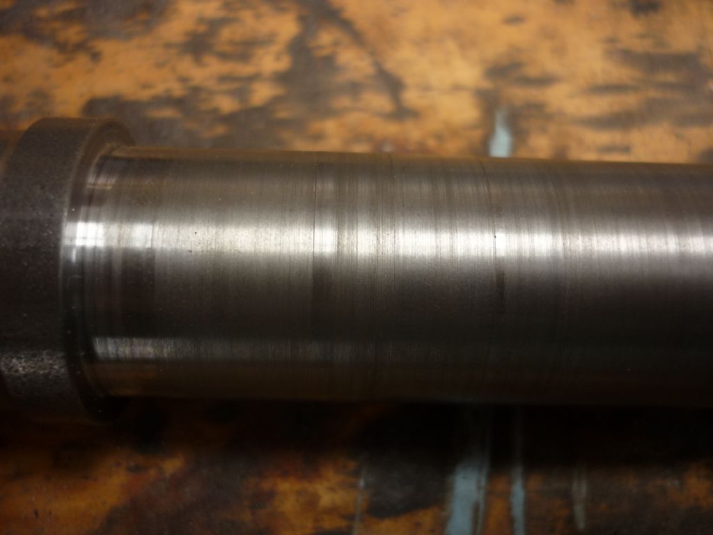

      Hi everyone,
      I found your forum looking for answers to questions about a Colchester Master lathe that I recently bought.
      I am a lathe novice so I hope you might bear with me if I ask silly questions.
      I've read a bit about taking trial cuts to establish the alignment of the lathe but my first problem is that when I take a cut the surface is terrible! A series of grooves and lumps (mild steel).
      I have tried all the following without much joy:
      1. Different chuck speeds.
      2 Different feed rates.
      3.Cross slide and top slide locked.
      Any pointers for what to try would be very welcome.

          Main priority – correct shape tool for material – sharp cutting edge – tool set to the correct height.
          Chuck speed will vary depending on diam. of work so sugest start slow speed an then increase untill good cuts are produced – try using cutting oil (spray can type)

            Some questions:
            What tooling are you using HSS or Carbide?
            Is your tool on the workpiece centreline
            and are you certain its Mild steel as it sounds like it's tearing?

                        All the above plus you say your material is "Mild Steel" – but where did you source this mild steel and what size piece are you working on? If it's a bit of what looks like MS but is in fact a bit you picked up somewhere then it could be hard and that will give you problems, Your Colchester is a far more rigid machine than many here posess and should be able to perform well.

                              1. It is a triangular style carbide tool that came with a 'cheap' set to get me started. I did also try another triangular carbide tool that a chap gave me at work. It had come from a real machine shop and had a much bigger radius but the results were much the same.
                              2. I'm pretty sure it is 1" free machining mild steel. I bought it from the steel supplier as such.
                              3. I have tried a spray-on oil that is actually for thread tapping. It is quite thick and actually seemed to make the cut worse.
                              4. I set the tool height by eye using a centre in the tale stock.

                                I think your main problem is the cheap carbide tool.
                                I got a set with my lathe and threw them down the garden.
                                they are generally rubbish, get a high speed steel cutter and see the difference.

                                  Pretty sure the lathe is not in reverse. Anti-clockwise viewed into the chuck and the work advancing down onto the tool.
                                  A friend at work who has done a lot of turning keeps saying that something must be loose. I have taken various measurements, chuck, toolpost etc but I don't really know what a 'good' number is for any of it.

                                    Should be no perceptible shake at the spindle/chuck.
                                    Could be the headstock spindle bearings need adjusting – something that requires a handbook/manual to be done properly.
                                    If perceptible shake on the toolpost or cross slide, you might be able to adjust the gib strips – small strips of metal that fit against the ways and can be adjusted with three little grub screws on many lathes.
                                    Best to get hold of a handbook/manaul first though and have a good read until you understand how it all works. See the page on http://www.lathes.co.uk on your lathe. It has a link at the bottom to a manual you can purchase.
                                    http://www.lathes.co.uk/colchester/page17.html
                                    But first thing is to get a good tool in place, quality carbide, new, or correctly ground High Speed Steel finished off on an oilstone and set at centre height with minimum overhang. (see those two books I recommended.)
                                    Some pics of your set up would help.
                                    And what model/year of Master is it?

                                      It's a Master 2500, 1970s. I have the manual that comes with the lathe. It's mostly exploded drawings and part numbers but there are some operating and setting-up instructions.
                                      Not really any perceptible shake when it's running, maybe a bit at higher speeds.

                                        While possible I think it unlikely that the problem is due to headstock bearings or anything else that is loose. I did have an issue on my lathe (Harrison M300) where one of the bolts holding the cross slide down had sheared, but this resulted in a barely perceptible spiral pattern not a torn finish.
                                        I would suspect that the problem is down to tooling and/or material. I'll second the advice to throw away the cheap insert tooling. If you want to use insert tooling buy quality holders and inserts. Youve got a decent lathe with some horsepower behind it, so run insert tooling fast, the chips should be coming off blue. For steel a decent depth of cut helps too, at least 1mm. It's no good pussyfooting around with insert tooling when turning steel! See here for some results on turning:
                                        **LINK**
                                        Try steel from a different source. I've had poor quality steel from commercial suppliers that was impossible to get a good finish on.

                                          I live just north of Christchurch, New Zealand. I'll try getting some better tooling. Do you think I need to change the holder or could In just get some good inserts?
                                          The last trial cut I did started with a really nice smooth shiny finish… for the first 3mm or so and then it all went to hell for the rest.
                                          If insert tooling is good for taking heavy cuts, what would you recommend for taking fine cuts when getting close to a dimension?

                                            That sudden change sounds suspiciously like a chipped tool. Take a close look under a lens.
                                            I had a similar problem with a tiny inserted tool boring bar (3/16" shaft!) that wouldn't give a decent finish. It wasn't until I rotated the insert and got a good result that I was convinced the old corner was damaged at all!

                                              you ask what tooling to use for fine cuts, I would say a sharp HSS tool. I have a small tangential toolholder I use. You can make your own or buy one, it is easy to sharpen the toolbit. This has been discussed on this forum before ***LINK***, another ***LINK***.

                                                A good finish that turns (oops, there's a pun) bad is exactly what I experienced using poor grade steel.
                                                Some metals, like aluminium and free cutting stainless, produce good finishes with carbide tooling, even at small depths of cut. This doesn't seem to be the case for low carbon steels. However, the finish is not badly degraded with depths of cut in the order of 0.25-0.5mm. I would regard anything up to about 1mm depth of cut as a finishing cut. Roughing cuts are up to 6mm, depending on the material.
                                                If I put on a depth of cut of 0.5mm I expect the lathe to take 1mm off the diameter, so I try not to sneak up on dimensions.
                                                      Here's a picture of my work so far.
                                                      Thanks for all the replies folks. Please bear with me while I work through these and another excellent list of things to try that I got from Tony at the http://www.lathes.co.uk site : a very helpful chap. I have a wife and teenage daughters so I don't get to spend as much time in the workshop as I would like, that and a host of other projects…
