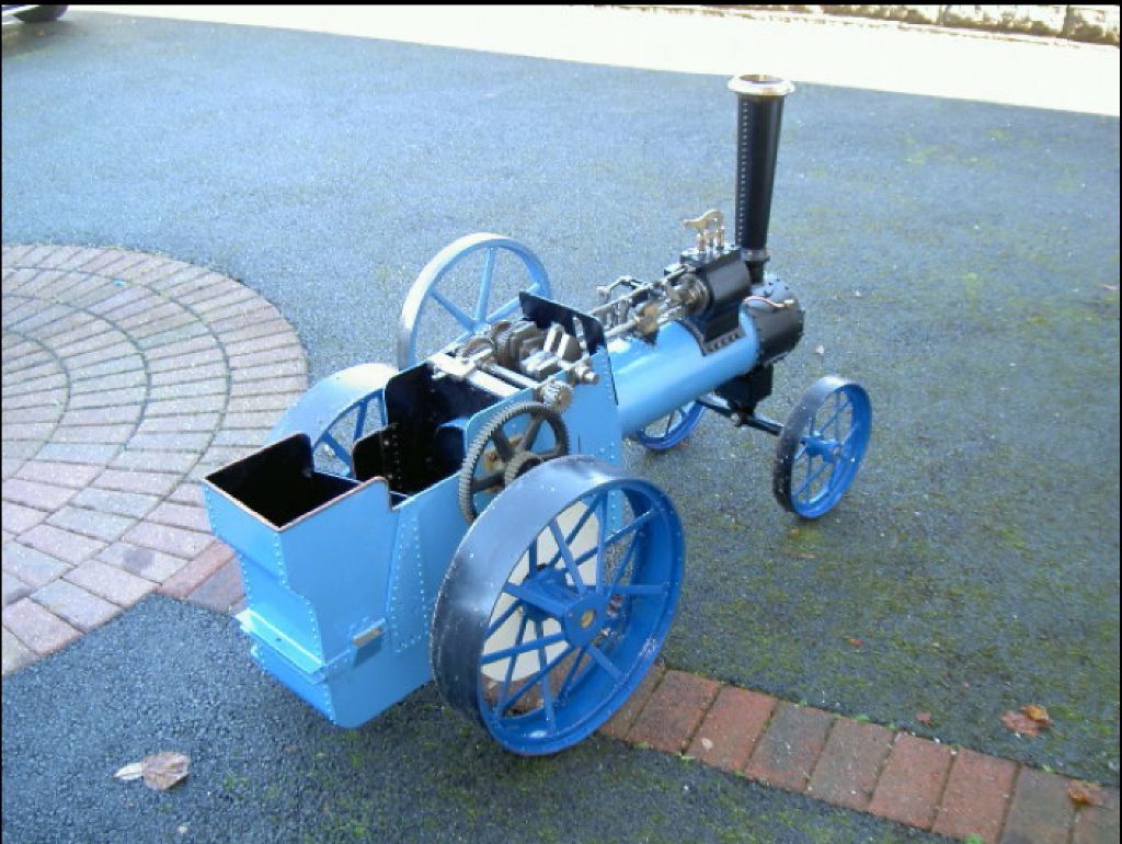

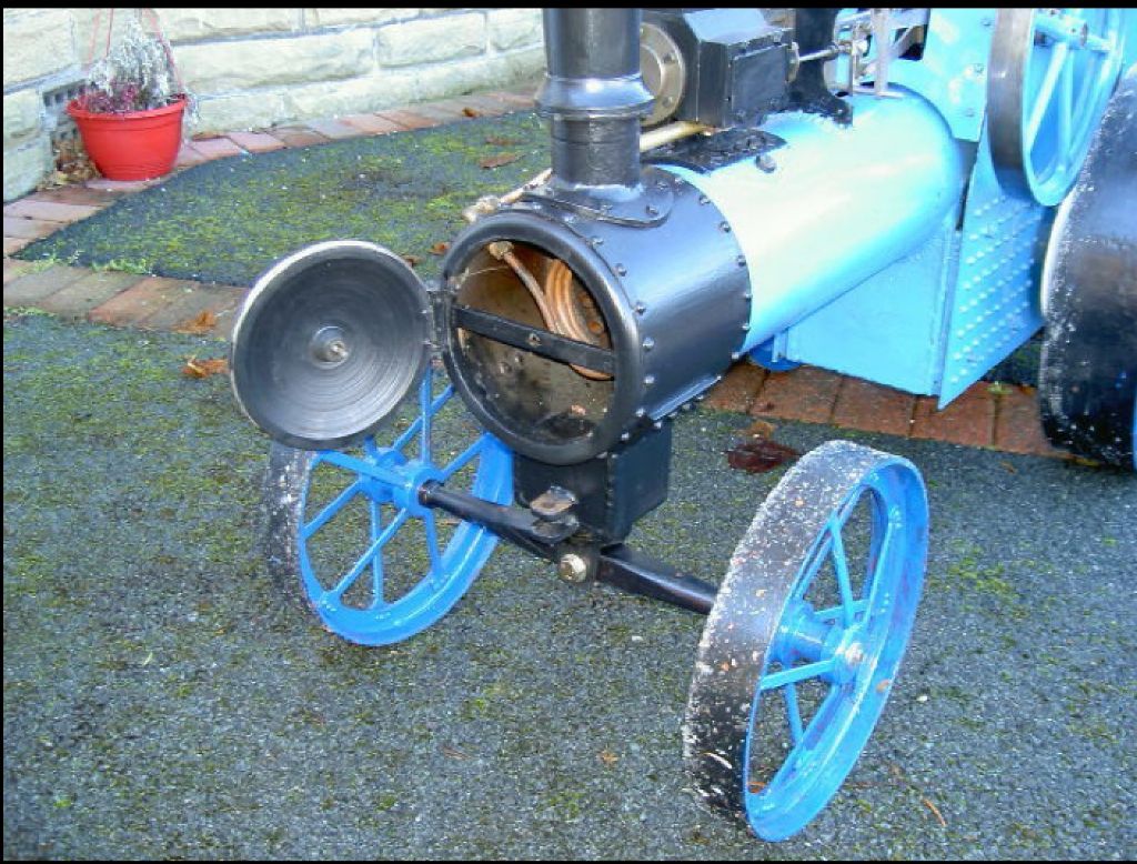

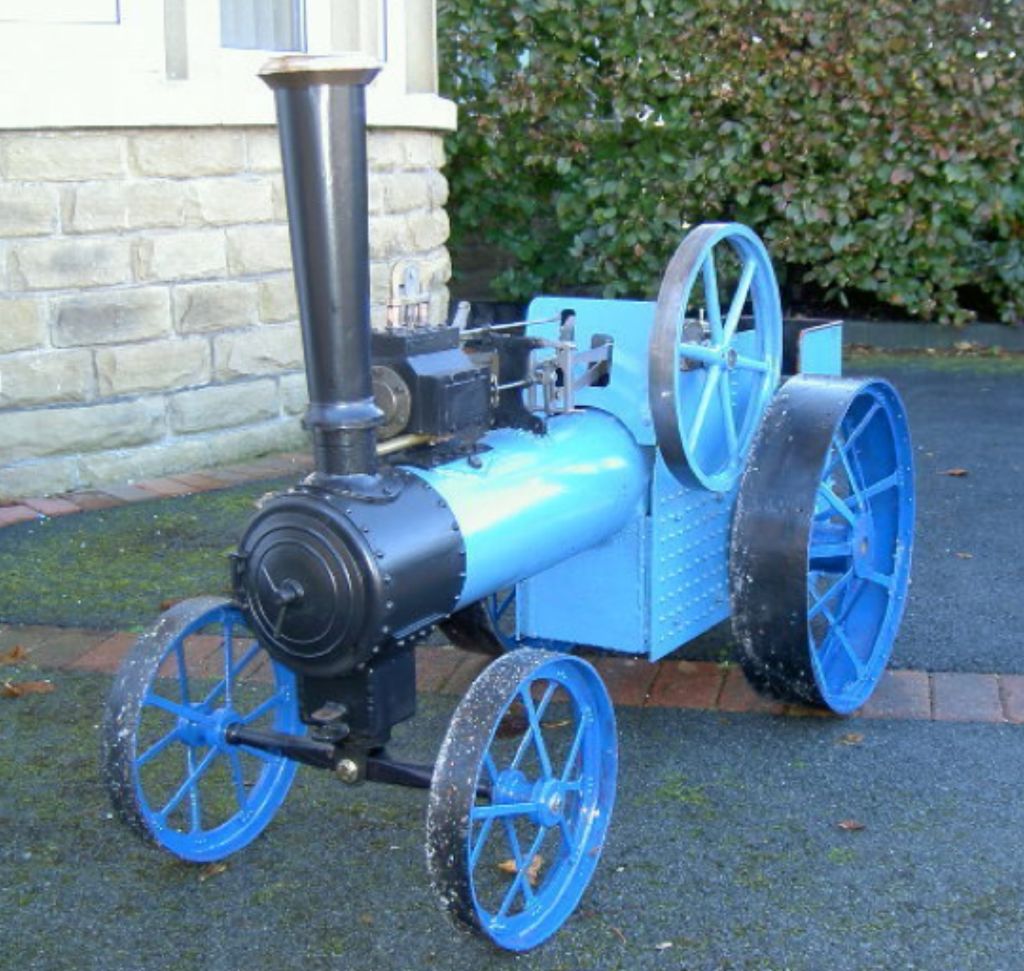

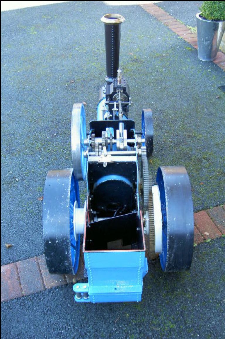

        Hi I'm trying to find drawings to finish this model, it's 3" ish but I have no idea what it is! Hope someone can help.
        Any help would be much appreciated. Thanks

                          These are the photos of Ashley's engine. To me it looks like a freelance with a hint of Minnie about it. It may just be the photo but I can't see any provision on the back of the boiler for water and pressure gauges. Also no means of getting more water into the boiler!!
                          Ashley, please don't put a fire into this engine until you have had it looked over by someone who knows about steam and preferably a club boiler inspector. At the very least it will want a hydralic test to twice working pressure and all the missing bits I mentioned above adding. Even then the axles look very spindly and I think it will be very low geared.
