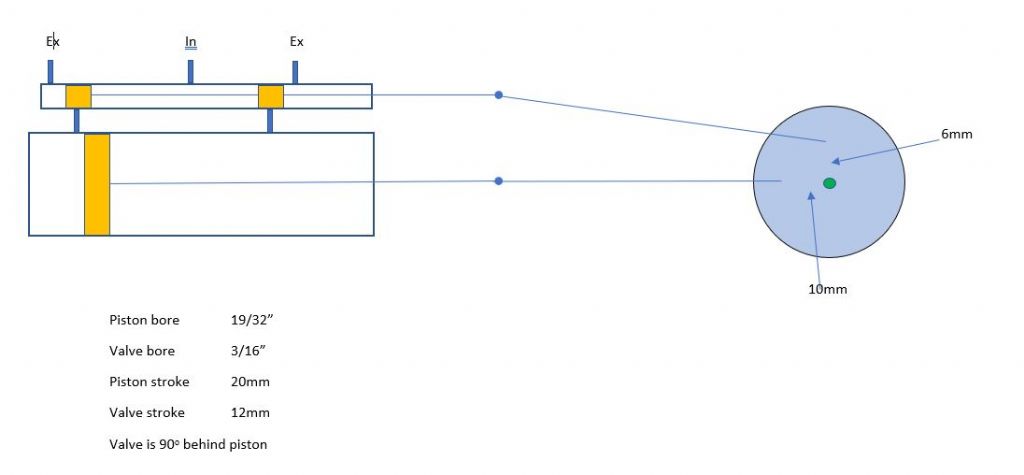

                        Resurrecting a old thread of mine: I have been working on other things, but now am thinking about this engine again.
                        I have sketched out the attached plan, taking the dimensions and general layout from information on the internet. Whether they are good or not is another matter.
                        Have I understood it correctly that if I simply use a reversing valve to put steam in the pipes currently labelled "Ex", using the current "In" as the exhaust, the engine will run in reverse? The plan is to make this a twin cylinder, so it should be self-starting.

                          HI JAMES, A little late on the scene But for what its worthI have been constructing J P Bertinant's "Marcher" twin marine steam , engine Now the drwgs &casting set ( Messers Reeve' s Birmingham ) Come compleate with castings for either piston or slide valve operation inc castings for the reverser block (available seperatly) I opted for the piston valve as somewhat simpler inc the reverser block when using this set up engineis known as inside outside admission !!! confused you should be !! Regards PAUL S
