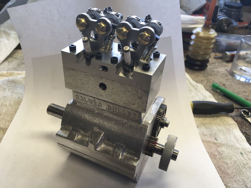

      i have a small, 3/4” by 3/4” two cylinder engine I’ve built. It slobbers oil from the exhaust. It actually run pretty well inspite of that.
      Currently the piston clearance is .004”. It’s an aluminum piston in a cast iron liner. I wonder what is the tightest fitting piston that will work without seizing when the engine heats up? Comments please. Done all I can regarding rings with 4 rings and oil drain holes in lower ring groove. Had very high compression with domed pistons but flat topping them and lowering compression didn’t help the oiling problem and dosent idle quite as well.
      The engine is Bob Shores Silver Bullet but modified to 180 crank, hemi heads with Harley knuckle head type rocker arms.
      Thanks, John

                        #439515
                        John Vietti
                          @johnvietti39406
                          I have added a picture of the Silver Bullet. I ran it in for a couple hours and the oiling problem is improved.546ca418-ed93-46af-bc9a-ae89b57e33b2.jpeg

                            #439585
                            Jon Lawes
                              @jonlawes51698
                              What a lovely little engine. Top work.
