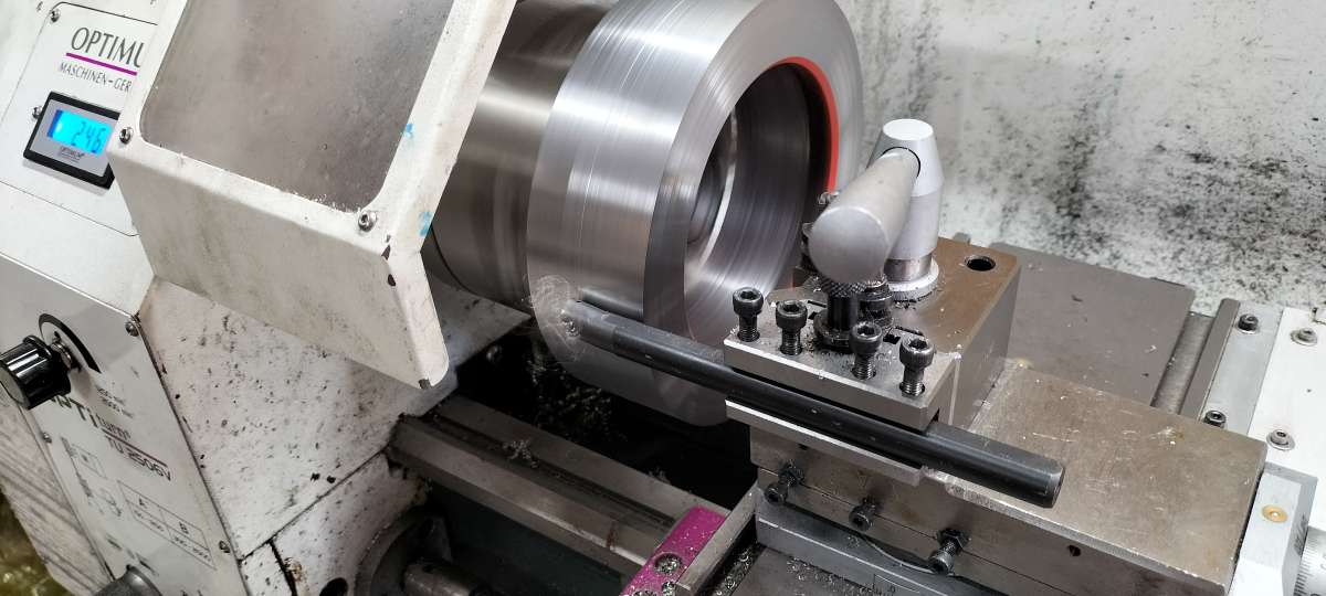

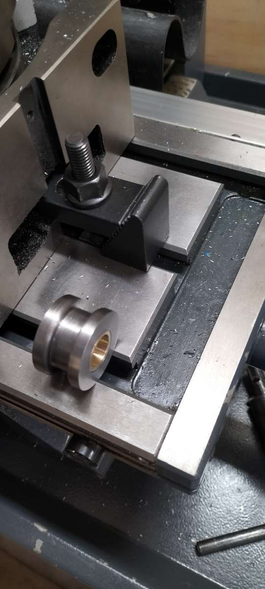

      My Grandfather served in WW1 with the 54th Australian Siege Brigade, which used 8 inch Howitzers. I visited the Australian War Memorial in the hope of seeing one of these monsters, but they only had the 9.2 inch Howitzer. Further research found there was not many around, so I decided to have a go a building one, on a 11:1 scale.

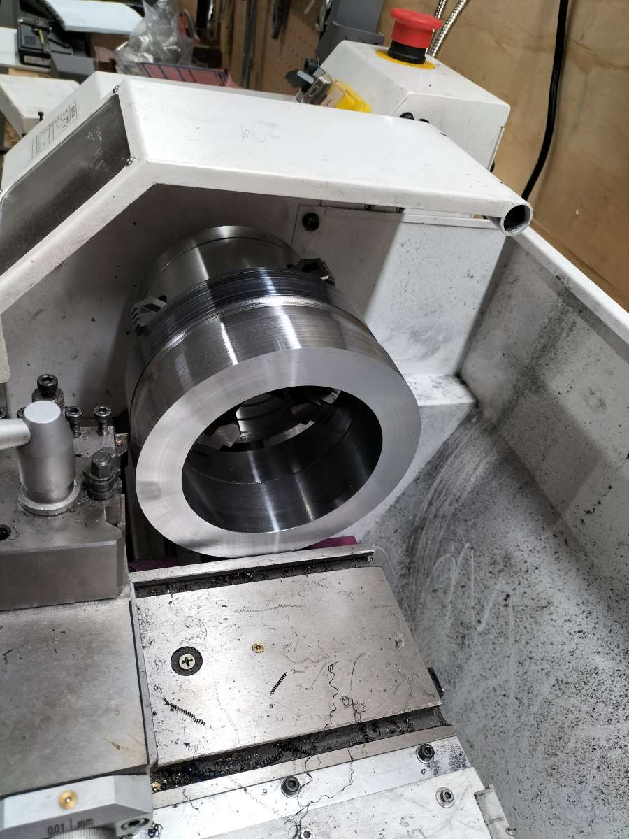

      I hadn’t done any machining for about 35 years, so I had to dust off a few brain cells

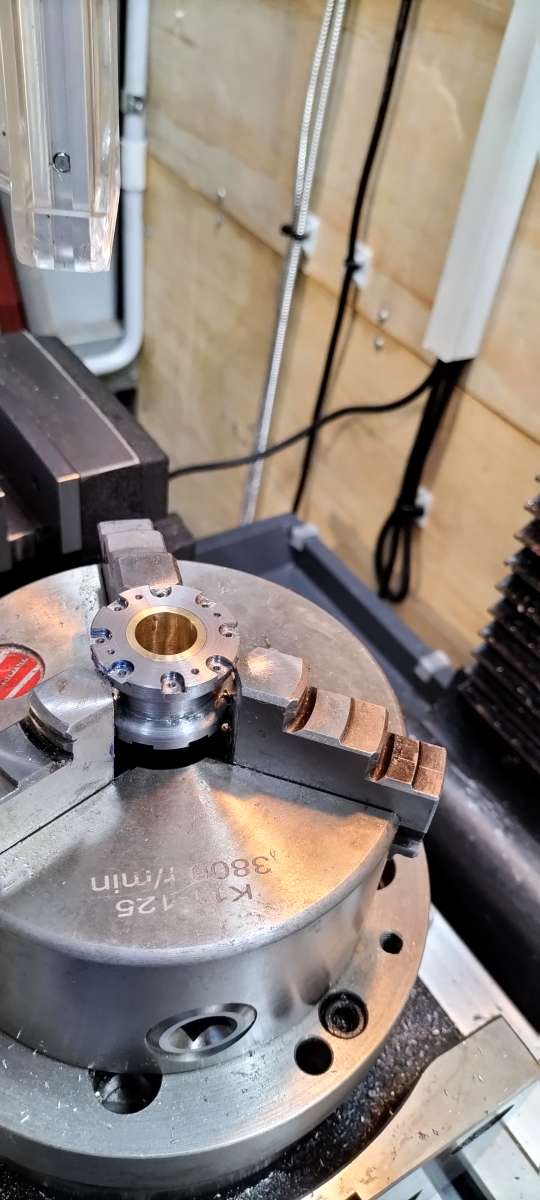

      I decided first to tackle the wheels. The size was right on the upper limits of my Lathe, which meant I had to invert my boring bar, & run the machine in reversed get the finished OD
      IMG20230507173015IMG20231124074648

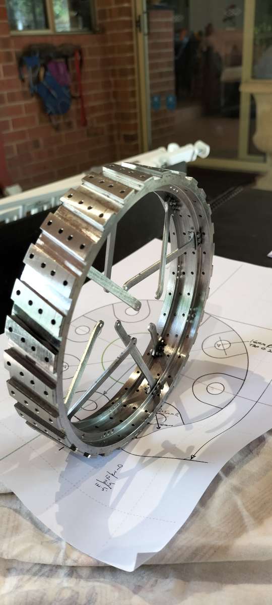

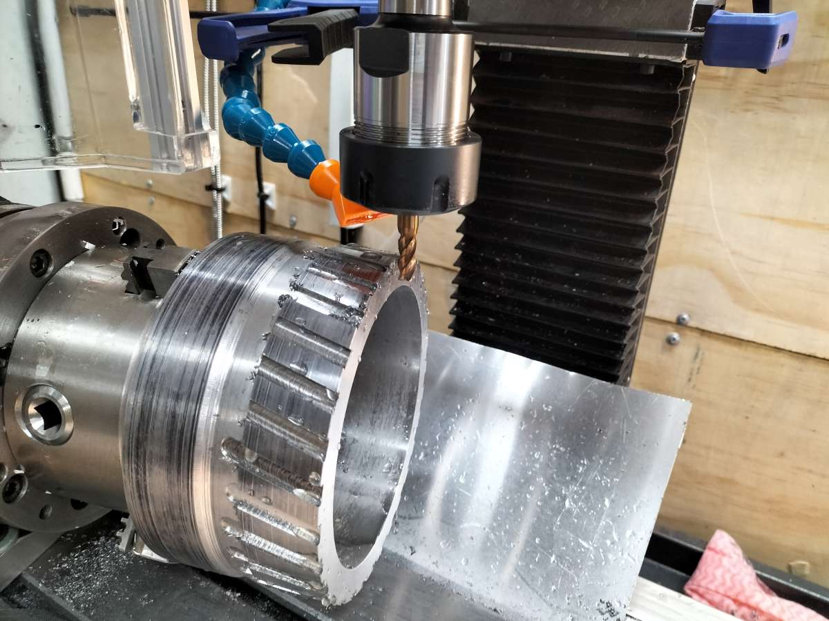

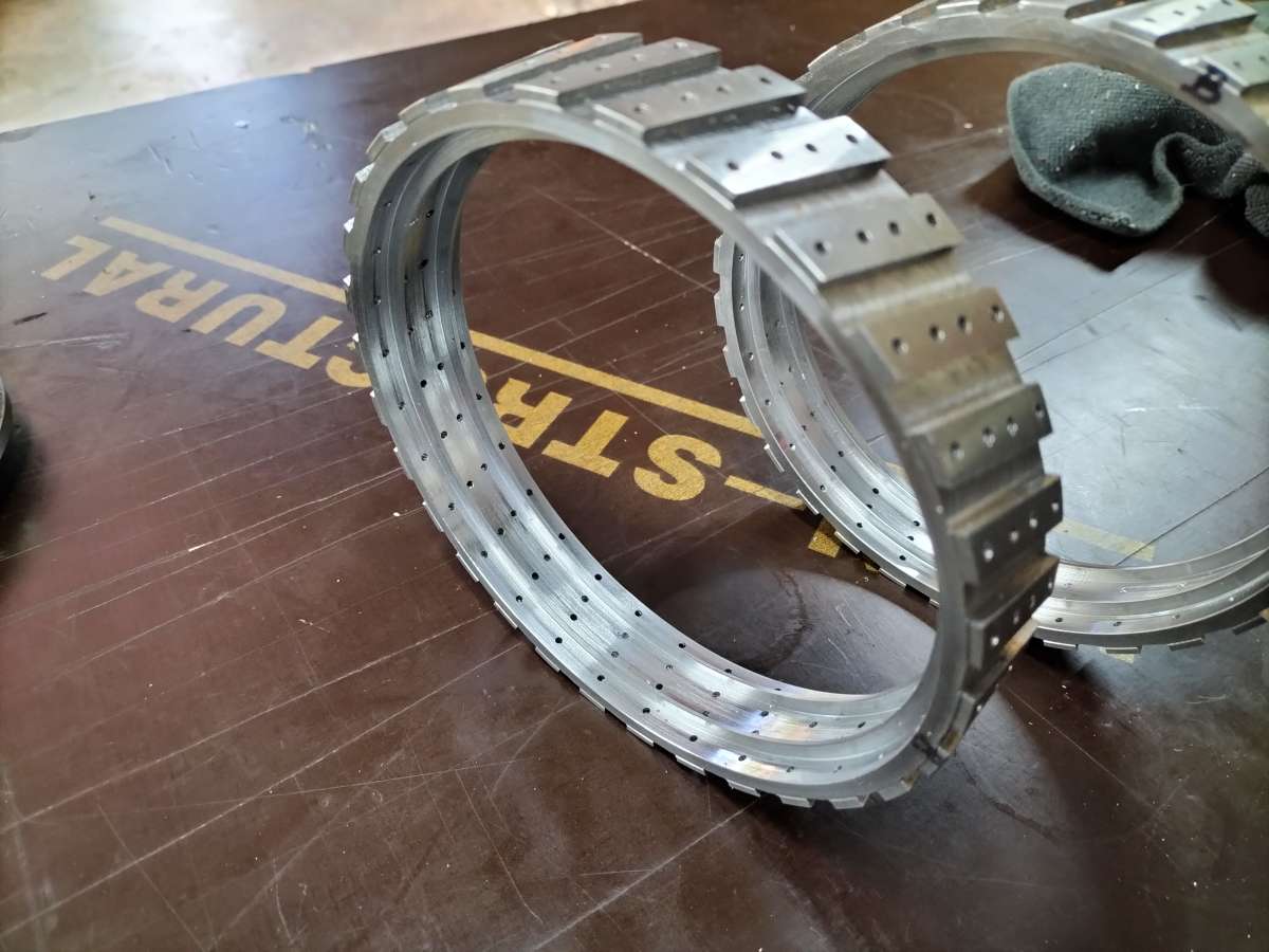

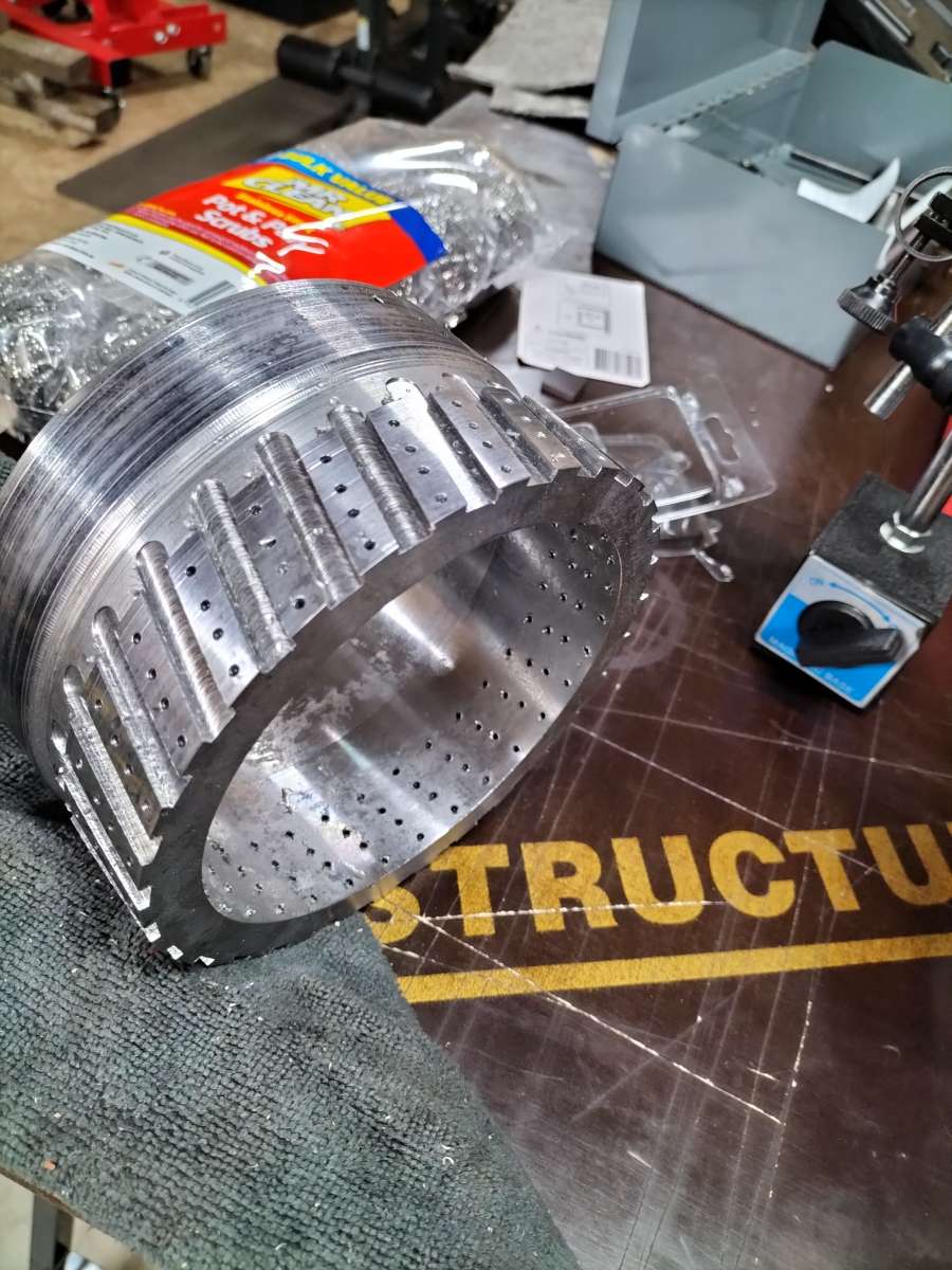

        Next was to cut the strakes, & drill the holes for the rivets.

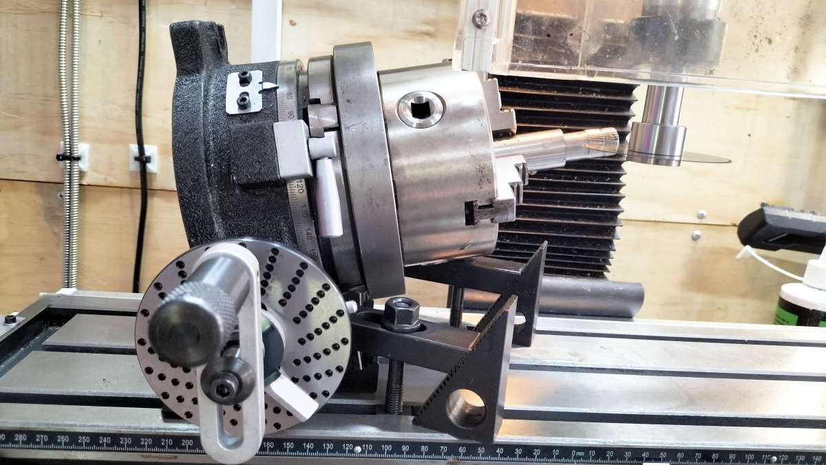

        I got the angle cut on the strakes by setting the indexing head at an angle
        Then it was back in the lathe to finish off the inside of the wheels
        IMG20230519145652IMG20230519175235IMG20230628151813

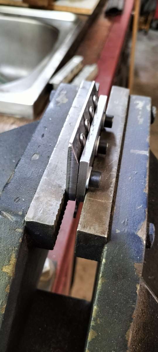

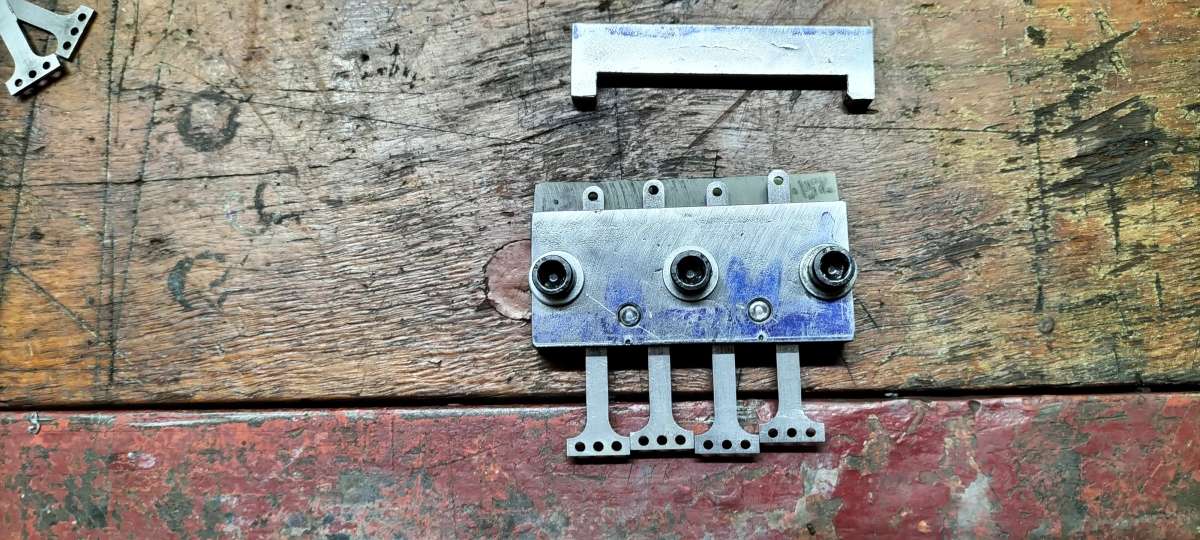

            The angles on the ends of the spokes needed to be bent the same for each spoke, otherwise the center hub may not line up, so I made a bending jig

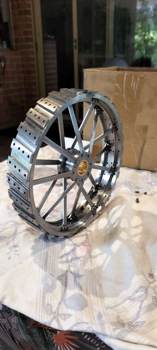

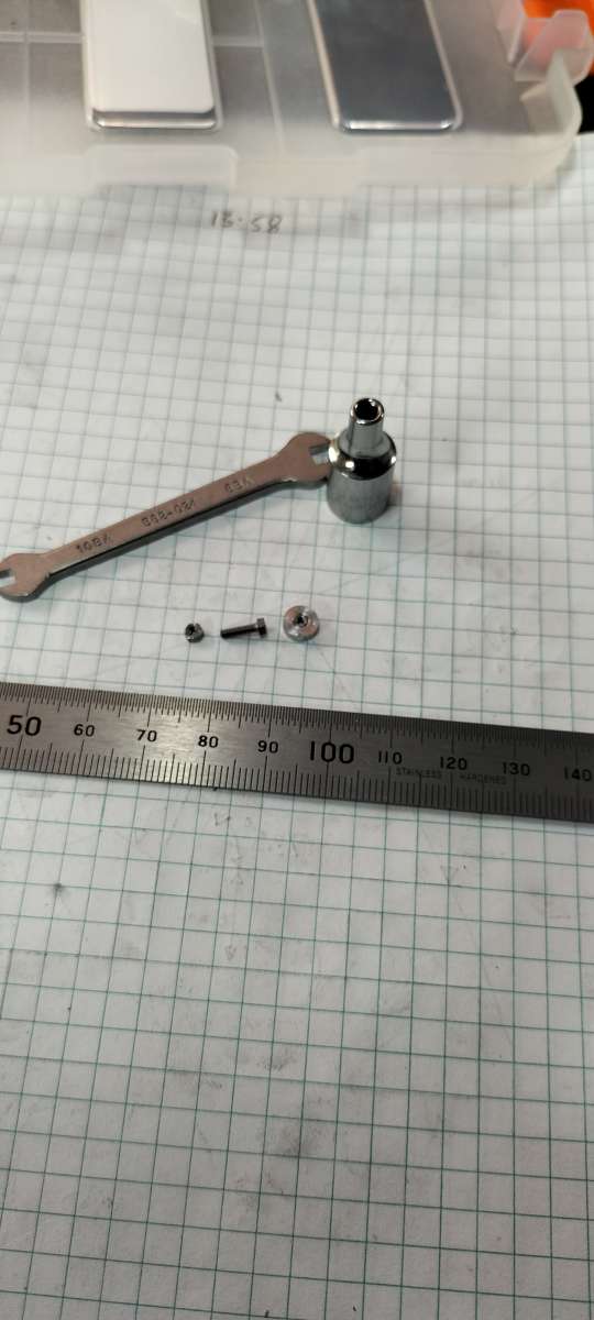

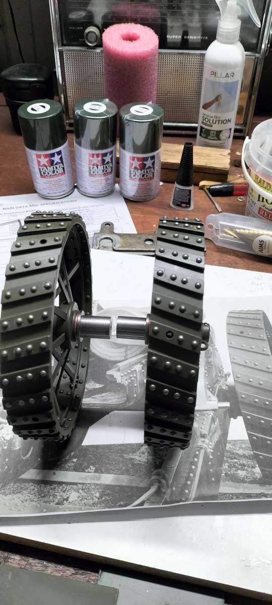

                      Next job was to make the hub, & drill & tap the holes for the bolts to hold the spokes. The bolts used throughout the project are 10BA, which are about 1.7mm diameter, so had to be very gentle when tapping
                      IMG20231105162127  IMG20231107142600  IMG20231106172636

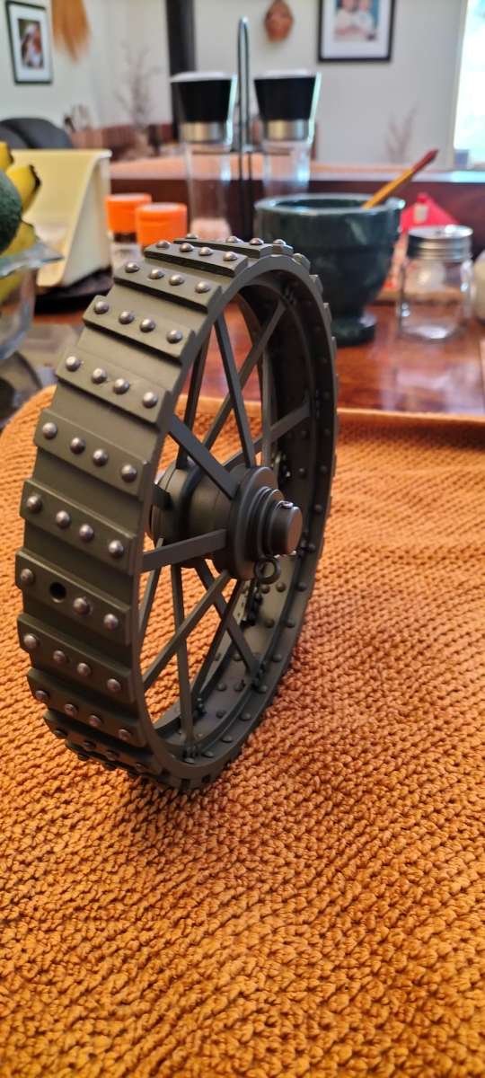

                      Then came the fiddly bit, bolting on the spokes. Getting the nuts onto the bolts was a combination of fat fingers & tweezers. Finished off by tapping in all the rivets, & making the stub axles, bearing cap & retaining pin. I decided to paint the wheels & other components as I went along. As this was going to be a long project, it will help keep the rust at bay
                      IMG20231109153516  IMG20231122141238  IMG20231128171433

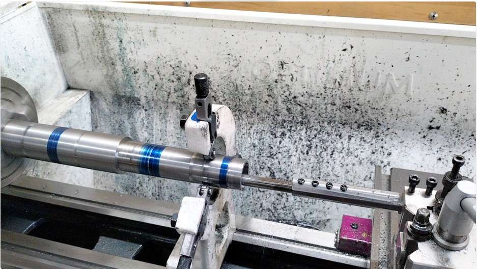

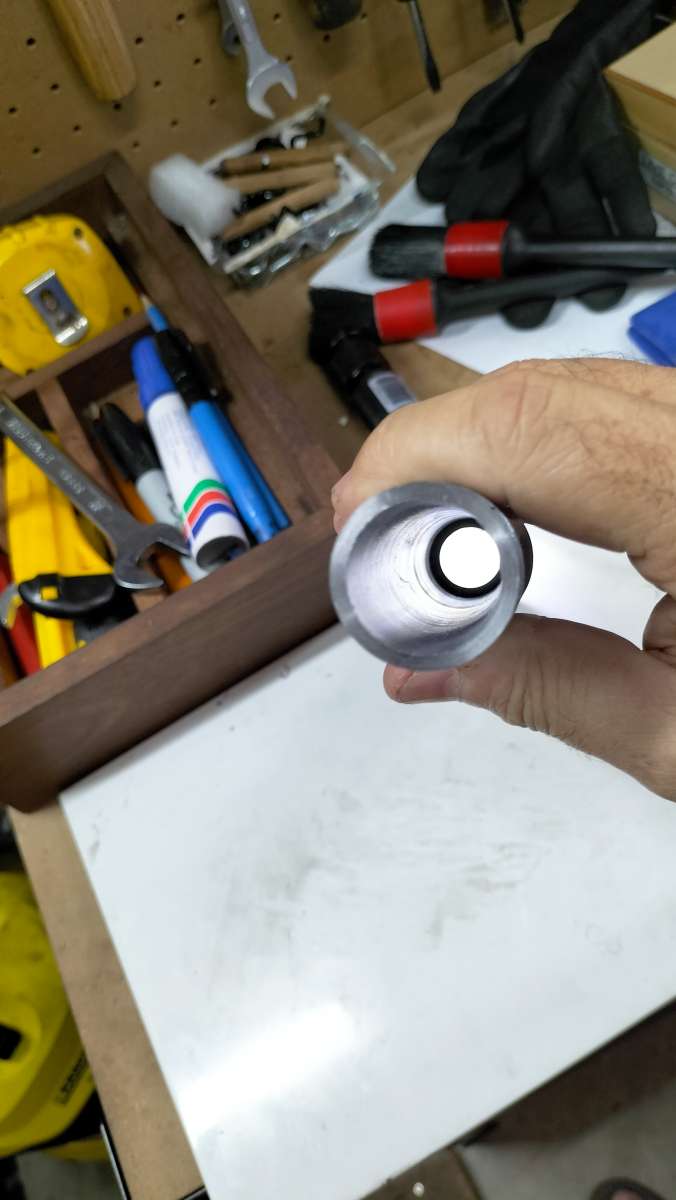

                          Next was to do the barrel, the depth of the bore exceeded the length of my boring bar. I invested in a anti vibration boring bar, which worked a treat. I also made an extension/holder for the boring bar. I also modified my lathe steady by replacing the brass fingers with roller bearings.
                          I bored it oversize to allow the fitting of sleeve, as per the original, however I was fitting the sleeve from the front, not the rear like the original
                          Boring bar extIMG20240107085135IMG20240128075010

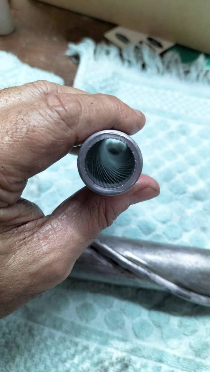

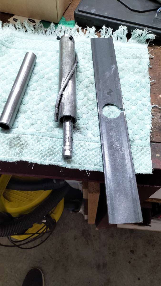

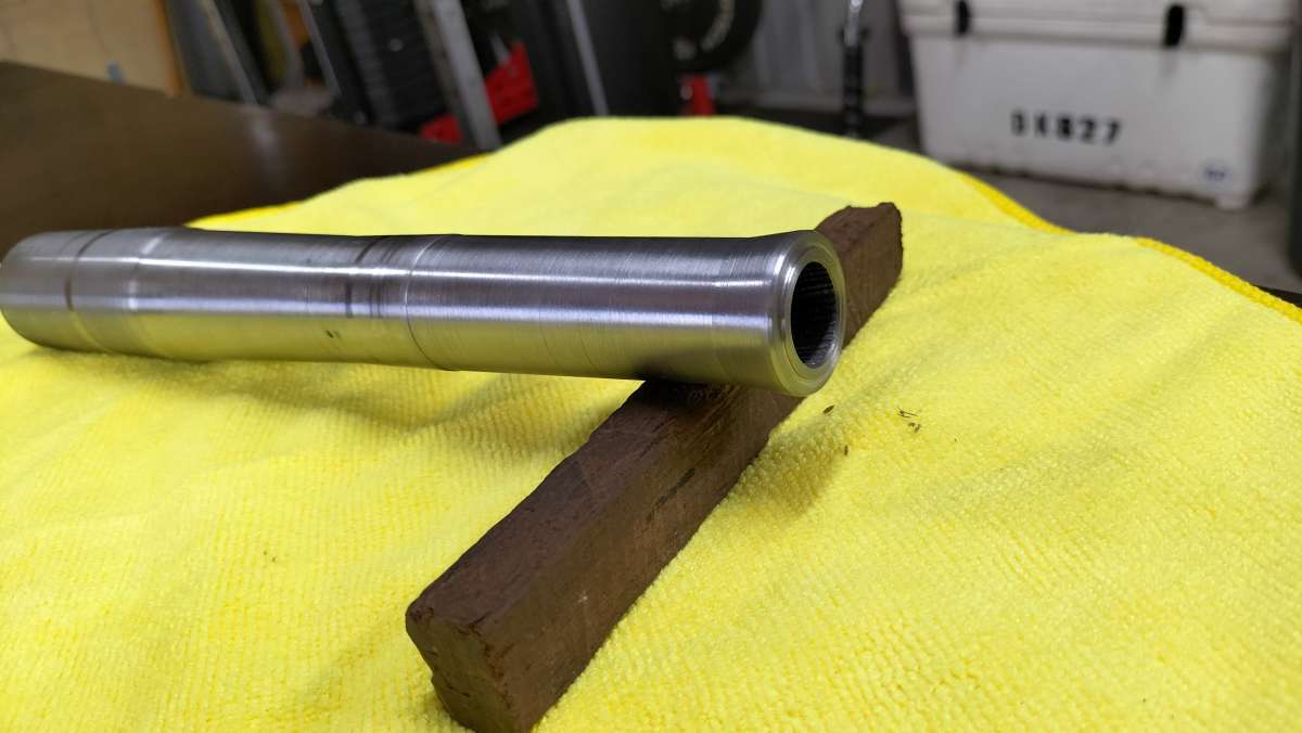

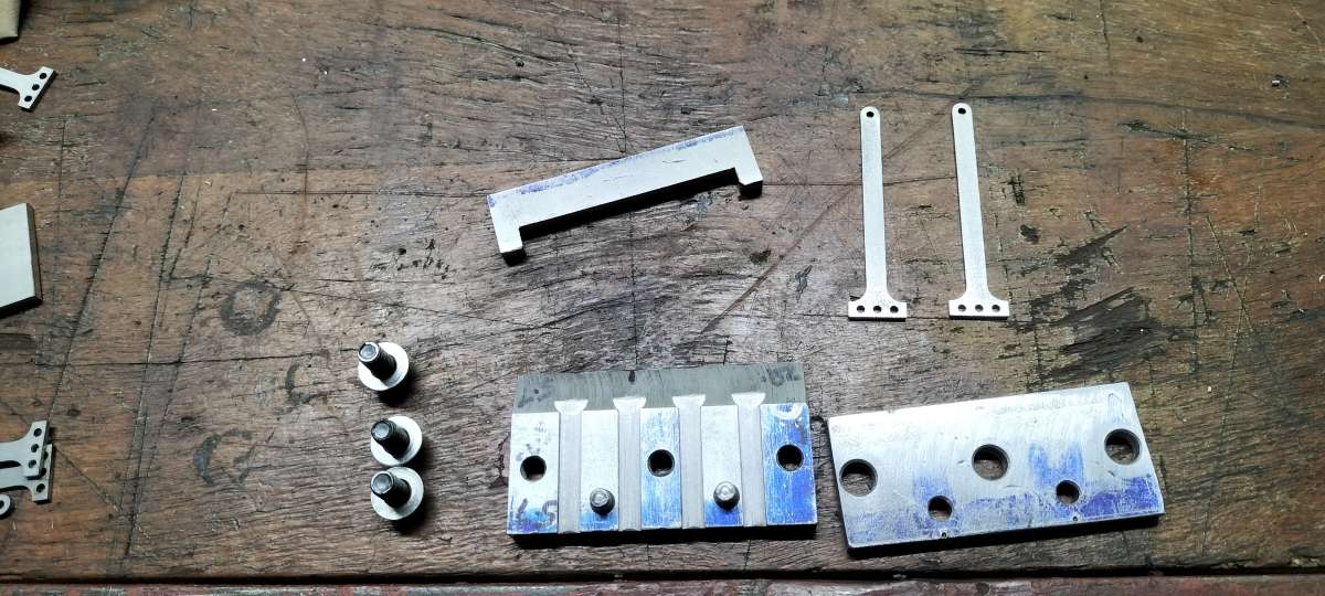

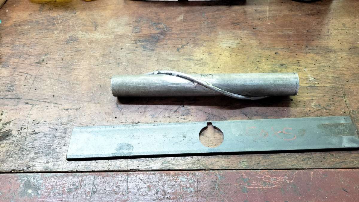

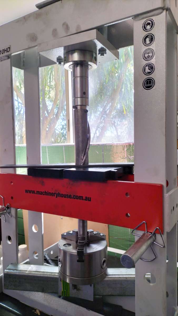

                            After making the sleeve, I decided to have a crack at rifling the bore. This took quite a bit of reseach & I finally decided on a method which I thought would work. The twist rate is 1 in 15 calibres, so I welded a small bit of round bar to a pipe at that twist rate, the got a piece of flat bar with a notched hole, so the round bar runs in it

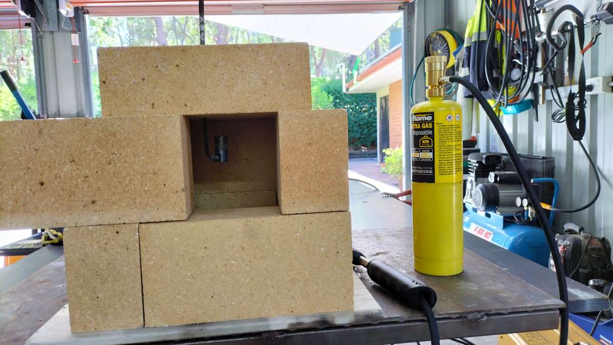

                            Next I made the cutting tool out of silver steel, so I coud harden it, I raised the front of the rotary table to give the correct angle to follow the twist rate, & used a 1mm slitting saw
                            I built a little temporary oven to heat treat the tool
                            Then used a press to cut the rifling
                            IMG20240125161658  IMG20240125161331 IMG20240125161737
                            The finished product turned out pretty good/

                              Screenshot 2026-02-14 at 08-54-05 Peters Vickers Bl 8 inch Howitzer cannon of 1917 scale 11 1 Model Engineer & Workshop Magazine
                              Top marks for attention to detail.  I’ve seen a Vickers made model that only created the illusion of rifling – straight grooves at the muzzle about an inch deep.
                              Breakfast treat – thanks for sharing!

                                  Your rifling method looks to have turned out well and is quite convincing. Well done and very clever Peter. 👍

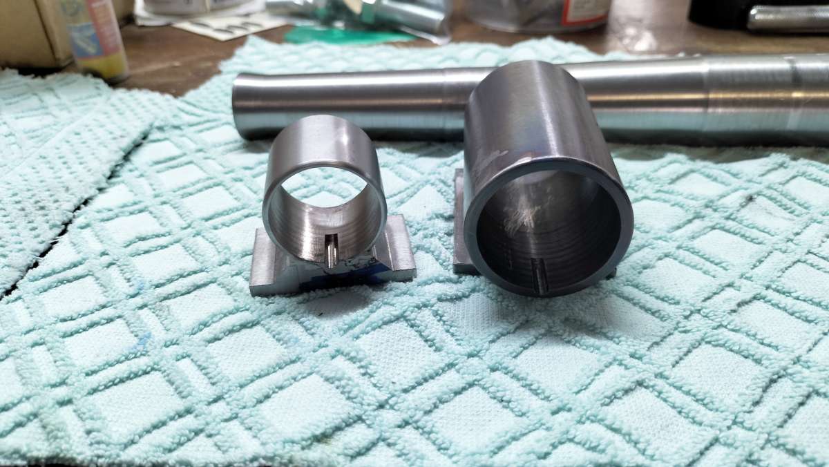

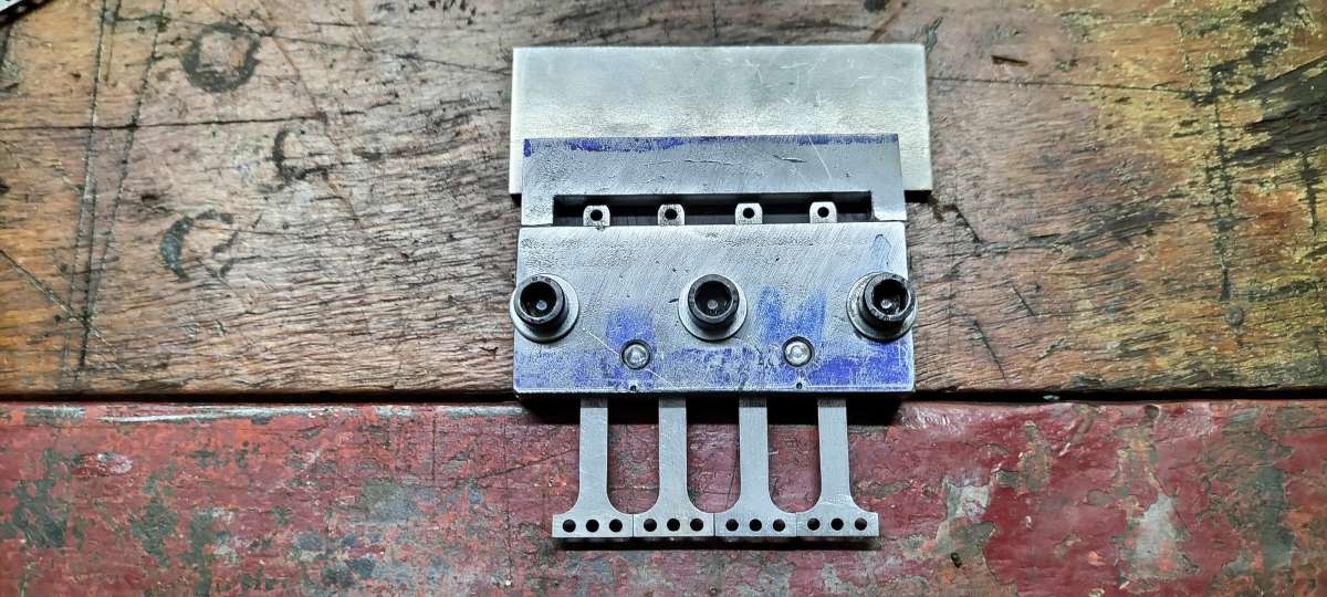

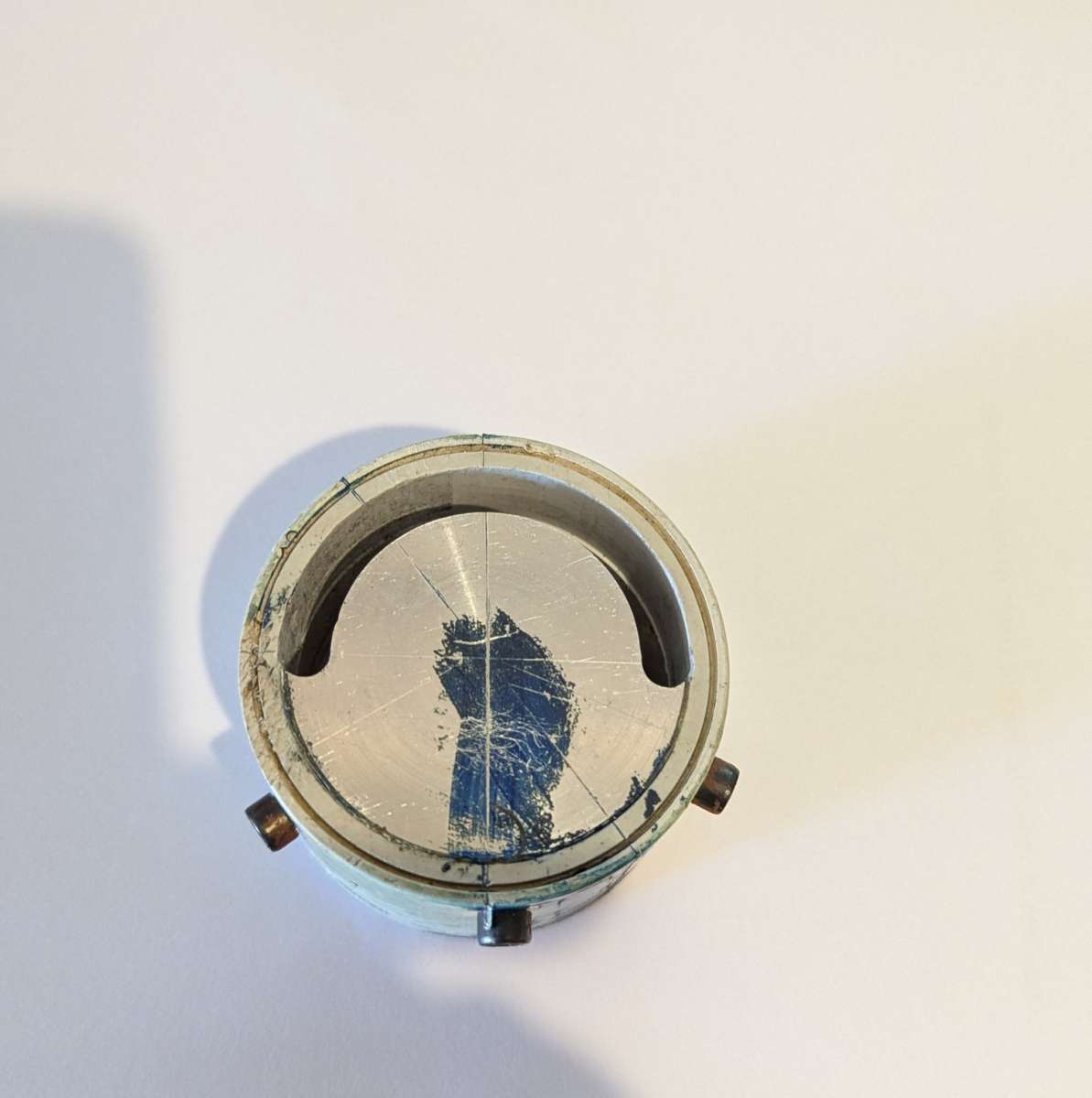

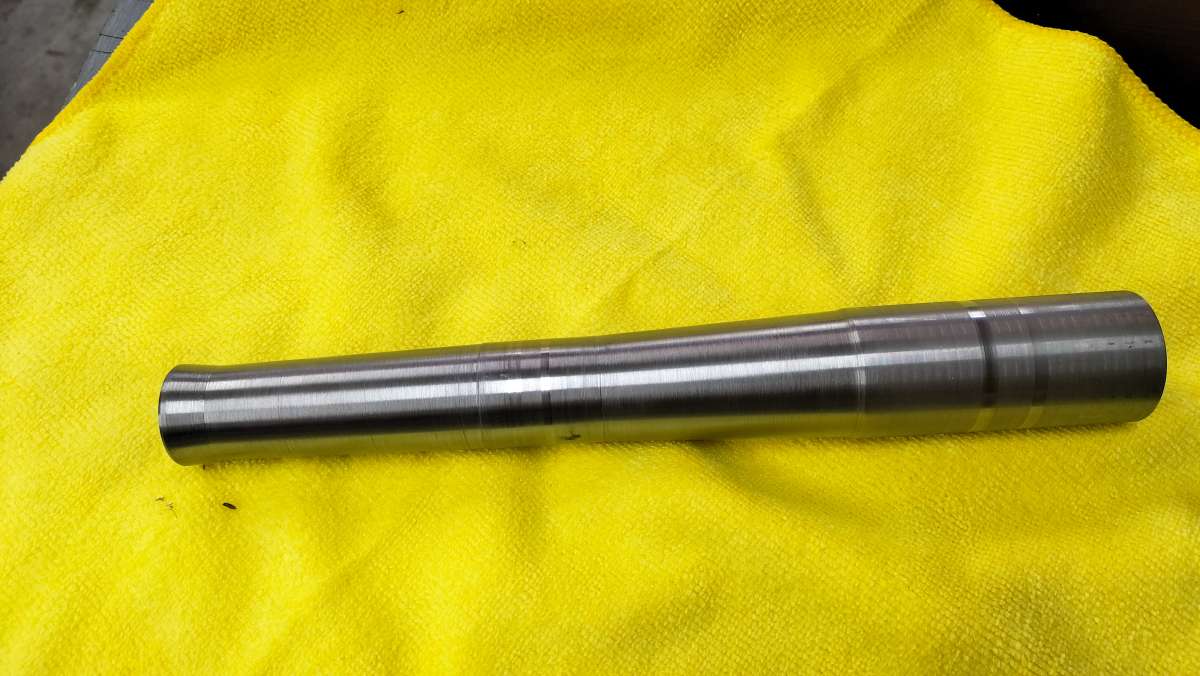

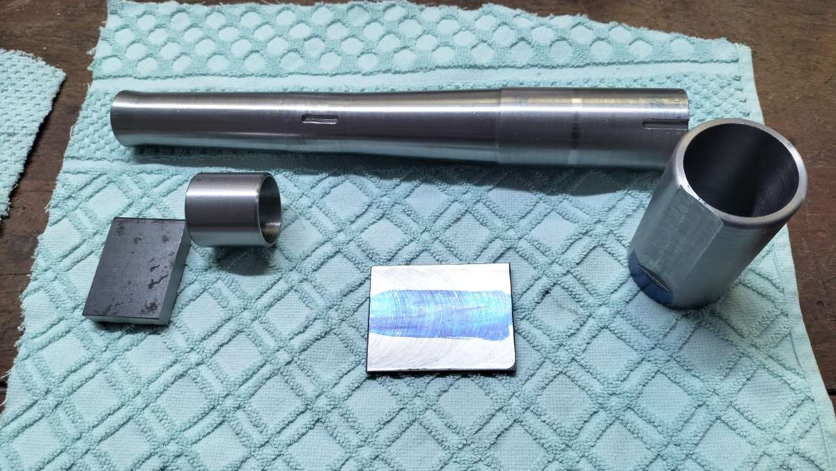

                                    After the sleeve was rifled, I fitted the sleeve to the barrel then made the front & rear Guides
                                    IMG20240203082033IMG20240203171334
                                    I Cut Guide groooves in both the barrel & Guide rings, & used pins to keep them aligned

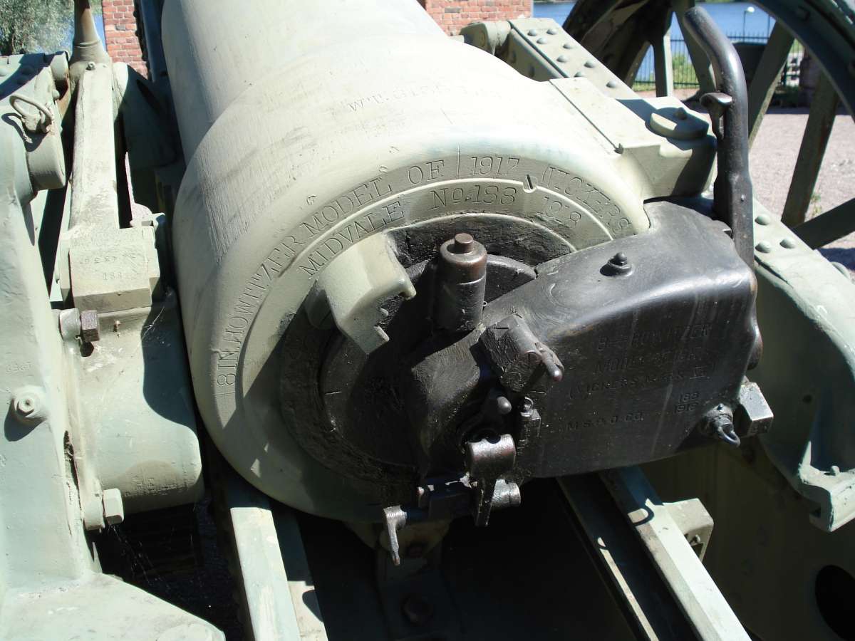

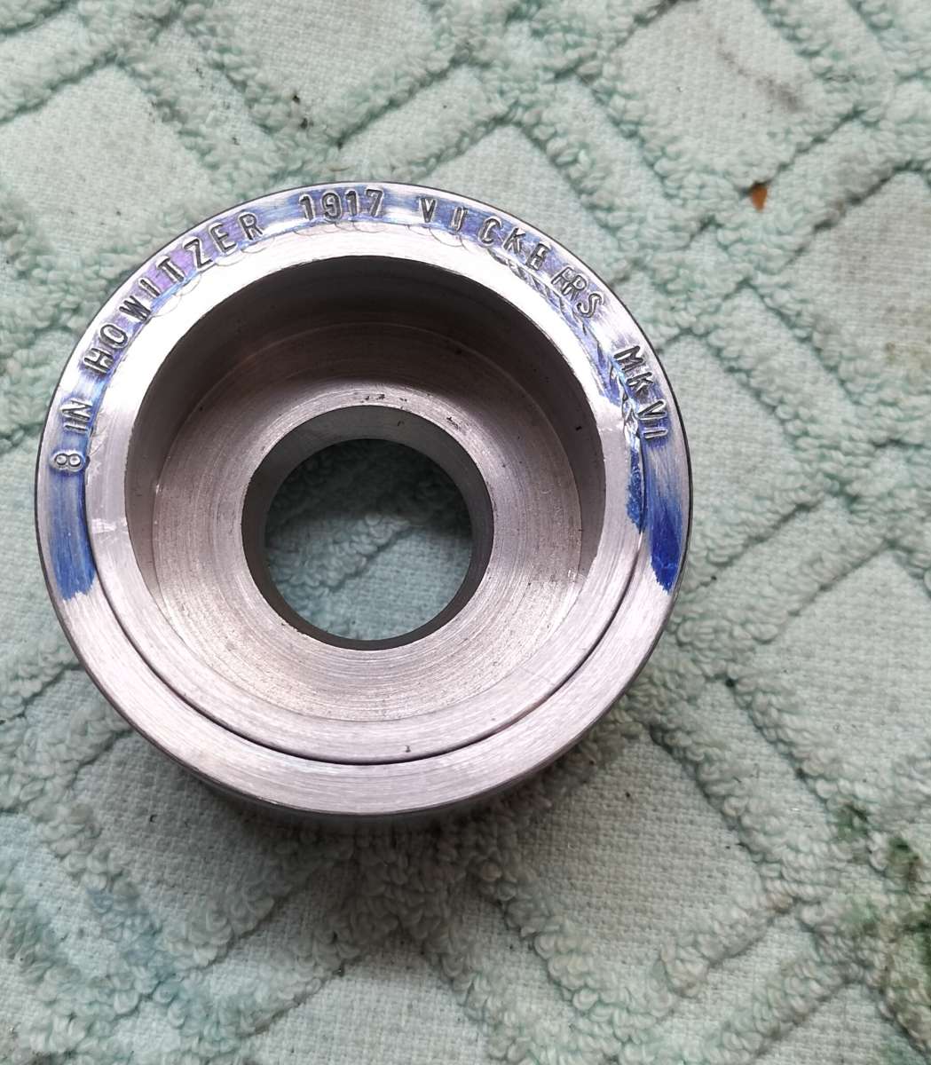

                                      Next was to do the breech housing & breech block. Before I got too involved I thought I would try letter stamping the rear edge of the breech. I made a Guide sleeve to go over the top, & used letter stamps & some brass strips to get the letter spacing right
                                      PXL_20251015_045013607   IMG20240223133614BL_8_Mk_7_8-inch_Howitzer_Hameenlinna_3
                                      The final Result was quite good
