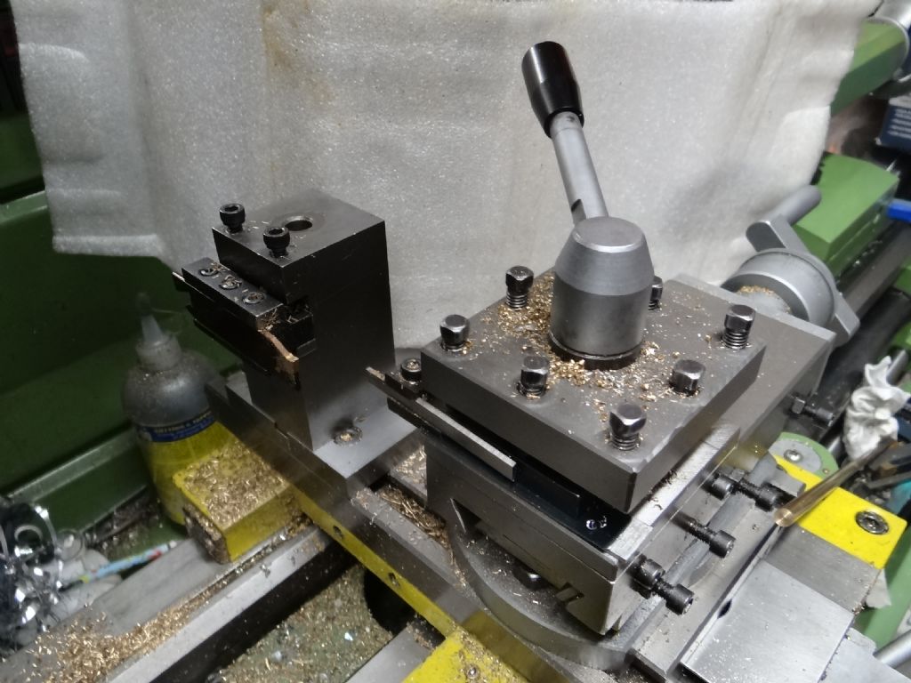

      Im a complete beginner. What is the difference between the rear tool post and a normal one?

          One cuts from the front of the workpiece and the other cuts from the rear. Nothing difficult in that. Sometimes the lathe might be driven in the opposite direction, sometimes the cutter may be inverted (definitely the way for screwed-on chucks).
          Most use the rear tool post for parting off parts on the lathe.
          #638631
            Welcome to the forum Simon.
            Wot NDIY said, but a picture is worth a thousand words:
            The front-tool post is normally mounted on a compound-slide and can be moved sideways or swivelled; they conveniently allow cutters to be applied to the job in many different ways. Often as not, the front tool-post can hold more than one tool. In the photo, mine is a 4-way type. Another favourite is a Quick Change Tool Post in which cutters are held in cartridges pre-adjusted for height.
            Front tool-posts are flexible in both senses of the word. Being able to swivel and slide means they sit on a somewhat spindly construction that's prone to bend under severe stress. Certain jobs can lift the whole saddle. As rigidity is important to machine tools – more the better – there are times when the convenient front tool-post is best avoided.
            Rear tool-posts are much more rigid. As can be seen in the photo, they are usually a hefty block of metal bolted direct to the saddle. Being squat and heavy, with no moving parts, they are much stiffer than a front tool-post. Furthermore, if the chuck can safely run in reverse, the cutting forces go straight down through the saddle and into the lathe bed – much less chance of anything bending. Disadvantage is they're much slower to set up and not general-purpose.
            Rear tool-posts are most used for parting-off. Parting is notoriously difficult because any adverse movement of the tool is likely to cause a dig-in. Any fool can part-off on a big heavy lathe, but real skill is needed on lightly built lathes with slim front tool-posts. On such machines, it's much easier to part off with a rear tool-post.

              An inverted parting tool on the rear toolpost allows the chips to fall out of the groove, giving less chance of jamming.

                        A front mounted parting tool "digs in" when an increased downward load causes a flexural rotation of its supporting structure towards the work
                        A rear mounted tool sees an upward load and "digs out" in similar circumstances thus avoiding a jam.

                                                Rear toolposts are / were used on Capstan and Turret kathes in mass productionn industry, so must have some advantages.
                                                After making and fitting a rear toolpost to a Myford ML7, parting oiff became much esier.
                                                Arguments have always raged about why they work better for parting, off and the forces involved.
                                                The fact is that a rear post does improve parting off.
