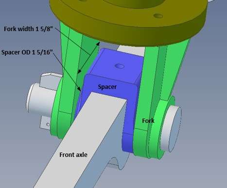

      I’m about 50% through building a 3″ scale traction engine, with all parts as yet unpainted.  Some parts are showing very mild surface rust and so I am starting to think some paint might help.  At this point, I realise I am a painting beginner and need advice please.
      This screenshot shows the front axle, cradled in a spacer which then fits in the fork:
      pic
      The axle+spacer assembly pivots around the pin and so there is some movement between the spacer and the fork.
      Am I correct in thinking that the mating surfaces on fork and spacer should not be painted?  But if the non-mating parts of the fork are painted (ie, the bits you can see in the image) then fitting the spacer into the fork will most likely scrape off some paint from the fork.
      Or perhaps the whole assembly is painted after assembly, with masking tape applied where appropriate.  But then the first time the spacer moves in the fork, it’s going to shear the paint.
      Thank you in advance.
      Martin

        Running surfaces, be they sliding, rotating or oscillating are best not painted.  Such surfaces frequently work with minimal clearances for smooth running so paint can take up some of that valuable clearance.  The paint can either erode and mix with the oil to form a sludge that can lock up moving parts or it can come off in chunks and again seize up moving parts.  I also do not paint mating surfaces as the thickness of the paint can affect the fit and can make dismantling very difficult.  Mating surfaces are rubbed with steam oil before assembly.
        Generally ferrous parts need painting to prevent them rusting however all running surfaces should be left bare.  It is far easier to paint the parts individually with the running surfaces masked.  I use an acid etching primer followed by coach enamel.  The running surfaces should then be kept oil free by frequent oiling.  It is also possible to blue the metal, which also helps to prevent rusting but it is not as effective as paint or regular oiling.

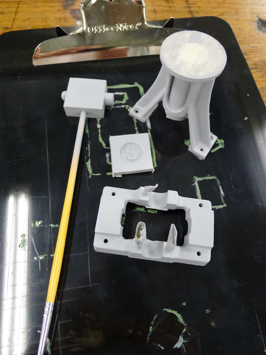

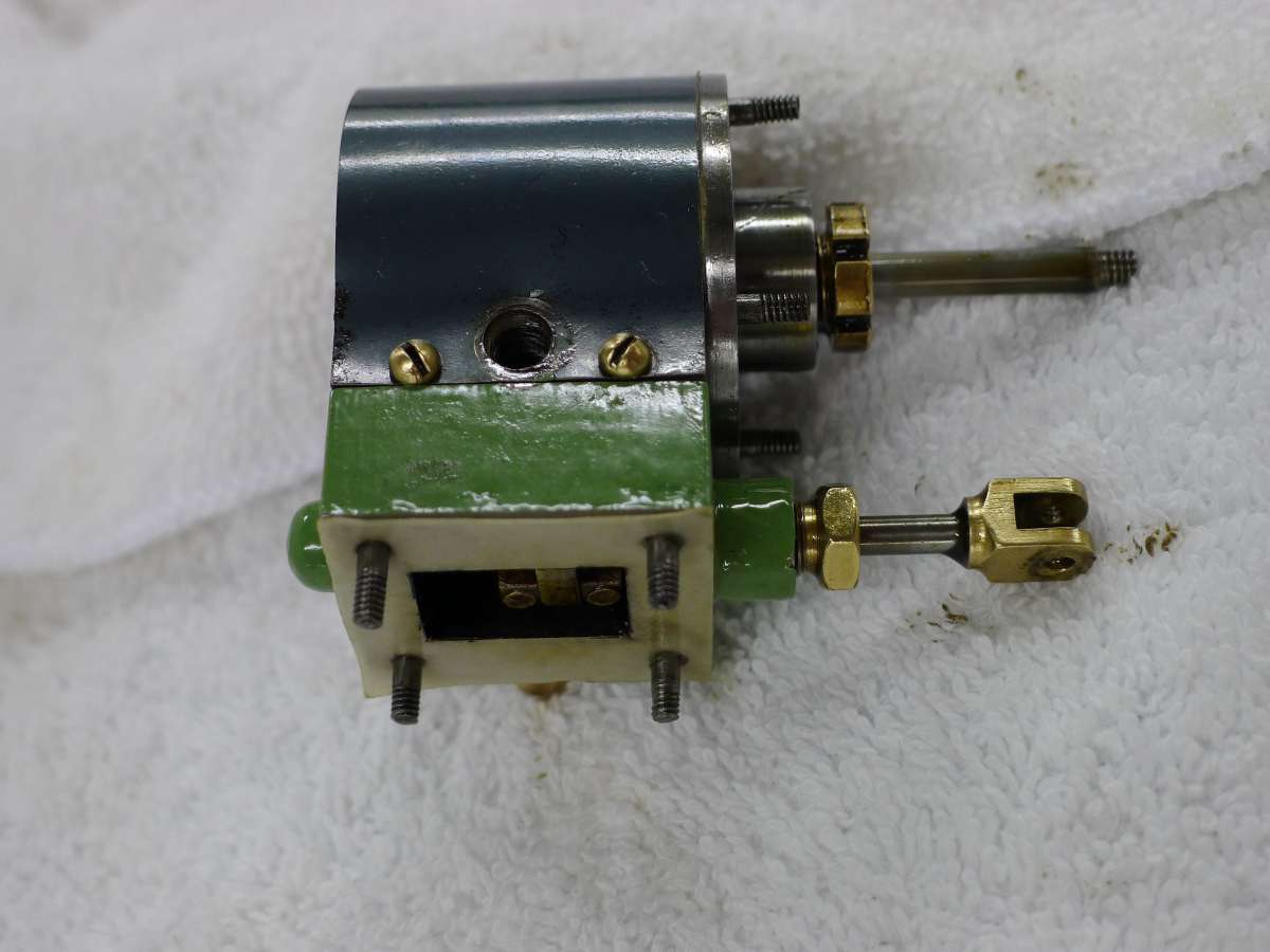

        This refurbished 10V was painted as individual parts after masking all running faces and mating faces.  The crosshead guide was masked with a paper tube and mating surfaces were masked with masking tape.
        22-11-11-01Stuart10VRestoration30
        A couple of coats of etching primer followed by a coat of two part epoxy paint:
        27-11-11-03Stuart10VRestoration78

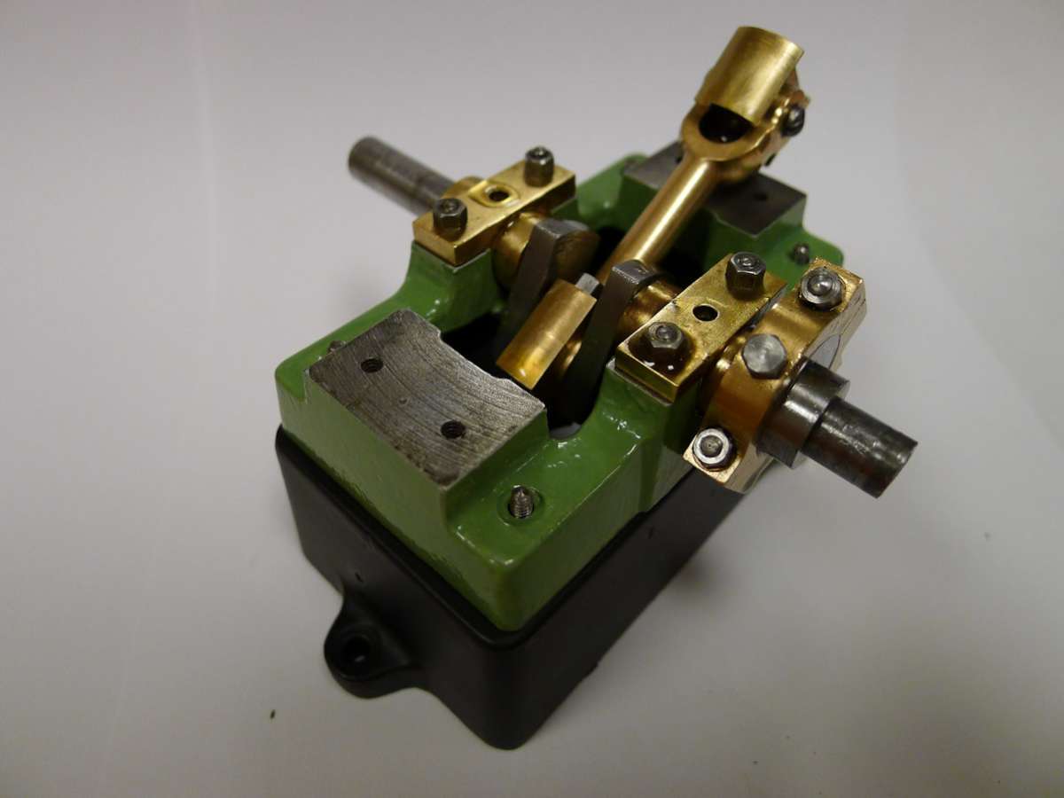

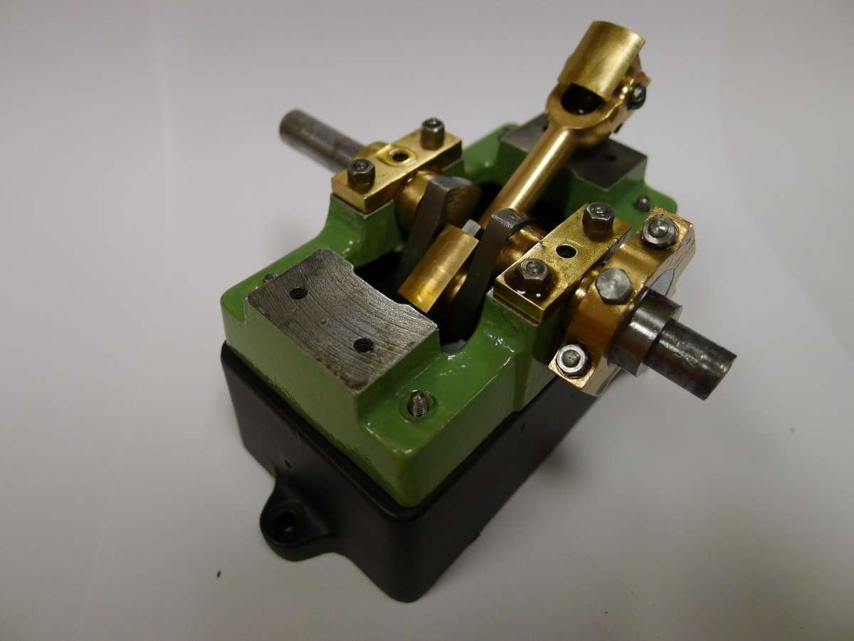

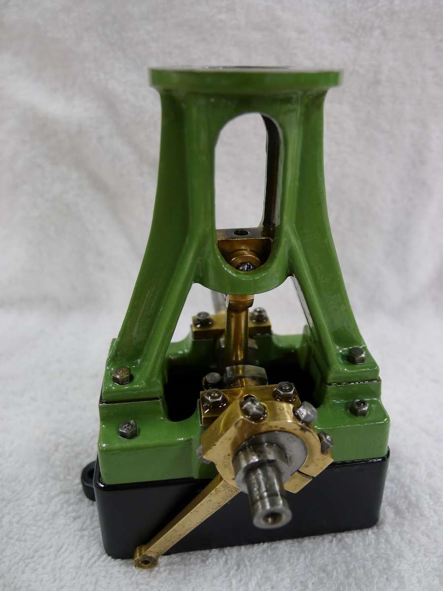

        All running gear is left bare with the ferrous parts relying on oil to keep them rust free:
        02-12-11-01Stuart10VRestoration83

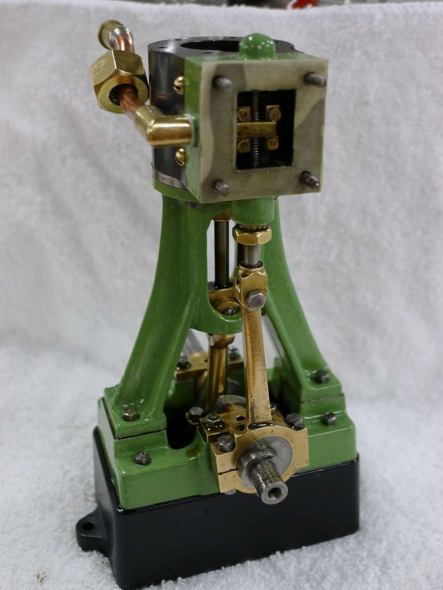

        Interestingly the cylinder cover was blued and simply needed cleaning up:
        02-12-11-09Stuart10VRestoration91
        At the end of the day there will always be bare metal components that require attention to prevent rust forming.  I even polish cylinder covers and valve chest covers, which then need oil rubbing into them:
        02-12-11-19Stuart10VRestoration101

          On my 4″ scale engines, which do not have the blue spacer, the axle and fork are machined to be a rattling good fit, about 40 thou clearance. Both parts are fully painted, two coats of primer, two coats of high build undercoat and two coats of coach enamel.
          On the full size engines I suspect that the axle and fork were not machined to a close fit, just left as fettled castings.

                                  I can’t edit the original so I’ll repost the pictures here.

                                          Thank you everyone.  Consensus seems to be to not paint these surfaces.  I’ve made the parts to drawing, which means there’s no room for the paint thickness at the moment anyway.
                                          Martin

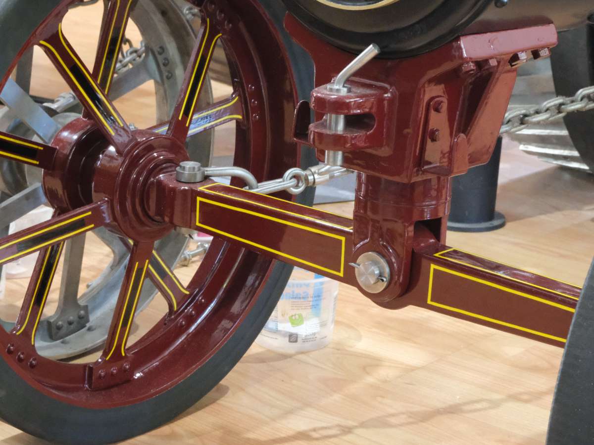

                                            Personally I think a front axle looks better fully painted:
                                            Burrell Front Axle
                                            But that’s just me.
                                            Julie
