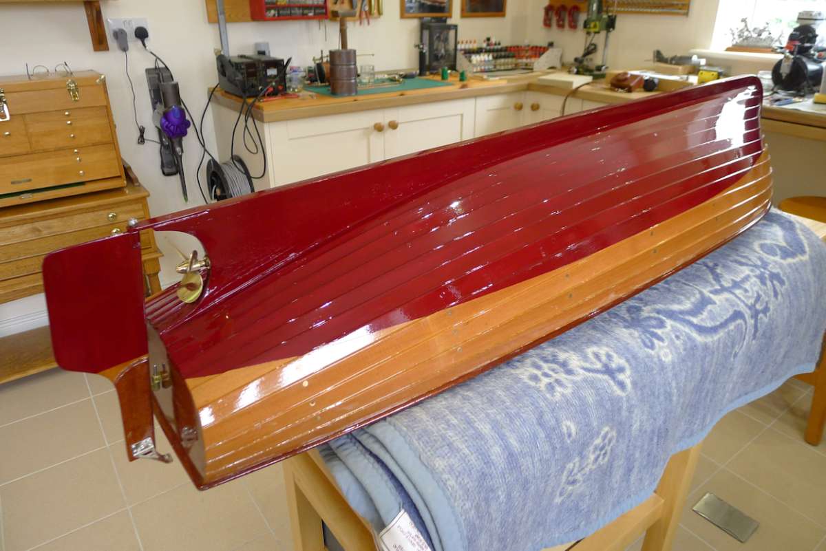

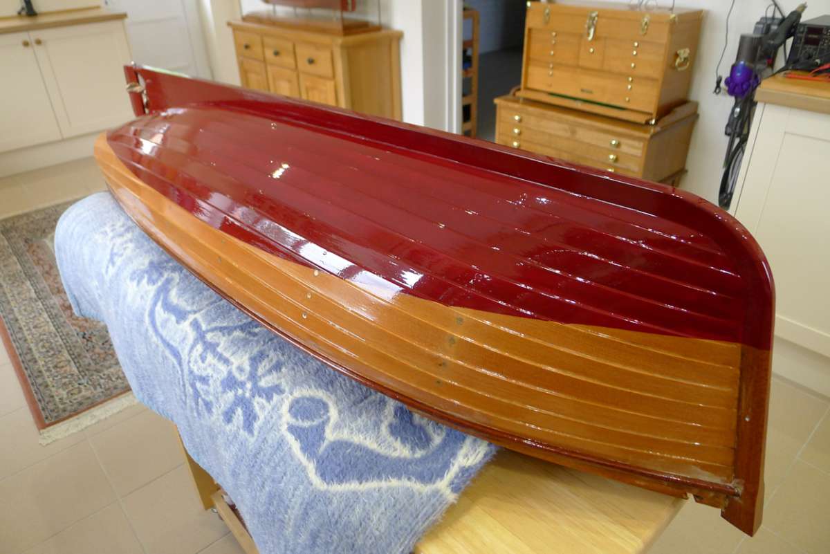

                Richard Simpson
                  @richardsimpson88330
                  Many years ago I watched a TV program about the behind the scenes at Rolls Royce.  One of the interviews was with a coach painter, who said that the best possible paint finish could only be achieved with a brush.  He then went on to explain the process of many layers, painted on in different directions and then how it was all rubbed down in between coats.  All very interesting and way beyond the vast majority of us but I always remember him saying that the best finish could only be achieved with a brush.
                  One of the best paints I have ever applied, with a brush although I’m sure it could be sprayed as well, is Craftmaster Coach Enamel.  It glides on beautifully, settles perfectly and is an absolute joy to apply.
