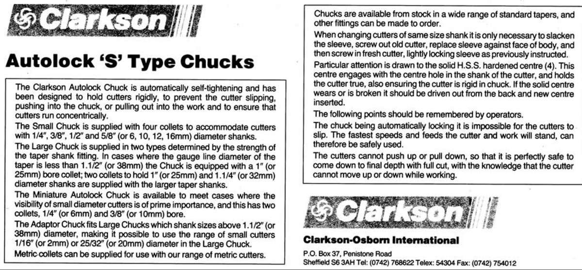

                  If you are using Clarkson threaded collets you have to be very careful how you tighten them, especially with the smaller end mills and slot drills. This is because there is a centre inside the body of the chuck which engages with the centre drilling at the threaded end of the cutter. If the cutter is screwed into the collet to the end of its thread and the chuck is then tightened, thereby forcing the cutter hard on to the internal centre, it is liable to break the threaded end of the cutter. The procedure to adopt is to place the collet into the holder and then screw the holder into the body of the chuck within a quarter turn of it being tight. Screw the cutter into the collet until it engages with the internal centre in the chuck body. Then just nip up the last quarter turn of the collet holder into the chuck body. Don’t ask me how I know this!

                    Chris, that is the way most people are taught to do it, but it is wrong according to the manual. You are supposed to screw the holder right home before screwing the cutter up against the centre. It holds more accurately that way. However, you are also told in the manual that it will tighten itself under load. Well, I have had the holder come undone when turning the mill off, when I had forgotten to give it a final tightening biff on the wrench. But I do that with the holder hand tight, not backed off a quarter.

                    peak4
                      @peak4
                      This is for the S Type, I’ve never found instructions for the C Type
                      image_2023-12-16_011935422
