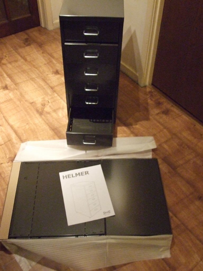

      As the tool count is ever increasing and plastic boxes are not an ideal solution I was looking for some steel drawer cabinets like the Bisley office A4 draw type, Even second hand prices were arround the £100 after Freecycle failed to deliver.
      A look at the Ikea catalogue (not normal reading,) I found the Helmer 6 draw steel cabinet for £25.
      <http://www.ikea.com/gb/en/catalog/products/60296126/#/80296125>
      Two were purchased and they are eminently suitable tool storage. The only critisism is the top needs a tab at the back to stop it sliding off when you roll it out on its castors.
      No family or shares in Ikea.

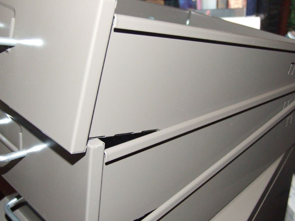

                          These are the drawers we had from IKEA about 11 years ago. They have the Z runners which JS mentions.
                          We used to use/abuse them to take products to shows, over a period of five to six years. They did the job, even though there were problems with slides due to heavy use. Welded certain drawers and certain z runners when needed, scrapped a few and used the usable drawers after some welding. We did curse at times due to poor performance when you needed to get to the bits inside the drawer quickly during the shows and the drawers sometimes did not open because of the way we had filled them, but they worked, until we changed over to bisley (totally different animal and price), which have served us well.
                          We put candle wax on the z runners, which did help with the sliding of the drawers…to a point. We made a frame for the base fitted with heavy duty wheels, because of the heavy usage.

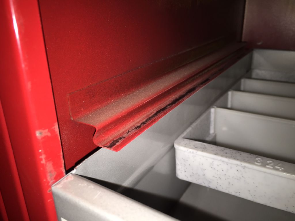

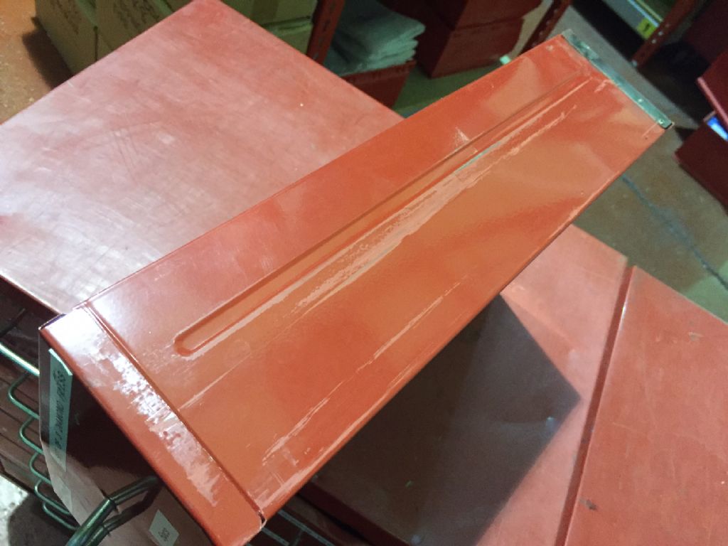

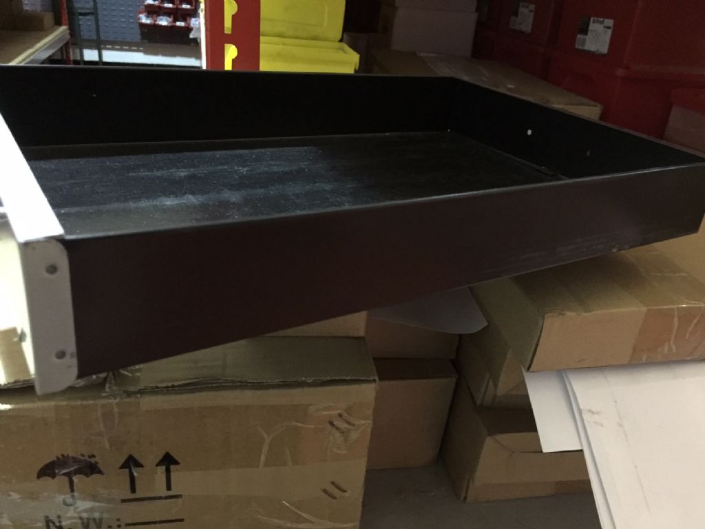

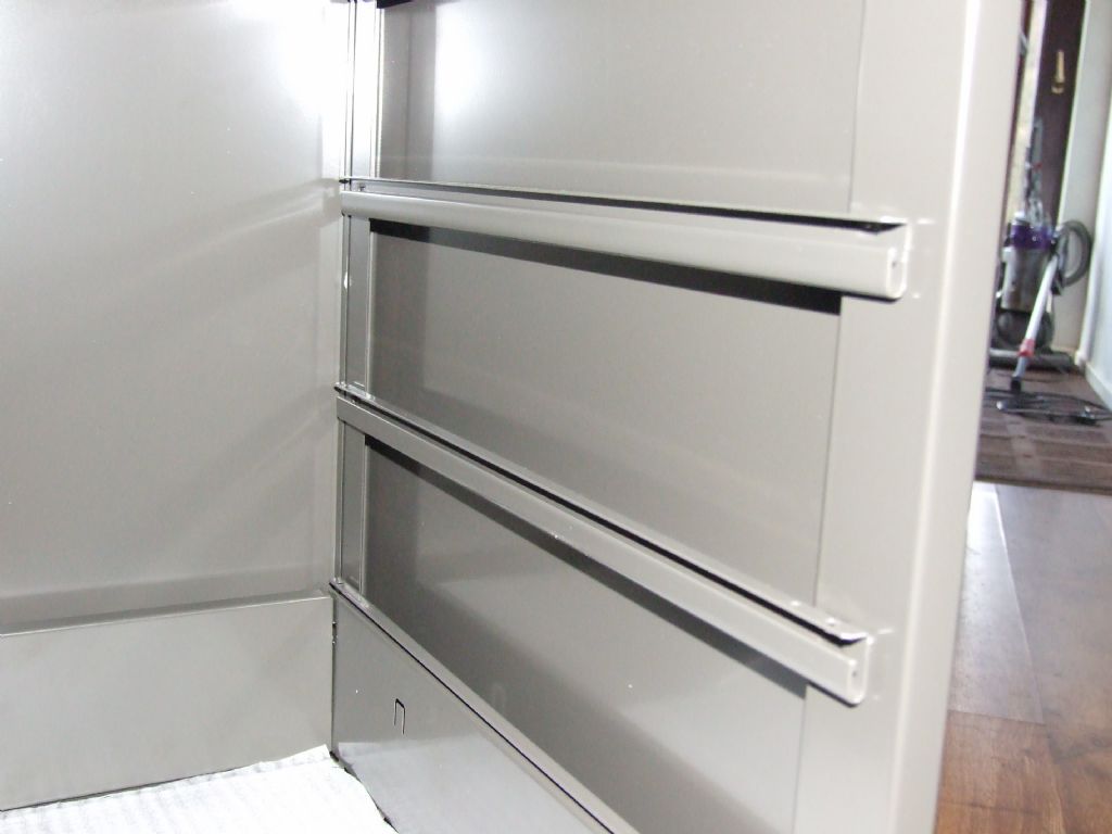

                            2016_0115_tool_draws_0005.jpg2016_0115_tool_draws_0003.jpgIt seems there has been a design improvement which should improve the load carrying capacity.
                            Photos in my album, but I still can't add them to the message.
                            Edited By Malcolm Parker-Lisberg on 15/01/2016 14:04:59

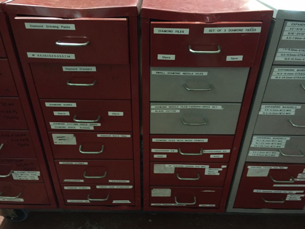

                              Ketan Swali
                                @ketanswali79440
                                Malcolm,
                                The design improvement does look a lot better.
                                Russell,

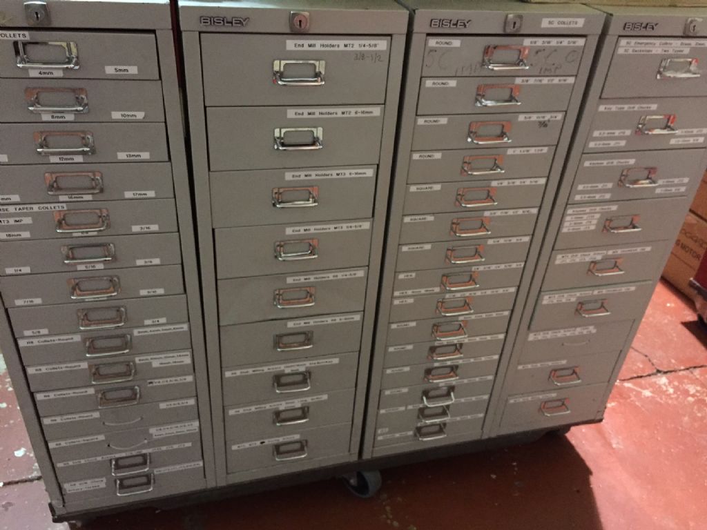

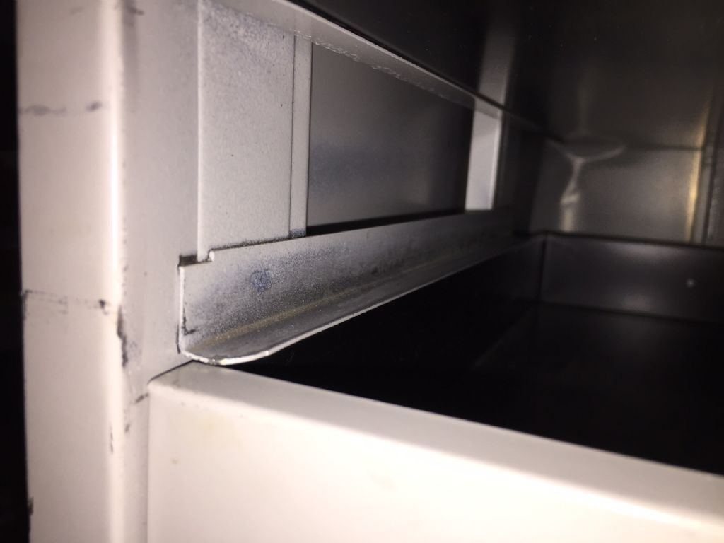

                                After the experience with the old IKEA design, we did move over to Bisley while we did a few more shows. Pictures below. You are right about them being better than the old IKEA design, and they carried higher load. I wonder how they compare with the new IKEA design.. I am guessing that the new IKEA design may still be good value for money.
                                Ketan at ARC.
