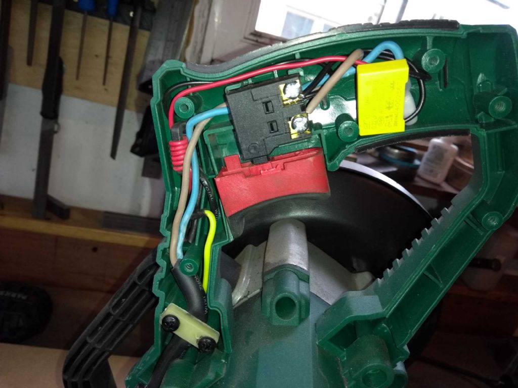

                        Iain Downs
                          @iaindowns78295
                          I've had a go.
                          I took the back off to find the commutator, which was mucky (carbon). I cleaned off the muck with a cloth and some isoproplyl alcohol. I tried to scrape between the bars with some thing steel (actually a nail file), but not sure how useful that was.
                          I took off the handle and found that the 'electronics' consist of an on switch and a capacitor.
                          I decided to see if I'd done any good. I replaced the handle cover but left the commutator cover open so I could see.
                          I put a 5A fuse in the plug (comes with 13, but 5A might cover it). I got a spark from the commutator and the fuse blew without the motor turning.
                          Next go was to use a 13A fuse. As when I tried this before, the motor spun up and almost immediately slowed down as the fuse blew. And the fuse in the house.
                          I don't really know what goes wrong when a motor like this gives up. It seems like there is a short circuit somewhere, but I can't imagine how I'd find or repair it.
                          Not sure what to do – I was tempted by the Aldi bandsaw, but they're no longer available.
                          Iain

                                @ianp
                                If the fuse blows immediately then something is shorted, it could possibly be the capacitor.
                                Without a reference scale of 'mucky' its hard to say for sure that the armature is toast, the commutator start off as bright copper but sometimes the area that the brushes wipe gets glazed and polished to a much darker tone.
                                A photo of the electrical bits switch, capacitor and the brush/commutator end) would help.
                                Ian

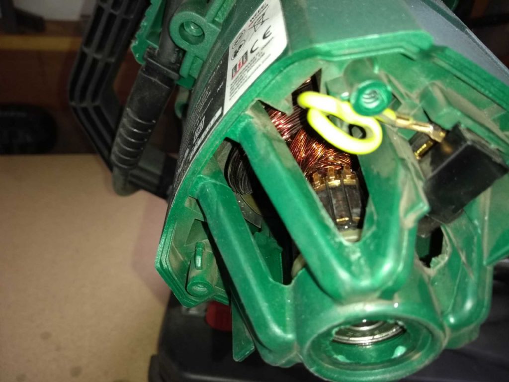

                                  Iain Downs
                                    @iaindowns78295
                                    I am fairly firmly of the opinion that the parrot (sorry, chop saw) is dead….
                                    However, I did take some pictures.
                                    Here is the handle. I spent part of my youth as an electronics engineer of sorts and have blown many a component. I don't think the capacitor is one – also it will start up and then blows (perhaps the short is in a particular place and the initial rotation finds it).
                                    This is the commutator. After it has been cleaned (to the best of my ability). There isn't a lot of evidence of sparking on it, but it was original flat black .

                                      Phil Whitley
                                        @philwhitley94135
                                        I see that the gaps between the commutator bars are wider in the middle, looks like the insulation has failed in the armature windings, test between the comm bars and the shaft of the armature, with an AVO, or a megger if you have one, any continuity, or a resistance of less than 1 Mohm and the armature is toast. Check the manual and get in touch with the spares supplier, then at least you can weigh the cost of a new armature against the cost of a new chopsaw.
                                        #410647
                                        Phil Whitley
                                          @philwhitley94135
                                          actually looking at the pics again, is that a bit of blackened field coil I can see through the lower gap? Field could have failed and caused the arcing at the armature. Armature failure is more common though.

                                                I strip down and repair several chop saws every month, mostly wood working saws. The field coil in the picture does look a bit burnt but can look dark under certain light due to the way light is dispersed by the varnish.
                                                Only way to check is to strip it down and look at all of the parts. If doing so, I'd suggest taking out the brushes first as they may get damaged when the armature slides out of the housing.
