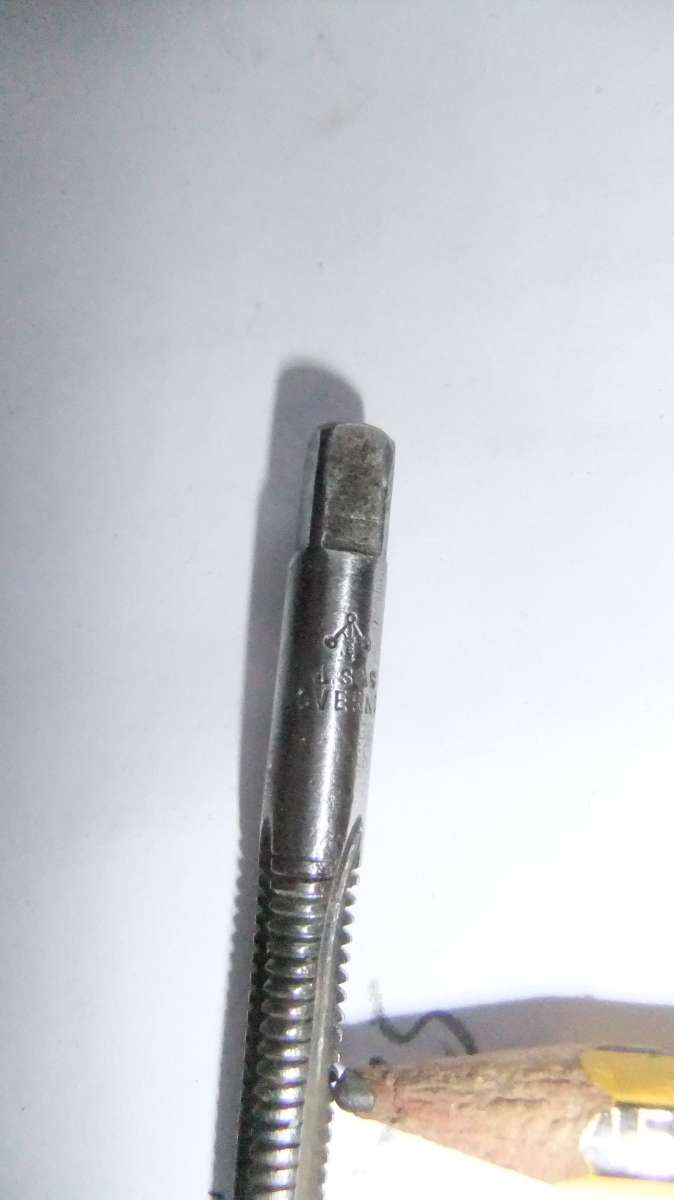

      I was sorting out some of my taps and dies and came across two odd marked taps one being marked as 17/64″ 25 and a manufactured name Millennium.
      The second is marked as 7/64″ and what look like JS&S Governor. It also has a small stamp that looks like the broad arrow but has circles at the tip and to trailing ends
      DSCF4569
      It seems strange that no other marking
      Any ideas on the sizes marked would help

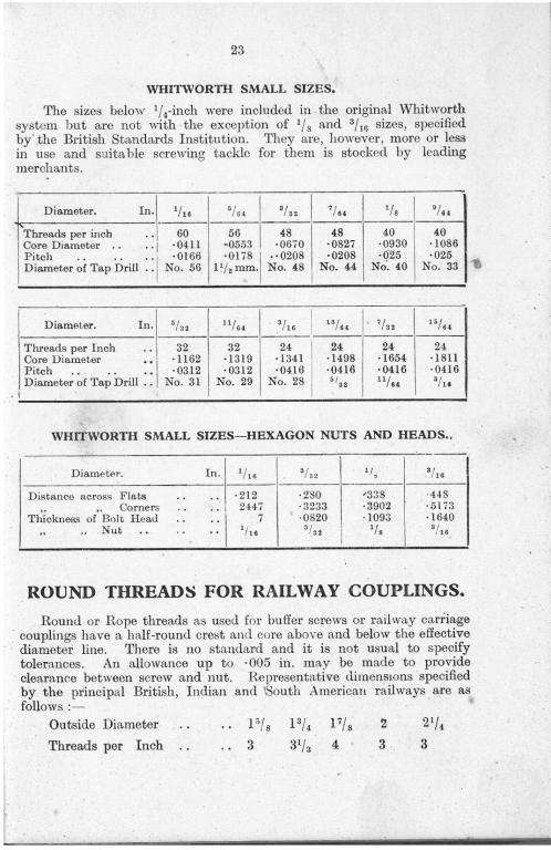

          They may be examples of Whitworth threads which never made it into the British Standard. This page gives some details, though regrettably I don’t have a record of what book it came from:Whit small threads
          That definitely isn’t the broad arrow, but presumably the manufacturer’s logo.

            Thank you both. That answered why they are odd sizes

              Not too difficult to identify once right words are used in a web search.
              JS&S was John Shaw and Sons, who, amongst many other things, made three models of brass petrol blowlamp:  Governor, Lamb and Anglo Swedish.   The broad-arrow with circles represents a James Watt style centrifugal governor, so I’m confident the tap is for one of the threads on a  Governor model JS&S blowlamp.
              Likewise, Millennium blowlamps were made or rebadged by Lake & Elliot Ltd.   Reasonable to assume the Millennium marked tap is for a Lake and Elliot Millennium blowlamp.
