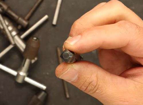

                      I think the one he showed was flat on the end – never seen one like that, but maybe they exist somewhere.
                          Rob
                          No problem with a near flat ended tap, there is usually at least a small chamfer (quite large on his) which will fit into a conical female c tr guide. I do it all the time.
                          flat
