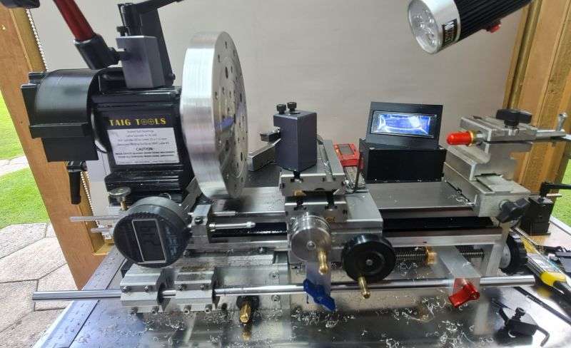

                        I have and use a Taig lathe (in the UK but bought from the US). It works very well for the small scale work I do (mostly clock scale). That said I have turned, courtesy of Taig’s riser blocks, a 6″ diameter aluminium disc to create a fixture plate for my rotary table.
                        Taig large swing
                        As a happy Taig user I would make the following comments.
                        The Taig is very reasonably priced ( particularly if you are in the US), and capable of high precision work. It is however, compared with the more expensive Sherline equivalent, more the basis for making what you want, than an out of the box ready to go solution. If you simply want a lathe to make models, then the Sherline ready to run out of the box will be a better bet. If however you want to make something that suits you, the Taig is a good cheap starting point.
                        Sherline sell a wider range of accessories and addons than Taig, so its possible to buy all sorts of features that you will need to engineer yourself if you go the Taig route. I have added DRO’s and a powered leadscrew to my Taig. It is also driven by a variable speed DC motor (I would suggest not to buy the stock Taig AC motor), something which comes with the Sherline.
                        In either case (Taig or Sherline) I would suggest getting an ER16 headstock with the M22 x 1.5mm thread. Both firms supply chucks and faceplates to fit that thread (I have an M22 x 1.5 Sherline 3 jaw I use on my Taig). Using ER collets when working with material smaller that 10mm diameter is far nicer than trying to do it with the jaws of a chuck spinning past your fingers. The ER collets hold a decent range of  material sizes so you need 10-12 collets. Going down the watchmakers collet route (where each collet only holds a very small range of sizes) gets very expensive very quickly (check out Sherline’s collet sets).
                        Taig don’t do a screw cutting capability, although people have engineered  solutions. Sherline do a hand cranked capability. So far taps and dies have met all my screw cutting needs.
                        Like Dave – if money were no object and I wanted to simply make clock scale things, would probably get a Cowells. However I have got very used to the idea that if I need something changed on the lathe I can simply make or modify  the Taig, and that is not something that would be as easy on the Cowells.
