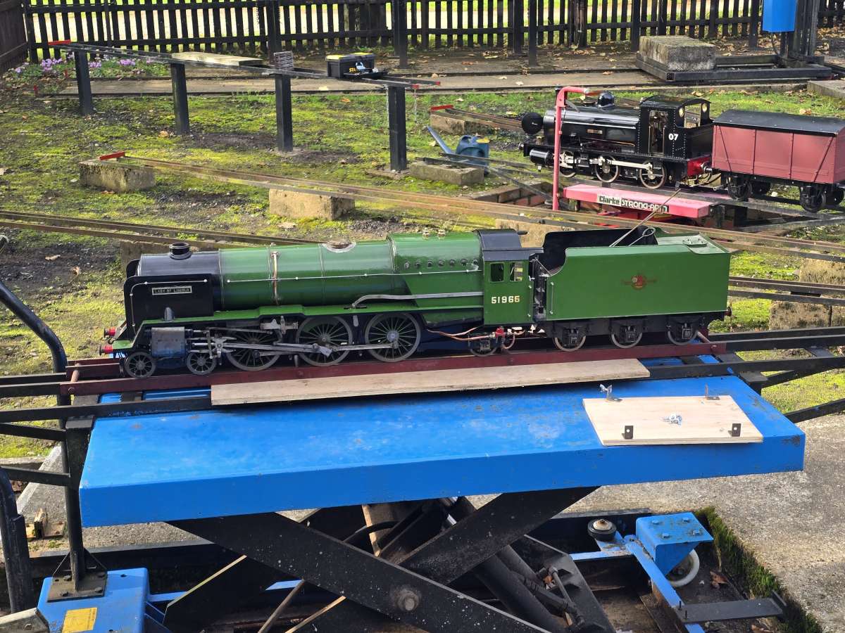

      My name is james and I have just inherited a 3.5″ gauge loco that my great uncle bulit in the 60’s it has not run for at least 40 years and I have no paperwork.
      I have managed to pump it up to 50psi with a water pump which has shown a few leaks. Been to a couple of engineering societys at Lincoln and nottingham both saying I will need to expose the boiler to get it checked properly.
      I am struggling to identify what it is bassed on does anyone here recognise it?20251002_102557

        Pamela‘: ‘LBSC’ designed loco???
        Albeit both loco and tender platework modified to give a more ‘BR standard’ outline.
        Has it been constructed as a  three cylinder loco?   Loco chassis looks very ‘Hielen Lassie‘ influenced.
        Hielen Lassie also designed by LBSC for 3 1/2″ gauge.

          I have been told by someone it looks like hielen lassie but the boiler inspector I saw today at nottingham said no but did mention LBSC looks like it is going to need a new boiler

            Britannia ? but does not have the smoke box regulator. Gresley A3 . The front end is all wrong for a heilan lassie. Noel.

              I would advise a proper, thorough inspection with the cladding removed. (Repairs would likely need the boiler removing from the frames, but the inspection should not).
              By “proper” I mean carefully and to the standard scheme – but not to some nervous inspector’s own “gold-plated” version of it!
              You say a couple of leaks; but from what? Shell joints, tube joints or around a couple of rod stays? Or just around fittings?
              It would need a new boiler only if inspection reveals irrepairable faults.
              The lack of test-certificate paperwork is not a problem but having the drawings available would help the inspector. A test-certificate can be organised for it by treating it as a “new” boiler – but that will mean an initial, once-only “shell test” to twice working-pressure. As would major repairs.
              Obviously if it fails the shell-test, that’s it for that boiler.
              The test scheme we use says boilers “… have in fact to be safe” (I quoted that not from the MELG book but from the original PER law – about the only use of the word in pages of ISO-EU-legal waffle!) but not how they are designed and built.
              Otherwise there would be a lot of older model locomotives no longer able to run; although standards have improved and we no longer do things like screwing studs or fittings directly into the copper shell.

                The leaks I mentioned are from gaskets and what looks to be stays in the cab. there is also evidence of soft solder.

                  Leaks from gaskets are easily put right: new gaskets!
                  Soft solder alone is not a problem. Miniature boilers years ago were commonly rivetted and caulked with soft solder, though it should be a solder with a high melting-point, not the low m-p alloys for assembling electronics. Most such boilers probably have plumbing solder in them.
                  Small leaks around stays are not too serious but a leak on a major structural joint is far harder to deal with. If silver-brazed, it might be repairable with a low melting-point silver solder, but silver-solder cannot be used on joints already holding soft-solder.
                  The nature and location of the leak, and of the existing fabrication around it, needs assessing very carefully. If the soft-solder appears to be caulking a leak on a silver-soldered joint, it can only be sealed with soft-solder.
                  Such a leak may be due to a spot of contaminent or oxide on the original surface; and these might be “sealed” with flux for a long time but eventually that disappears to create a leak path.

                          Your loco does have the look of LBSC’s Britannia about it, the shape of the frames seems about right and the general proportions. But I see it is fitted with Baker valve gear, this was one of LBSC’s pet valve gears which he featured in some of his designs, P.V Baker and Fayette spring to mind. He may have included it in one of his articles as a modification, there are articles on Baker gear in the Live Steam book and I believe there was a Baker gear option for Titch. Looks a nice engine , worth getting steaming again
                          Worth having a look at John Baguleys website, he is a dab hand at sympathetic restoration of older locomotives, I’ve found answers to many problems there.
