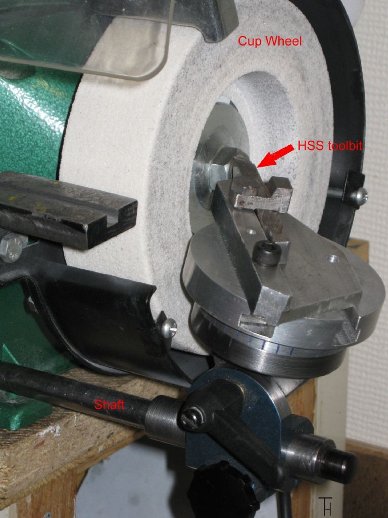

          I think that's a good idea John. My grinding facilities are simple, I have made a grinding jig for my bench grinder so I can grind lathe tools – see photo – and also grind drills.
          I attached a 12mm diameter rod to the base of the grinder and the jig pivots on this shaft. At the right end there is an adjustment screw (on a sleeve) to set depth of cut and the jig can be unclamped from the sleeve and positioned close to the grinding wheel. The top swivels 360 deg. and can be tilted. The jig swings into the face of the wheel for grinding. Not very sophisticated but it works. In the left part of the photo there is a grinding support with a slot, this is used to grind toolbits for screwcutting.
          Thor
          Edited By Thor on 04/06/2015 06:48:24

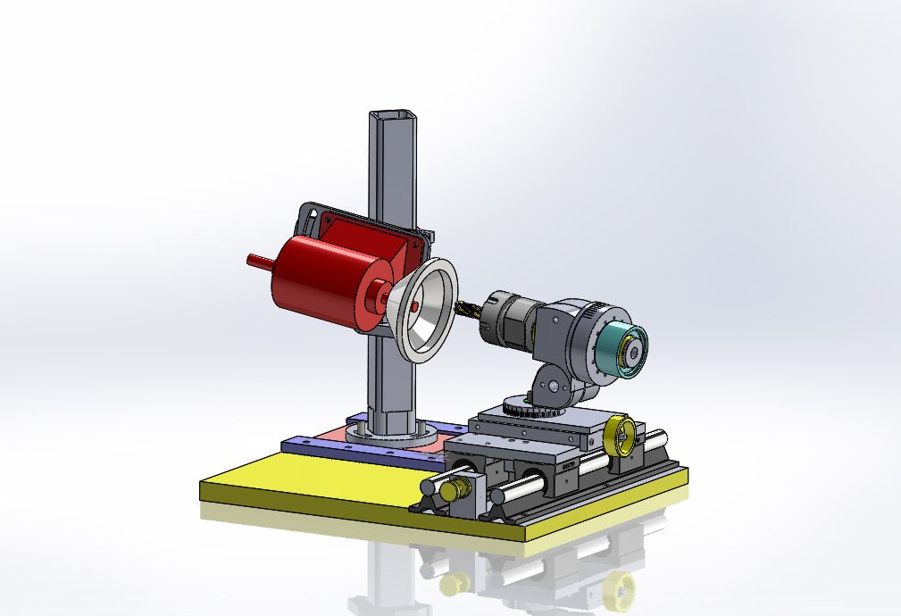

            This is a model of a T&C grinder which I am working on. Still a long way to go before manufacture. It has a 3MT spindle to accept a collet holder or the cutters which I use on my mill and lathe (which could be changed to accept R8 tools or other). The pivot/swivel tool holder will be replaceable for different grinding applications.
            I intend to use a mini grinder motor with an assortment of different wheels. (may have to replace bearings if existing not accurate enough). Also looking at other motors to use as a grinder. Both the tool holder and the grinder can be rotated and moved to accommodate different angles.
            Constructive comments about its design would be appreciated.

                  Hi Paul
                  I like your concept drawing. I have been looking at the Quorn design for a while and there is just to must work. Your design with the linear rails will be quicker and easier. What cad package do you use. I work in Solidworks and i am willing to work on the design with you
                  Kenn

                                Hi Neil,
                                I am tying to simplify the grinder design, and use commercial parts (sourced the linear bearings and lead screws from fleebay for a good price), catering for most of your comments and trying to incorporate features which I have seen in other designs.
                                Kenn, It is modeled in Solidworks andI appreciate your offer to assist but would like to do it by myself . I used to work as a design draftsman but have now retired, This project allows me to keep my CAD skills up to date and my mind active. (they say you keel over if the mind stops working).
                                Will post more details after I have developed it further, Paul.

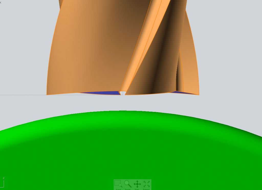

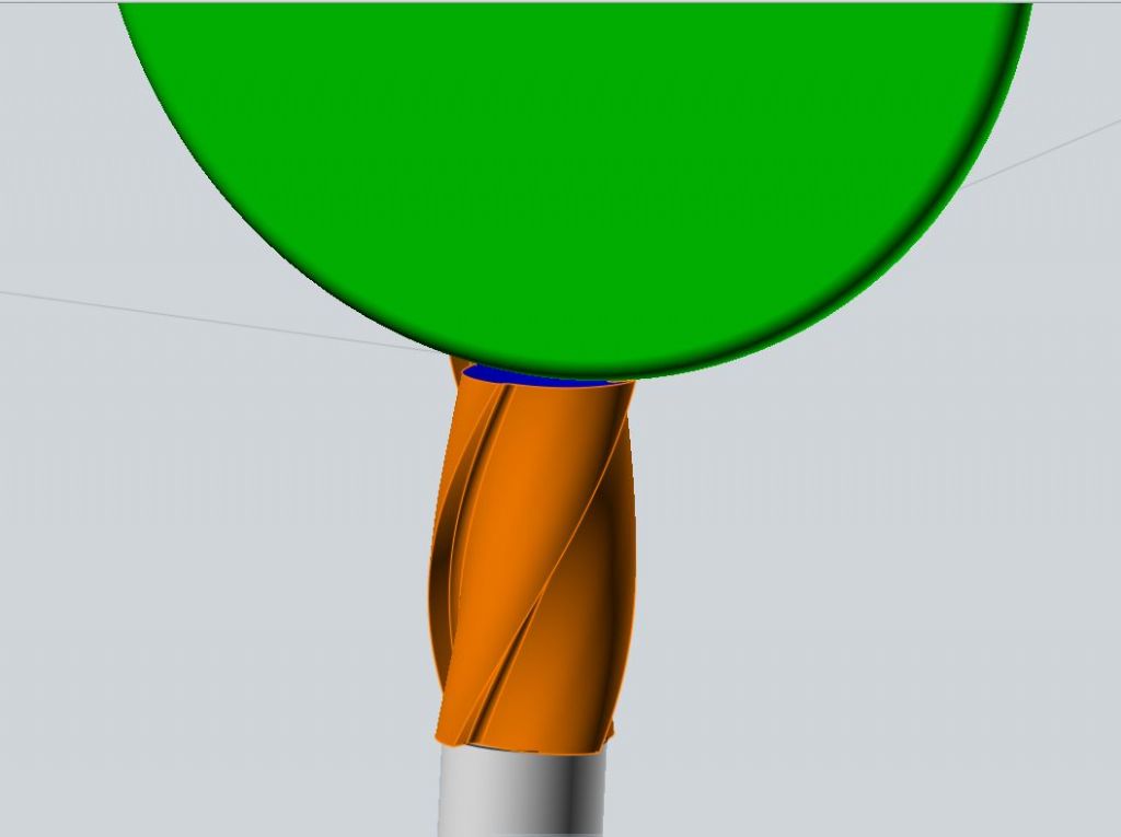

                                  If you haven't got a tool & cutter grinder, I find a simple way to rejuvenate an end mill is to grind a (quite subtle) spherical concave shape onto the tip.
                                  I normally do this freehand on the bench grinder using the corner of the wheel, but I'm sure the results would be neater if I rigged up a decent cutter holding device, which would simply be a way to rotate the tool whilst steadily presenting it to the wheel. I've tried to show how this shaping technique automatically provides the necessary clearance angles in the CAD mock-up pictured below. The green disc represents the abrasive wheel and the dark blue area is the spherical surface produced by grinding.
                                  Martin.
                                  Edited By blowlamp on 04/06/2015 23:41:47
                                  Edited By blowlamp on 04/06/2015 23:46:22

                                    OK for going in from the side Martin but won;t handle plunge cuts.
                                    God logical thinking though
                                    #192420
                                    blowlamp
                                      @blowlamp
                                      Posted by John Stevenson on 04/06/2015 23:49:01:
                                      Agreed, I forgot to mention that you can't do the usual plunge cuts, although I have been able to squeeze the odd couple of thou plunge for cleaning up a surface – it's really just a quick way to get some more use from an end mill without a lot of bother and good for altering tee-slot cutters.
                                      Martin.

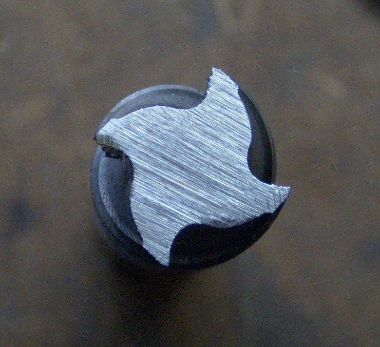

                                                  I just checked a few new endmills here, and they are centre cutting. i also checked an old-style one John put in the EMG12 – it's centre cutting now, but i don't think it was before

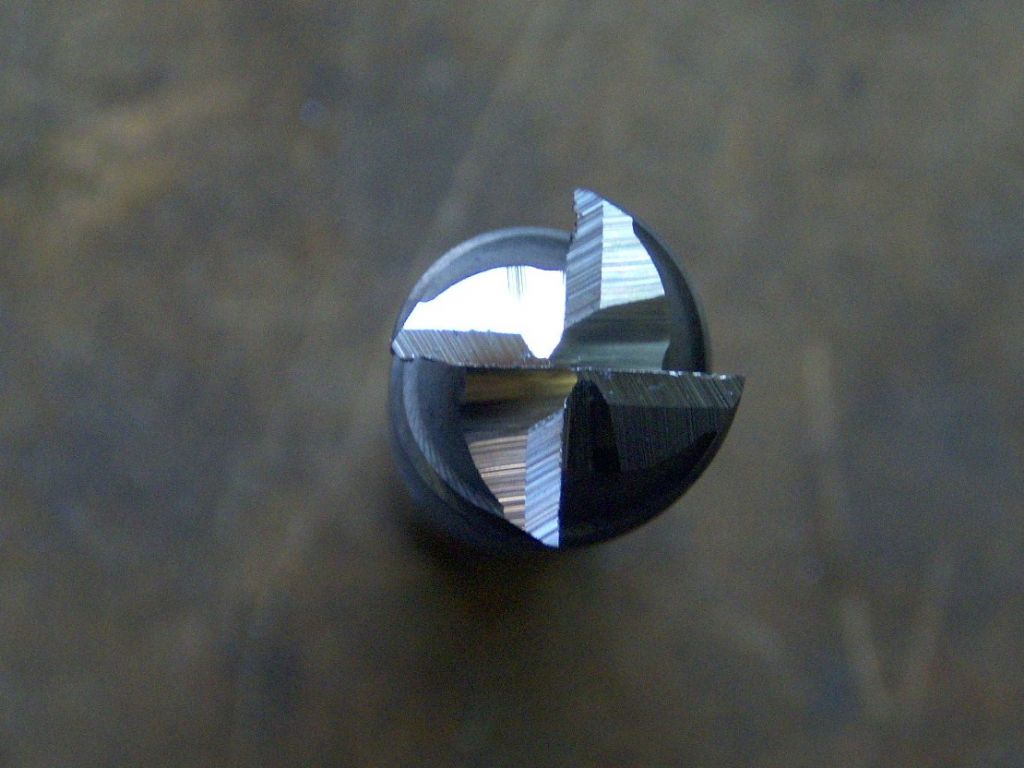

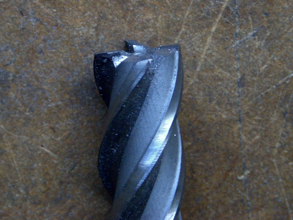

                                                      As JS says from blunt traditional endmill
                                                      Quick hit on the bench grinder
                                                      Then in less than 60seconds its a 4 flute centre cutting milling cutter thats primary, secondary and gash cuts in very short time
                                                      Edited By JasonB on 06/06/2015 13:26:08
