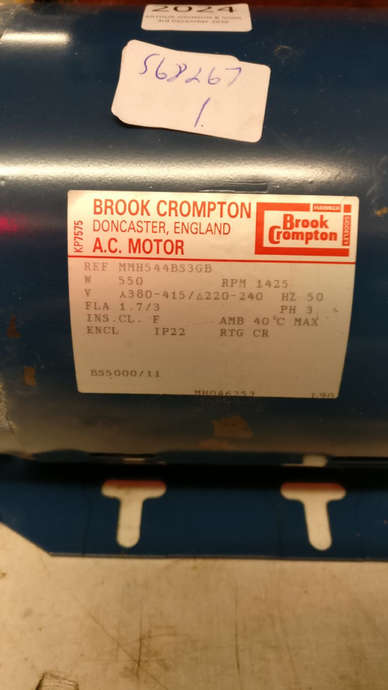

              #270046
              Michael Bird 1
                @michaelbird1
                Here is the plate:
                #270048
                Ian Parkin
                  @ianparkin39383
                  That's a standard plate use on those type of motors the N does stand for neutral it's the star point which doesn't have anything connected to it…remove the 3 wires from that point and determine which pair is which and the connect the other end of the red connection to the yellow the other end of the yellow to the blue and the other end of the blue to the red connection…. connect your 3 live from your inverter to the 3 terminals and you good to go

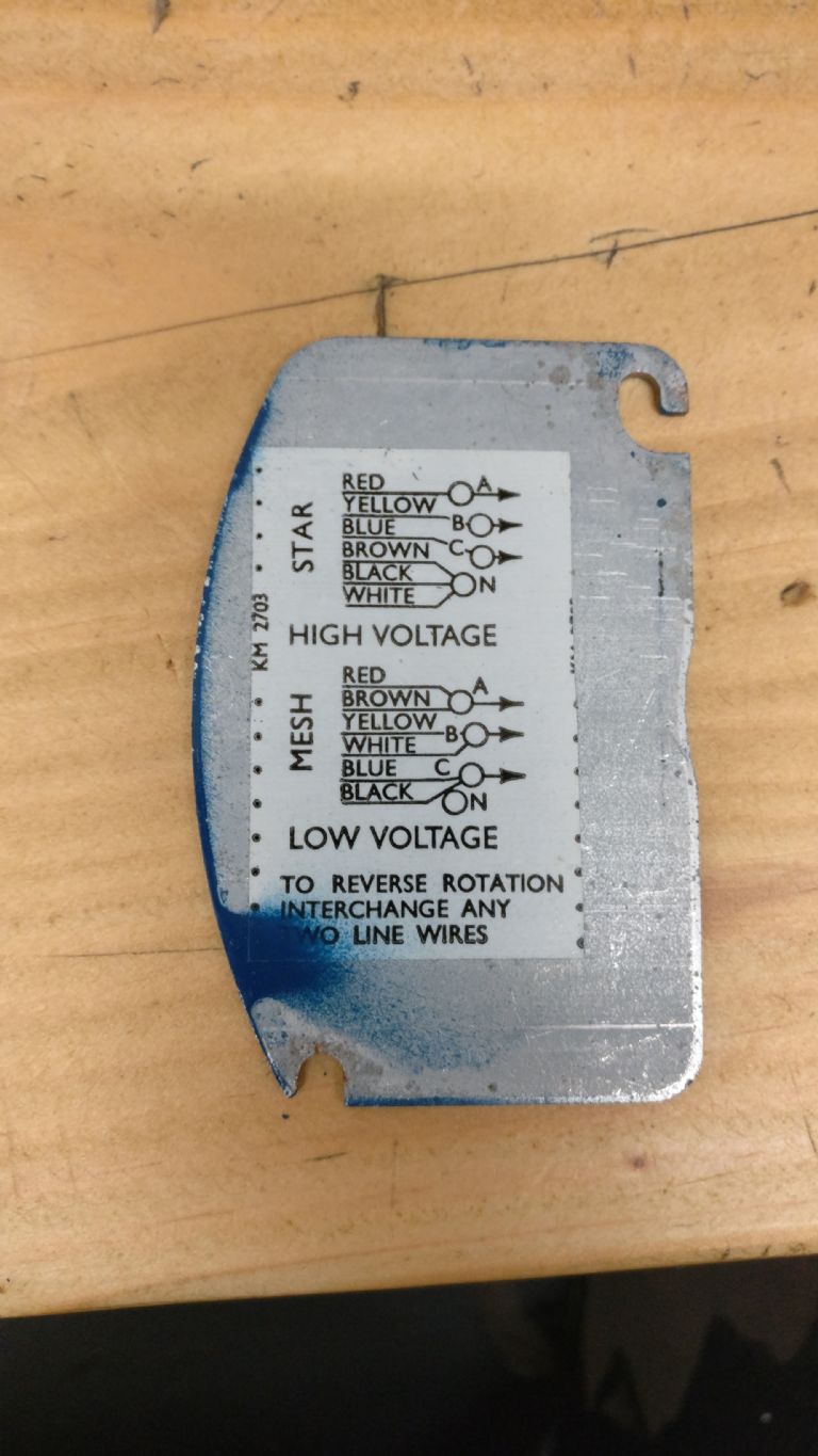

                  #270051
                  Michael Bird 1
                    @michaelbird1
                    Wiring info:
                    #270056
                    Antony Price
                      @antonyprice56876
                      Hi
                      I think you are right… its currently connected as star 415V and for 240V needs connecting as mesh/delta, so
                      A : Connect Brown to Red
                      B: Connect White to Yellow
                      C: Connect Black to Blue
                      Leaving "N" vacant.
                      Check if "N" is earthed to the metal of the motor, if so it can be your VFD earth, if not make a sepaare earth… Before you make live, check that you have an open circuit between AB BC and CA. and also AN BN and CN If the motor goes the wrong way round change the rotation via the VFD, by "swapping" two of the wires round
                      Hope this helps
                      Tony

                          #270065
                          Andy Holdaway
                            @andyholdaway
                            Posted by Antony Price on 05/12/2016 16:48:20:
                            You shouldn't have an open circuit as stated above, you will measure the resistance of each of the three coils, which will be half of the resistance that is between A, B and C when connected in Star.
                            Andy

                                          #442363
                                          john fletcher 1
                                            @johnfletcher1
                                            Michael Birds picture is a good clear one, showing what is required to convert from star to delta. N is definitely not the earth connection, that was the star point when it was star connected. The program for the inverter can easily be altered/ adjusted down for lower currents rating of smaller motors. Better to get a larger than needed in the beginning than wish you had latter. Some of my friend have bought Huanyang inverters for under a £100 each and no one has had any problems with them. One is more than five years old and still going strong.John
