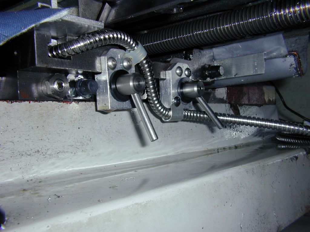

      The prospect of fitting DROs to my VMB is becoming attractive. I have powered feed on the table X axis. Trying to fit the measuring without drilling holes (non-invasive?), yer man fits the X measuring sensor onto the holes reserved for the limit switches of the powered feed – what he calls "reuse holes tapped for the old table feed end-stops." This is fine if you have no power feed.
      Has anyone devised a different, non-invasive way of fitting the kit on the X axis of a machine with power feed? I suppose I could manage without the end-stops but maybe can do better, or become invasive.

            Like Martin, above, I, too have a VMC mill (Warco). Not dissimilar to yours and employing a similar table design. I fittted the X-axis read head bracket to the holes originally used to mount the power feed stops as well. However, by extending the mounting bracket and fitting an "outboard" strip of steel, suitably milled, I was able to retain both power feed and table stops. Perhaps a picture, albeit not a very good one, would explain it better. I've added it to the story line in my album, but place it here for you to look at.
            I was able to retain the original Y-axis table stop mechanism by re-mounting it lower down the table. You can just about see it in the picture above.
            Hope this is of use,

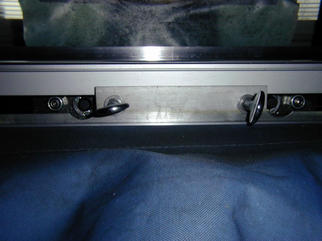

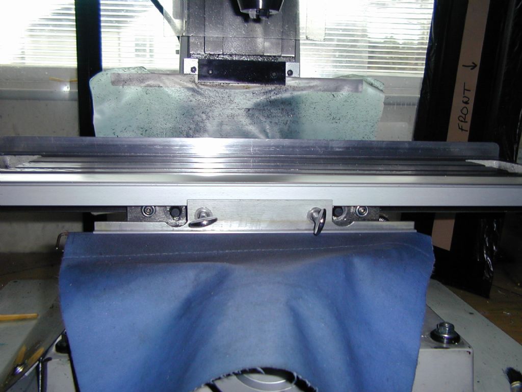

              006.jpg003.jpgI fitted a DRO to my Myford VMB a few years ago. It was a bit fiddly to get everything in the right place and I had to drill a few holes in the machine to fit the scales.001.jpg
              #209000
              Douglas Johnston
                @douglasjohnston98463
                With the X scale at the front of the mill table I had to extend the table lock screws so that they could be reached.
                Doug
