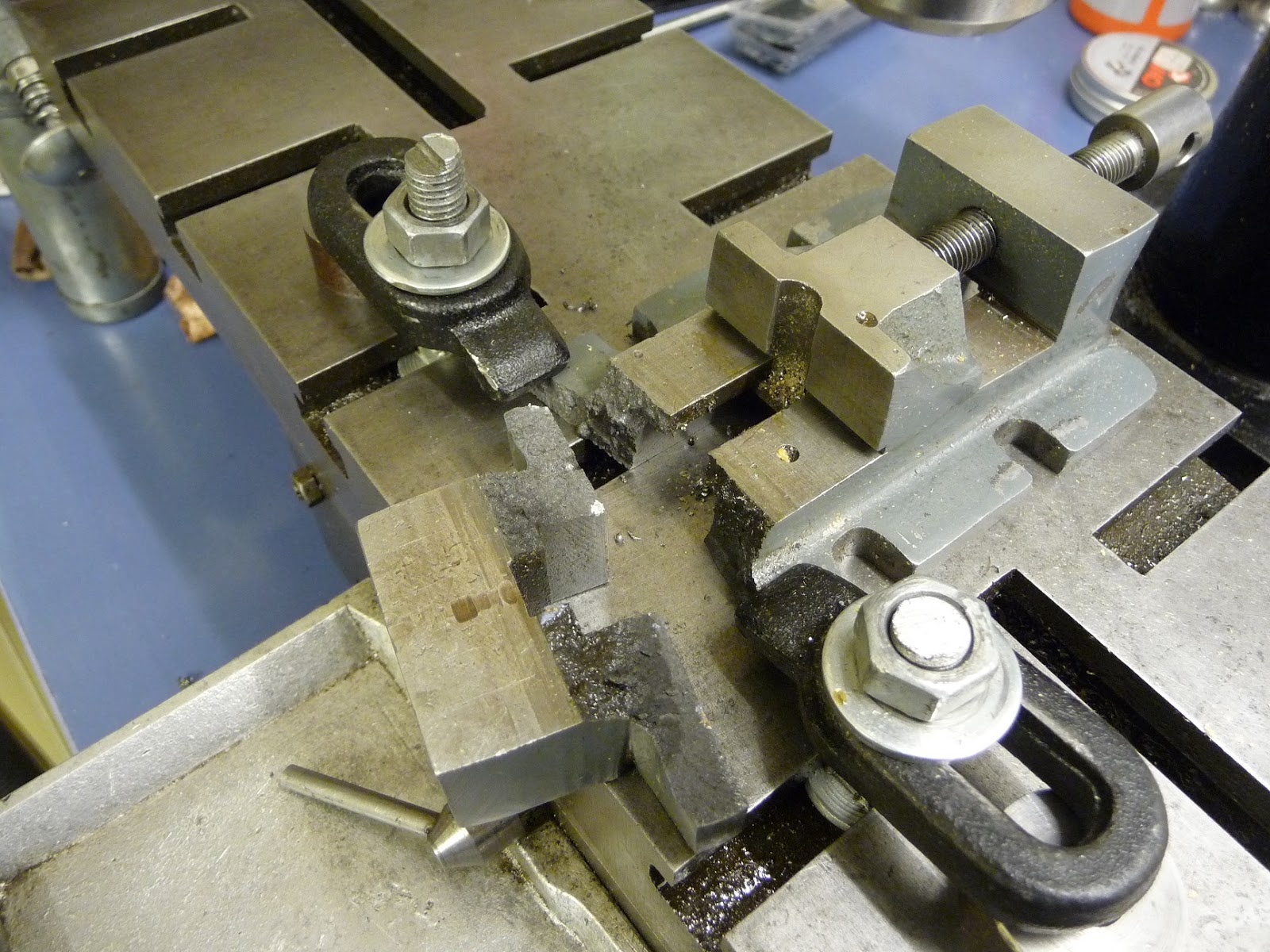

            #418774
            Mick B1
              @mickb1
              Posted by JasonB on 14/07/2019 06:58:40:
              Image from Here
              Gordon Bennett – never seen owt like that before. Can't see either radius or undercut in that corner.
              I still think a radius raises some 'fitness for purpose' issues. I've never noticed one on any vice I've used, and if I ever buy another, I'll make sure it's like my current one and allows datuming off a square-cornered flat located against fixed jaw and vice floor.

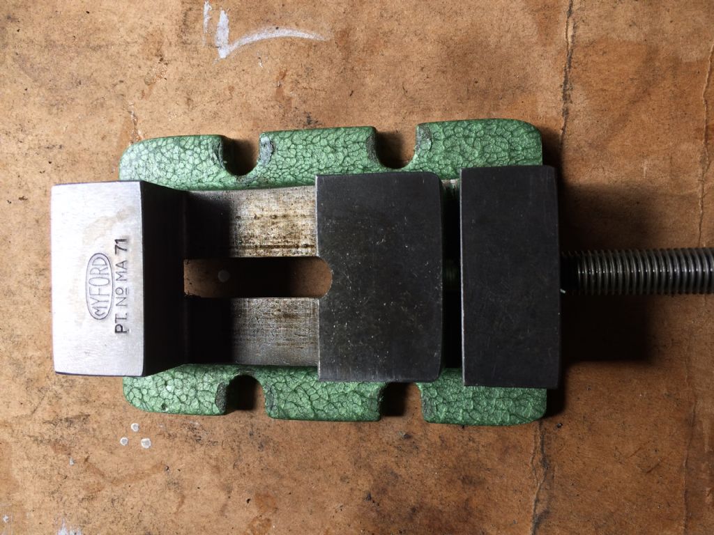

                              #418925
                                I've had two vices have the fixed jaw pop off. One was a cheap angle vice which had a massive blowhole in the casting, the other was a middle-quality vice, but its lever-camlock design allowed far too much force to be put through it.
                                #419020
                                Mike Donnerstag
                                  @mikedonnerstag
                                  Another view of my vice, showing the part number:
                                  #419035
                                  Mick B1
                                    @mickb1
                                    Looking at that pic, I'd want to make up two strips of steel flat with suitable holes spaced for those mounting slots. I think washers would force the t-bolts too far out for comfort.

                                    Mike Donnerstag

                                          #419240
                                          David Standing 1
                                            @davidstanding1
                                            Image from Here
                                            I am willing to bet good money that that vice fractured solely because of the local point loading of the way it was clamped down. I cannot imagine any reason whatsoever why I would ever want to clamp a vice in that fashion! surprise
                                            #419273
                                            Howard Lewis
                                              @howardlewis46836
                                              Very occasionally, I use a three way vice like the one above, for milling. But only when there is no alternative. The jaws are so far above the base as to "wave around in the breeze" unless you are gentle.
                                              They have their uses, but at the expense of rigidity.
                                              With regard to Jason's broken vice, the fracture was probably caused by excessive clamping force against the fixed jaw, rather than how it was clamped to the machine. Tightening the moving jaw against the workpiece, and the fixed jaw, imposed a tensile load on the base, greater than the material could withstand.. Cast iron is not elastic, like steel, being strong in compression, but not in tension.
                                              Howard

                                              Mick B1
                                                @mickb1
                                                Posted by Howard Lewis on 16/07/2019 15:49:15:
                                                Howard
                                                I thought that too, but what amazes me is that any tommy bar that could fit through the 'ole in the 'andle could be strong enough to deliver it!

                                                #419492
                                                Howard Lewis
                                                  @howardlewis46836
                                                  A screw thread can deliver enormous loads. The mechanical advantage is a very high number. Think how little real effort is needed to jack up a car.
                                                  You can crack cast iron quire easily with a 1/4 BSF thread., using just an ordinary spanner, without recourse to tubular extensions. It wasn't the Tee slot that cracked, it was the Cross Slide.
                                                  Take my word for it! I wanted a long Cross Slide anyway
