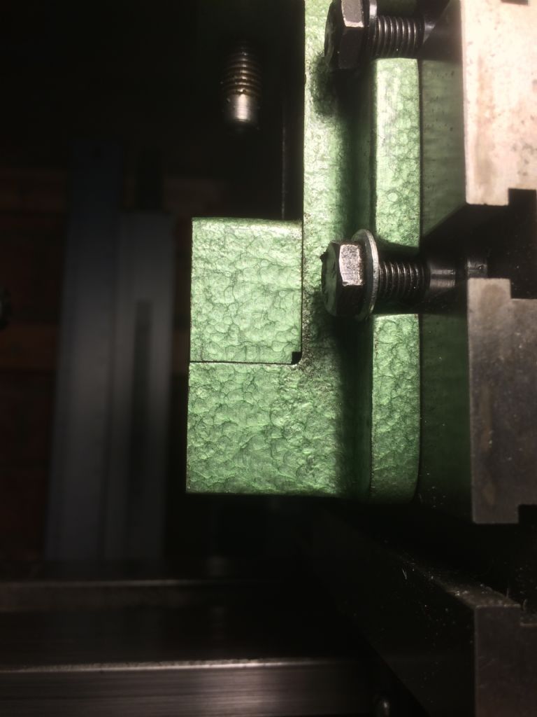

      I have an original Myford small vice for the vertical milling slide. I wondered whether anyone else has had a problem with the fact that the base of the fixed jaw has not been machined square but instead has an arris that pushes any square-edged material out of the vice slightly when the jaws are tightened. I was hoping to use the base of the vice as a reference surface. Am I wrong to expect to be able to do this?
      Does anyone have an easy solution to this? Am I missing something?

                          Apologies to all, I had obviously misunderstood the word 'arris'. Next time I'll stop trying to be clever and use common English!
                          The photo below shows the radius at the base of the fixed jaw. I have been using packing, though I have no accurate parallels, so I expect the accuracy of the setup will be compromised. Would it be a good idea to run a narrow slitting saw at 45deg into the corner to remove the radiused section? Using a radius gauge, I found that the radius at base of the jaw is about 1/16". I'm surprised that Myford did not machine this truly square, or is this a common occurrence on machine vices?

                            The small radius in the corner is probably for stress relief, I would call it a fillet! You could fix a secondary jaw in place if you can drill a couple of holes through the fixed jaw (or even glue it) permanent packing. Many vices have replaceable jaws, you could even make a set with horizontal and vertical grooves for holding round stock.

                              I guess that's an internal arris
                              I'd go with the slitting saw idea, I can't imagine there would be a problem with stress unless you're really overtightening the vice. If it's a worry then wouldn't a very small round nosed cutter (at 45 degrees) make a nicely rounded clearance cut?

                                I like the idea of the round nosed cutter, which I assume would 'spread out' any stresses in the corner. I also like the idea of the replaceable jaws, though it would reduce the capacity of the vice. Does anyone have any photos of their own modified Myford vice? Or perhaps a better alternative vice that fits the standard-sized milling stand.

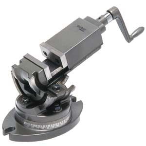

                                I also have a Groz 3-way swivelling vice, something like this:
                                However, the centres for the bolt holes won't fit the standard milling stand. Does anyone have any thoughts on this? Is it simply too big to be used for milling on the Myford?

                                    As an aside, I suggest using washers with a larger outside diameter to secure the vice. The washer under the top bolt is tipped into the slot. To work properly, the washers need to bridge the slot, plus a bit. There is probably a formula. You may need to put a flat on the side of larger washers. Or drill two holes in a strip of metal. Or whatever arrangement takes your fancy.

                                      Alan Vos: You're right – I hadn't noticed that! I will find or make more appropriate washers for the vice. Many thanks.

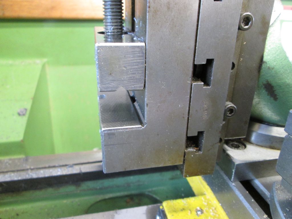

                                        Seeing that radius at the base of your fixed jaw – from a firm like Myford – surprises me.
                                        Here's mine:-millingvice.jpg
                                        I now don't think it's Myford as it has no name on it. It was clearly designed to fit Myford slides, though, from the screwhole spacing. It came in a blue plastic box – long since lost in house moves – and I bought it at the Olympia show in 2003 for about 20 quid, and it's served me well since.
                                        I thought all small milling vices were undercut like this to clear dirt and debris and ensure the location faces were definitive – to me, the radiused design looks like a bit of a rookie error.

                                          That looks far more like what I would expect of a milling vice! Comparing the photos also serves to illustrate that I need better lighting in my workshop!!
