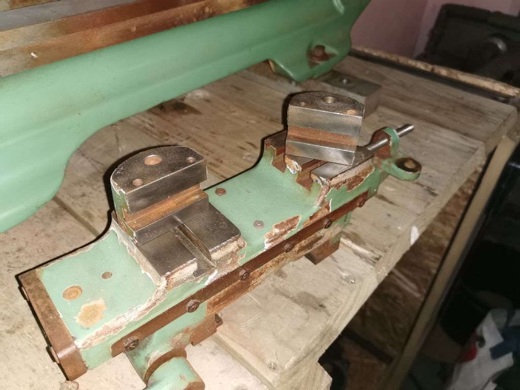

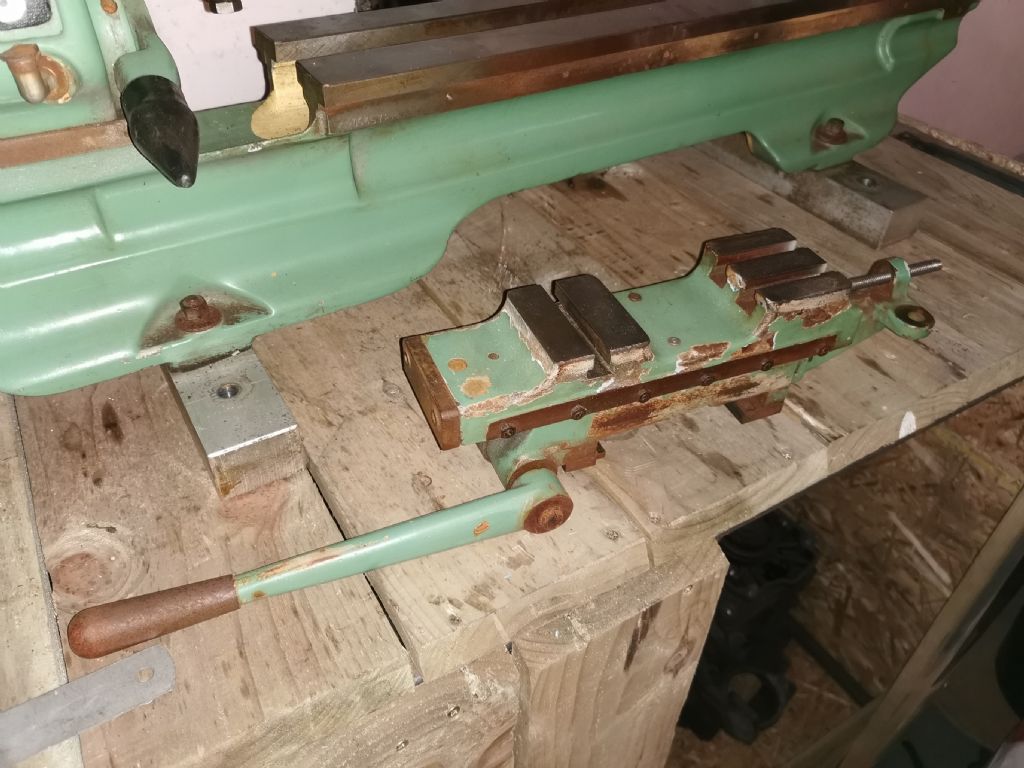

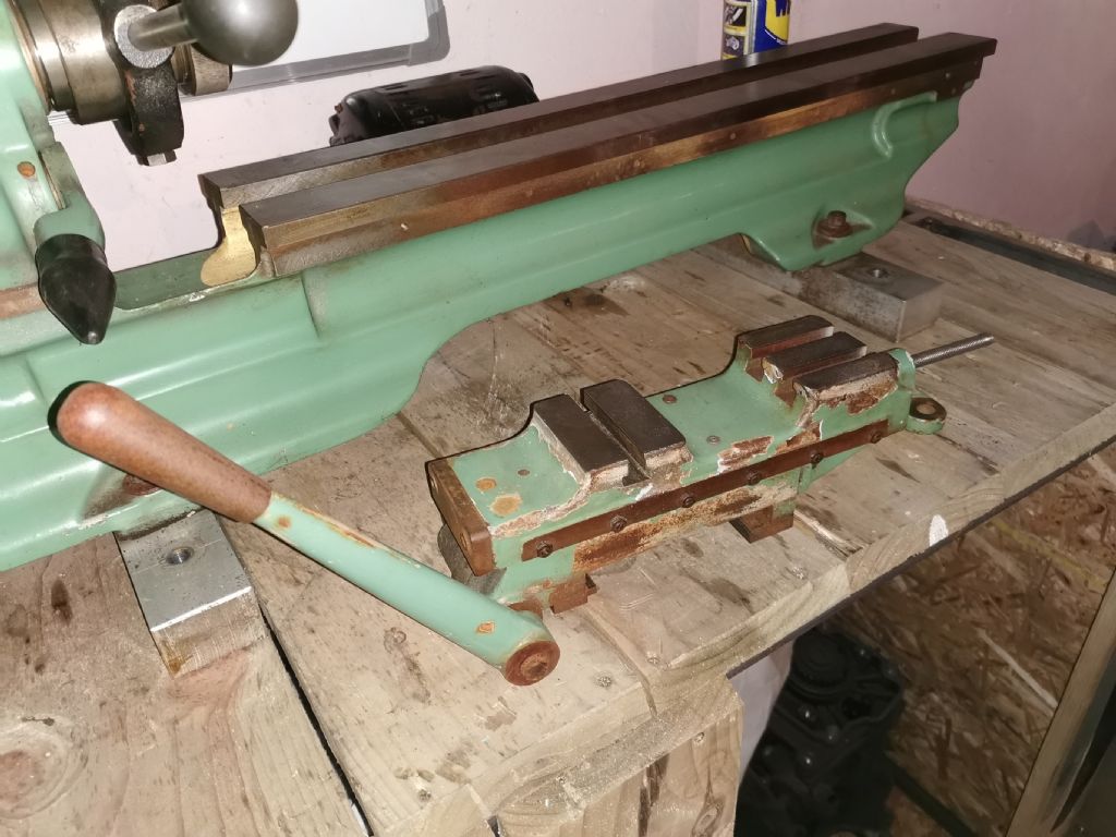

      I recently bought an ML7-R that had been modified for use in a factory in a secondary operation, the leadscrew and carriage assembly had been removed and replaced with a fixed side to side slide that is controlled by a lever. Anyone able to shed any light on what it is?

          Hello,
          It is a Myford cutoff slide with two positions for parting off material (one conventional and one as a rear tool post). I believe it to be the first such cut off slide, as it is lever operated. I have the later version which is wheel operated.
          Andrew.

            Thats brilliant, thanks Andrew,
            Given that it isn't driven in any way I'm guessing it's a fit and forget sort of deal for cutting repetition

              Yes it is set up for repetition work. If I were you, I would sell it, as they seem to fetch a good price and use the cash to help reinstate the saddle and tail stock.
              If it has been used from new for a secondary operation then the bed should be unworn!
