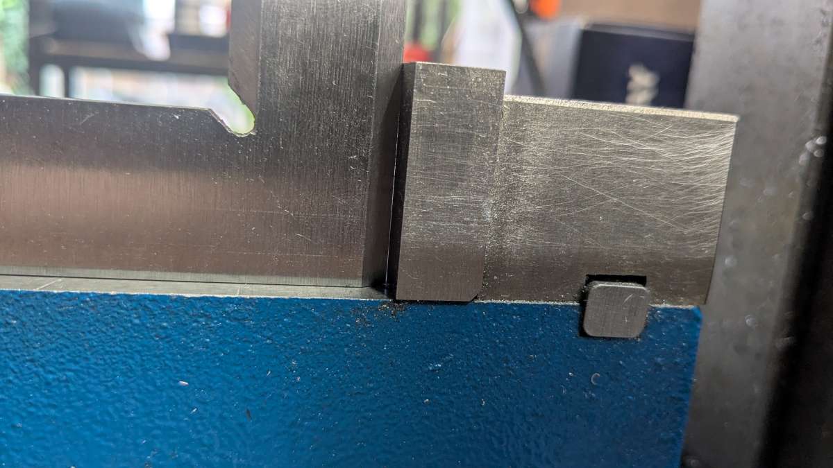

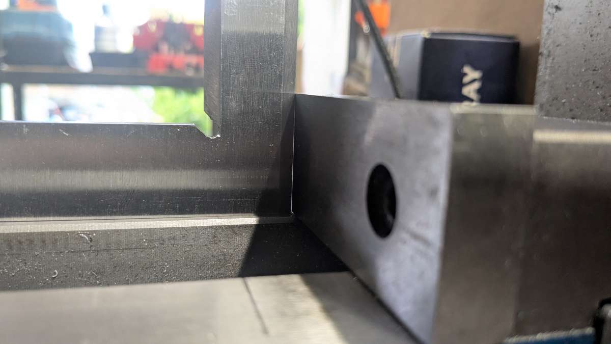

      So I have a cheap vevor vice on my mill, it’s the 4″ model and until today I was quite happy.
      I noticed today that things just aren’t coming out square, not good. So I broke out the DTI and got to work expecting to find something out of tram.
      However I found this:
      PXL_20250719_193800898
      PXL_20250719_193710653
      I know there is debris on the vice but no amount of wiping clean changed things, I really do believe it’s out square.
      I am a novice at this sort of stuff and I don’t have the cash to go get a top end vice. Where do I begin in rectifying this issue.
      Thanks

        if the jaws are parallel in all planes then a very light cut from the body should improve things
        #807980
        David George 1
          @davidgeorge1
          If you measure the gap with feeler gauges remove the jaw face clean and stone the faces and put some shim betwen the jaw and the slide or fixed body which can be held in place whilst you replace the jaw with a little grease. It will remove any play in the jaw. Have you checked that the bolts in the strip which holds the slide down are tight as well before checking squarnes.
          David

              This is kind of what I expected, I’m just double checking on the best way to go about the repair.
              My idea was shimming, I’ve taken the jaw off and can’t believe how bad the casting is under it.
              They are still a bargain vice though, other than this error which is fixable I do like it.

                    Clamp a Parallel bar in the vice. Then see how much out of square it is. It may also be possible that the rear jaw base, is not clean or some other issue or bur etc. Edit,  to clarify, the fixed Jaw needs to be investigated.

                      I personally think shimming is a waste of time for something that is going to do a lot of work ,far better a permanent solution by by machining dead square and vertical. Also check all bolt holes are well deburred.

                          According to a reliable contributor on one of the Practical Machinist Forums vices the fixed jaw on vices with that general style of bolt down mounting tend to lean back slightly at the top under clamping loads. Apparently even proper professional vices, such as Gerardi, can have a small, but still measurable when Inspector Meticulous is in full supercharge mode, deflection. So things may not be so bad under load. Pop something in it and use a lever indicator to see if things shift.
                          Obviously you have checked that the jaw plate is parallel and true.
                          What is the alignment of the moving jaw like?
                          If the moving jaw is true and the fixed jaw block seats well enough on the body consider applying smear of JB weld or similar metal loaded filler on the fixed jaw body before loosely inserting the jaw plates and lightly clamping the vice up squiggling excess filler out whilst bringing the jaws into mutual alignment. Grease or cling film on the jaw plates will do as a release agent. Its not quite that simple as some extra clamping will be needed to ensure the moving jaw doesn’t lift.
                          If they are both out a 1-2-3 block in the middle should work to do them both simultaneously.
                          There is a certain art to clamping when doing this sort of filler-in-place alignment as the moving reference parts need to be held tight enough not to lift yet be loose enough to slide. Stiffly.
                          Shimming is effective but can be a certain trial on patience. I never seem to have the right thickness in metal shims. The colour coded plastic shim sets are pretty good but they do have a mild tendency to squidge under serious loads. Which may be helpful for fine tuning.
                          The major issue with these inexpensive vices tends to be moving jaw lift. For conventional screw drive vices there is no substitute for accurate, close tolerance, manufacture if the vice is to work reliably and accurately. Pull down “acculock” devices can help but fundamentally these are the cherry on the top to make a well made vice work even better. On inexpensive products they invariably require fettling to work well and there are limits as to how much they can compensate for the less accurate fitting inevitable on a vice made to hit a low price point. As ever you get what you pay for and ordinary folk like us have to accept that when making £1 do the work of £5, or even £10, something must give.
                          I’ve long considered that treating a inexpensive vice as a casting kit to be converted to Chick pull down forwards or Gerardi push from the top of the back moving jaw operation might be a decent way of getting a better vice than you can directly afford. Basically slap a piece of gauge plate on top of the original base and have at it. The Chick pull rack looks do-able, an external screw to pull via a cross piece is far simpler than the internal arrangement o the real thing ought to work well enough. The pin through a hole locator for the push screw block on a Geraldi style is easier to make than the proper spring loaded ball in dimples albeit slower to use.
                          Clive

                            Since you have the jaws off I would check that the vice base is in tram first or it throws the square measurement off.

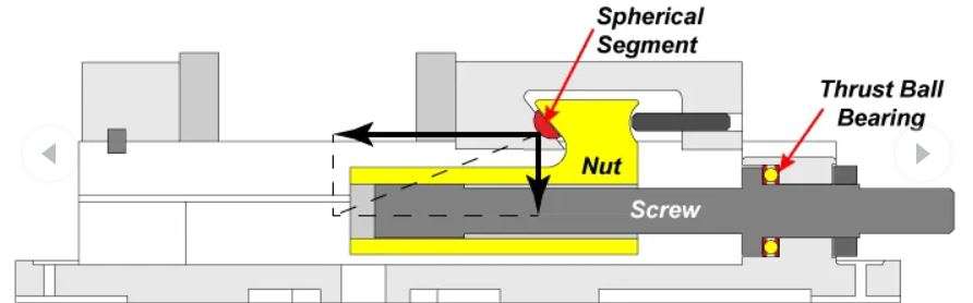

                                  John, this vice is a copy of the well known, respected and expensive made in USA Kurt vises, where the fixed rear jaw is indeed bolted to the base.

                                    I had a similar problem on my offering from Arc, mostly went away when I got the fixed jaw ground parallel.

                                      Well tonight I fiddled around with it for an hour or so. The base is bang on tram in the Y direction.
                                      While rough, the fixed jaw body is also pretty good and not a million miles out.
                                      The jaw face itself is parallel and I cannot pick an error out with a mic.
                                      The moving jaw is also square.
                                      I did find a bunch of oil and even tiny bits of swarf behind the jaw face itself though so I gave everything a blood good cleaning and deburred the rough face with a stone. This has improved things somewhat but it’s not 100% perfect.
                                      I ran a bit of scrap aluminium through the mill too to see if things improved, after facing 4 sides I’m still not cutting 100% square. This might be the excuse I need to pick up a surface table and get to the bottom of this or am I just better off finding a better vice…
                                      I’ve got more time to play tomorrow where I intend on getting to the bottom of this.

                                        I may have missed it, but there’s no mention so far that the spindle of the mill has been determined to be accurately aligned to the reference surface of the vice. Forwards ‘nodding’ or backwards ‘leaning’ spindles are common…
                                        Also, just what should be chosen as the ‘reference surface’ of the vice? It’s the base, if the workpiece is seated firmly, as it should be. As has been suggested, the slight inwards lean of the fixed jaw will grip the workpiece OK (provided that the moving jaw doesn’t do naughty things – hence use a roller), and any lean may be abolished when the vice is tightened (everything’s ‘made of rubber’). Obviously far better than an outwards lean.
                                        If the face of the fixed jaw is taken to be the ‘reference face’, then it had better be spot-on with the vice relaxed, for setting up, and remain spot-on when the vice is tightened, which is going to be expensive – and unlikely, although with a massive vice, the error should be acceptably small. Better to trust the base as a reference.

                                          As Kiwi Bloke says the moving jaw is generally the issue when you have holding problems. Especially so with an inexpensive vice where making something the customer can afford seriously limits the production line attention that can be given to component fits.
                                          Accurate holding from an affordable device has been a perennial machinist problem since about 5 minutes after the first machine vice was made! As mentioned above interposing a roller on one side of the job so the sketchy area contact from an inadequately aligned jaw is replaced by well defined line contact is a simple, effective and time honoured work around.
                                          But it doesn’t suit all jobs and the extra loose part is a pain to hold.
                                          Making your own jaw plate with a groove to hold the roller in place is an effective, relatively simple, way to make life easier. Clearly not a permanent fix but at least you can get on with making things whilst sorting out the ultimate solution. A dab of grease to hold the roller ould be good.
                                          Maybe a block of soft alloy with two opposite sides parallel coated with blue could be used to investigate exactly whats going on has the vice is tightened. Basically inspect after suitable fractional turns of the handle as teh vice is tightened to see where the contact areas are. Needs to be something rigid but touch squidgy. A dial gauge on to to indicate any lift would be useful.
                                          Given the angle of your fixed jaw you already have contact at the top of the work helping to hold it down. Generally any slackness in the moving jaw pushes the contact point down towards the bottom of the jaw. Hence the familiar tendency to lift the work and need to beat the job down onto the vice base or parallels.
                                          Back in the day many vices, mostly production orientated types, were made with a vertical slope of the back fact of the jaw plate generating downwards force when tightened to pull the job down. Obviously the jaw plate wouldn’t have been dead tight because so sort of stiff sliding movement would be needed. Gerardi and other makes of expensive, professional market, machine vices still use this system so it’s likely to be of some value.
                                          I wonder whether something similar could be devices as a bolt on retrofit for inexpensive vices suffering from moving jaw lift. Two jaw plates with opposing tapers would be needed. One firmly affixed to the vice moving jaw mount and one just a tad looser so it can slide. Presumably some sort of lift spring would also be needed so the actual gripping jaw had somewhere to slide.

                                            These particular vices have an angled arrangement anyway to help keep the moving jaw down, some people like to smooth the spherical joint a bit more but the one I regularly use seems OK.
                                            angleloc

                                                  My mill does have about 2 thou of nod for which there is no adjustment and as it’s one of the mills designed to bolt onto a lathe (it’s a Chester Champion 16) it’s going to be difficult to shim.
                                                  Using the base as a reference makes sense, with the videos I’ve seen online about squaring stock it’s always the fixed jaw people talk about being the reference but I always make sure my parallels are tight so I guess I am actually referencing the base when I think about it.
                                                  I shall recheck the tram of the mill tonight, although I did do this last month when cleaning everything.

                                                    When squaring stock it IS the rear fixed jaw you need as the ref face. Any face resting on the vice base or parallels will be parallel to the surface being machined. You want to be machining at 90deg to a previously machined surface hence the rear jaw as that is (or should be ) at right angles to the surface being machined.
