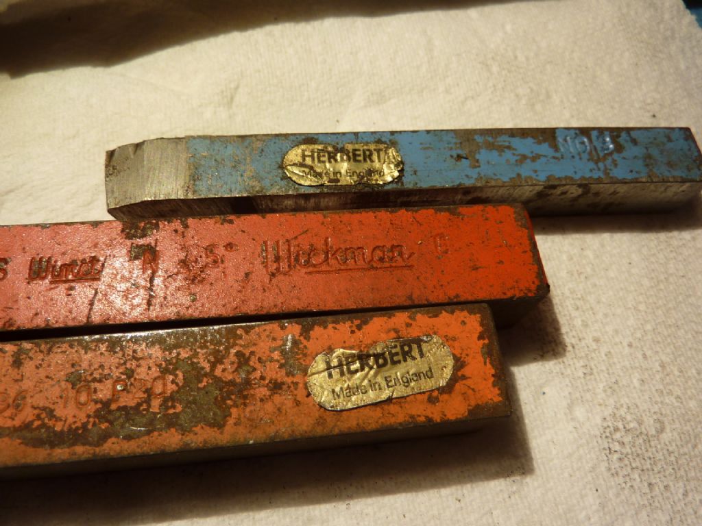

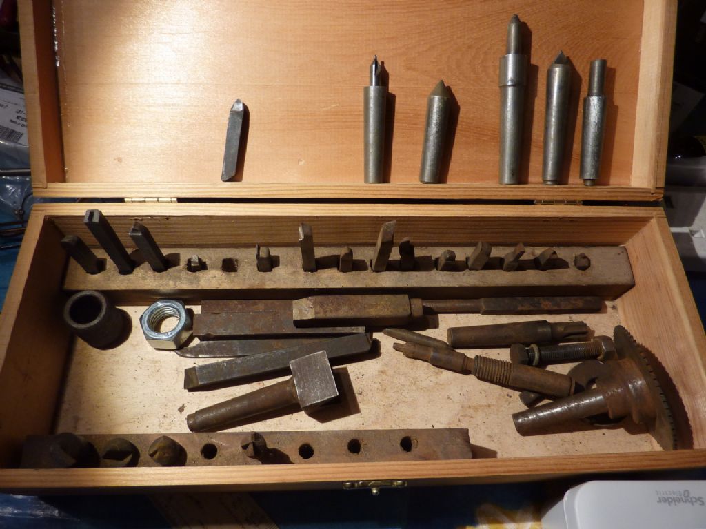

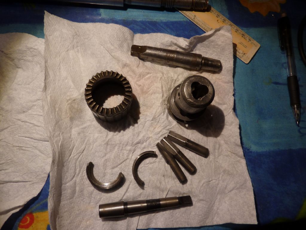

      The smaller bits of tooling came in a nice wooden box. Some have had a bath in citric acid to get the rust off but there are plenty more to do.
      I'm guessing the black tools are carbon steel?

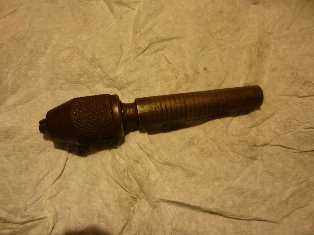

      How to hold 1/4 inch or so tools in the old school tool holder on the lathe is another question to resolve.
      There were some drills and centre drills loosely mounted in morse taper arbors. This puzzles me… how would they stay put when used?
      This was the only drill chuck…
      It may find a use but it's not the best so my thoughts turned to a box full of rusty tools that we found when clearing out my late father in law's garage. It probably belonged to his father. In there was a Jacobs No 32 chuck on an MT2 arbor. It has clearly seen a lot of action but the jaws don't look too bad. I managed to persuade it off the arbor (someone else had already drilled through the body) and have sourced an MT1 arbor, so hopefully this will be more suitable

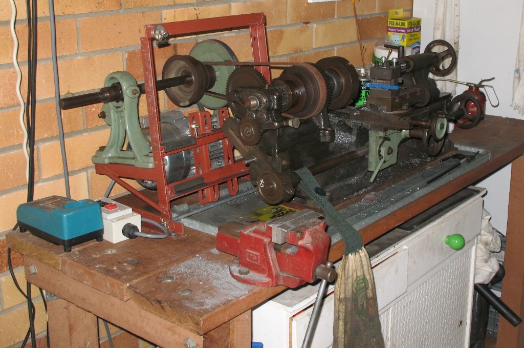

        Just came across this thread, saw the photos of the motor arrangement, its a bit like the arrangement on my Ideal lathe except that I assembled the motor and layshaft into a sub-unit that hinged at the bottom and used the weight of the motor and layshaft to tension the flat belt. Works pretty well with enough 'grip' for decent depth of cut and feed rate without overstressing an old machine, but if I get too ambitious (or something goes wrong) the belt just slips.lathe set up 001-rc.jpg

          I like your countershaft pedastals – very 'in keeping' with the lathe. My setup at the moment is just a small change from the previous owner's setup (using the same parts) which lacked any means of adjusting the flat belt tension and the vee belt can only be adjusted by moving the plumber block bearings up or down the slots in the angle iron. 'In keeping' it aint!
          The previous owner never really used the lathe so I expect that my setup will prove unsatisfactory in real use but at the moment I want the lathe up and running and will worry about making a better setup later on. It has at least managed an easy test cut with the belt tensioned just by friction with the not inconsiderable weight of the motor and lathe keeping things in place.
          I completely agree that slipping belts are a good thing – it's good to have some sort of 'safety valve' because things DO go wrong.

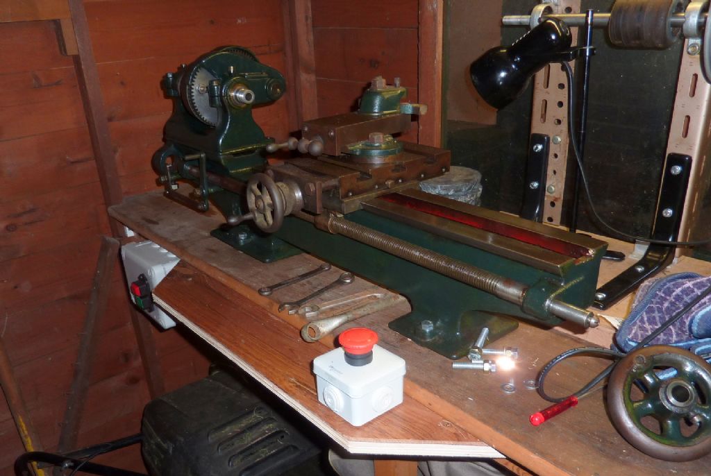

            A little progress update on the installation. Over the bank holiday I got the bench braced, the lathe bolted down and some electrics installed. Plenty more to do yet, hence the absence of the motor and tailstock from the photo.

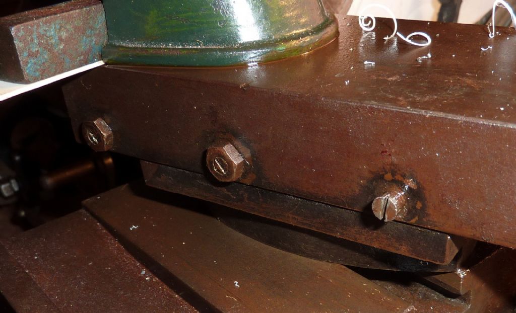

              Most but not all of the bits have been off the lathe. The headstock has been dismantled and some minor galling on the spindle cleaned up. Surprisingly the spindle bearing bolts were just finger tight. I have snugged these down but they are probably still on the loose side because there is always the worry of going too far and breaking the casting. I've seen some suggestions to put shims in the gap. To the best of my knowledge this is not the right thing to do when the bearing housing is only split on one side but it would be good to know if my knowledge is correct here.
              All of the gibs were quite sloppy so all of the screws have been out, freed of crud and refitted. Actually, all bar one… One of the screws on the compound slide is different from the others and won't budge. My guess is that its threads are cut a bit shallow. I've tried WD40 and clamping the head in an ER16 collet to get plenty of torque on it but so far no joy. It's not causing an immediate issue so I have decided to apply a further coat of thinking to this screw.

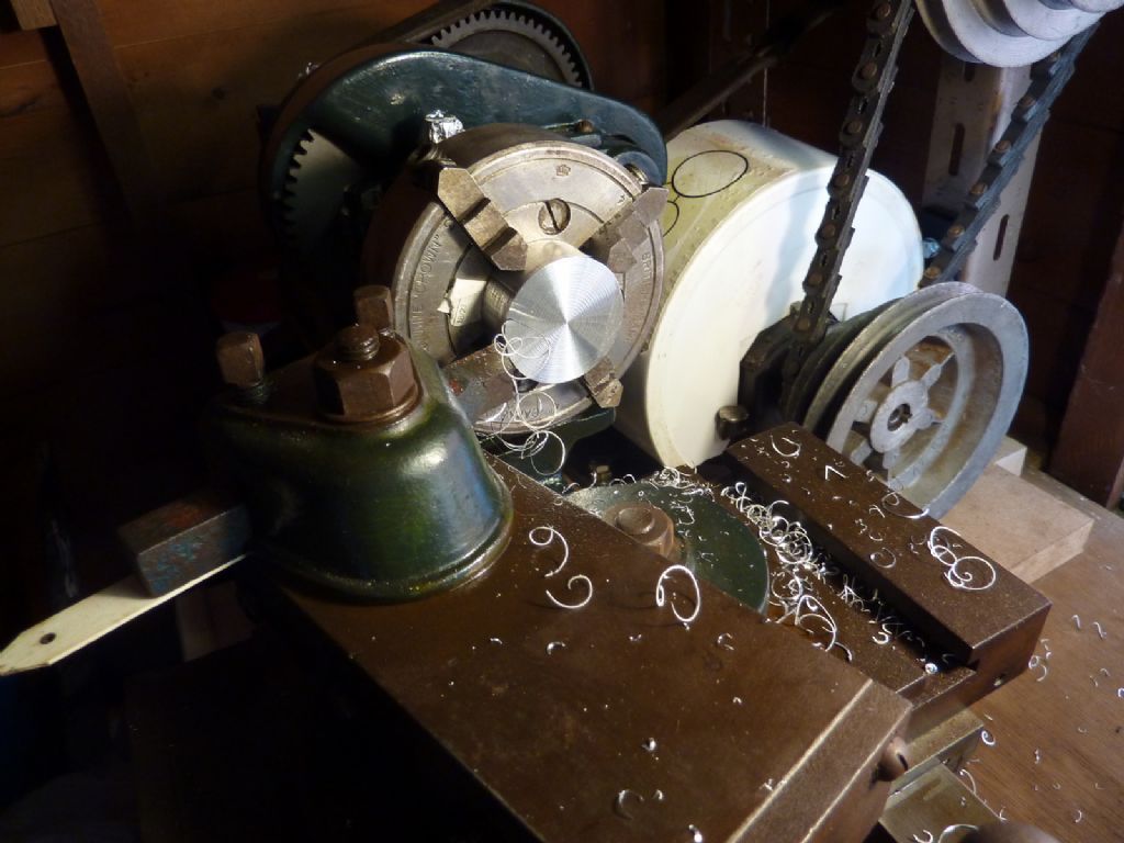

              The first real job is an aluminium handwheel cup for my MF70 CNC conversion. The first operations are to face off my horrid hacksawing and then turn down the end to make a stub to engage in the shaft coupler. I'm using the big ESC tool bit for that but found it was maybe 0.5mm above centre which was tricky since it was clamped to the top of the compound and there was nothing I could remove to make it lower. After rummaging around the immediate area in the shed I found a bit of plant pot label and used this to shim the tool underneath just the rear clamp screw. Not pretty but it got the tool onto the centre height. Other than using a less agricultural material I can't think of a better answer just now because the top face of the tool has obviously been profiled during manufacture and I would be very reluctant to lose this.
              The next operation will be boring out a blind hole for the handwheel on the other side. This may prove tricky – I have an Arc Euro 6mm boring tool that could quite happily to do this on my Cowells lathe but I really want to try to do it on the Faircut. Whether I can mount the small tool on the Faircut or else find another way remains to be seen.

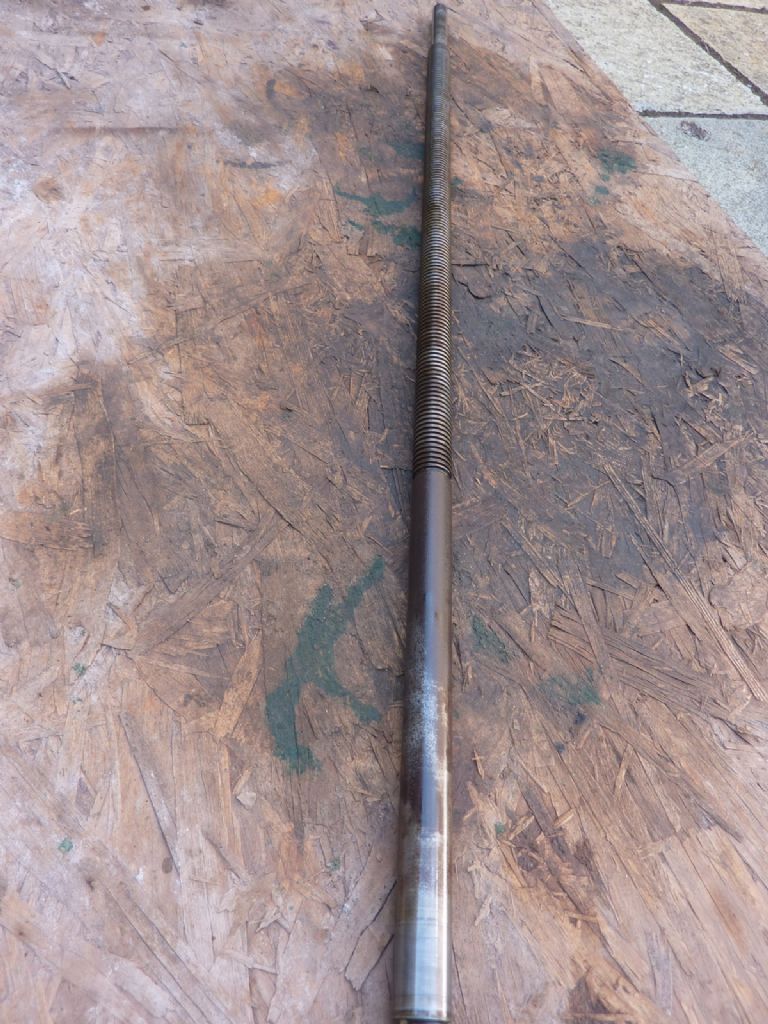

                    First job was the leadscrew – having a brown lead screw was really annoying me and having found while turning the handwheel cup for my MF70 CNC conversion that the leadscrew was stiff to turn at some parts of its rotation. I didn't need much more of an excuse to pull the thing out for cleaning. I'd describe the previous finish as polished rust and it proved quite resistant to being shifted using my usual recipe of citric acid. After several applications and scrubbing with a brass brush and a plastic kitchen scourer I ran out of time. It's a lot better but it still has 'freckles' and I will probably need to have another go.

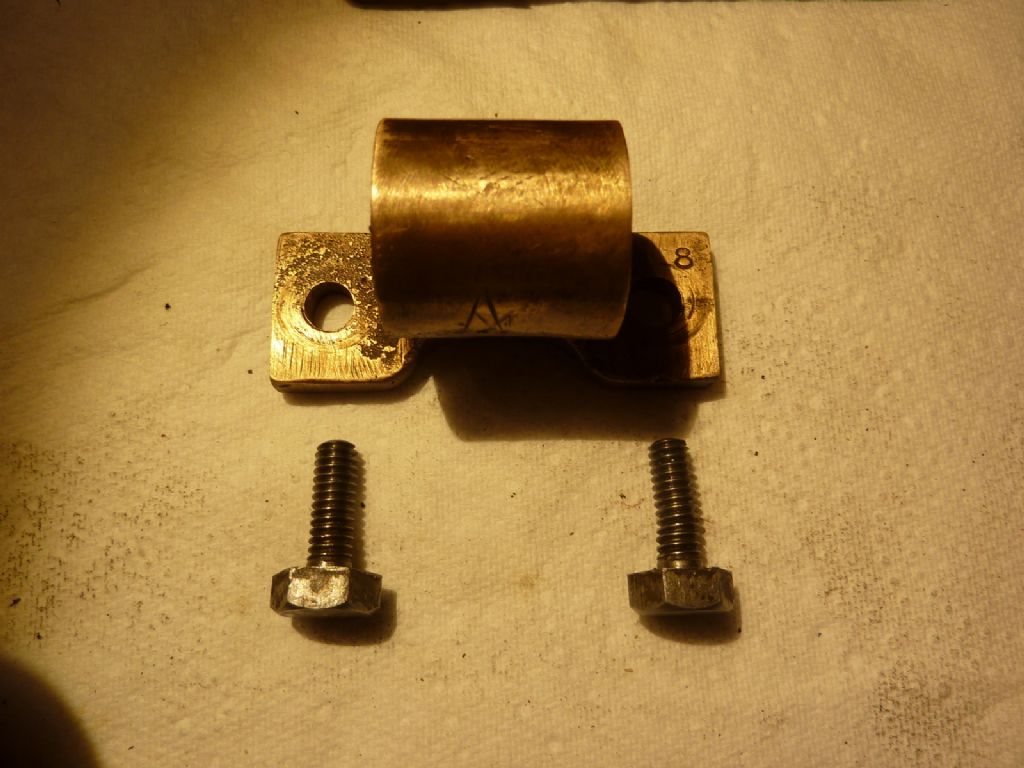

                    The leadscrew nut was also off for the first time since I got the lathe. If one of the bolts looks like it is kinked then that's because it is. I wonder what happened here – there seems to be no corresponding indentation in the hole in the nut. Very odd! I'm now in the market for a 1/4 BSF screw with a pre-war size of hex head. So far I have not found a source selling screws with the pre-war head size. Any ideas?

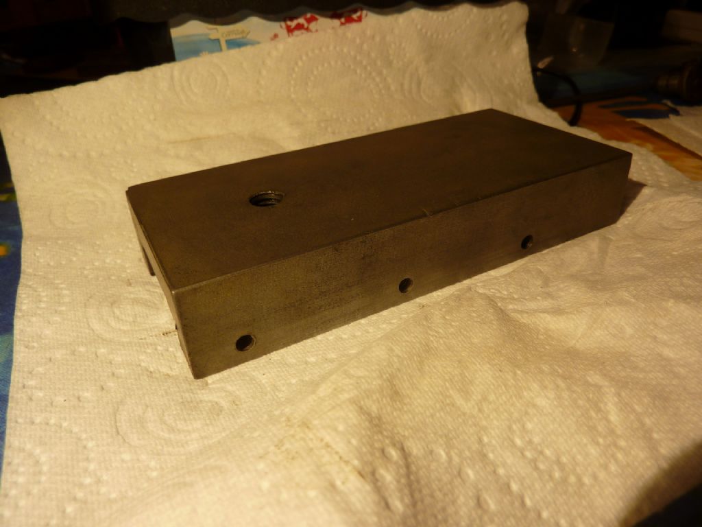

                    In better news I finally shifted the stuck gib screw out of the compound slide. After several days of trying WD40 I bought a can of an American product 'PPB Blaster' from eBay. After about 12 hours with this stuff the screw finally yielded. I think it's the correct thread but the thread peaks feel very rough. It's going in the bin and I will make a new one… which also means I'm in the market for a 3/16 BSW lock nut with the pre-war hex size.
                    Having relieved the compound casting of all of its fittings, I treated that to some citric acid today. I was expecting another protracted struggle but the rust came off very easily compared to the leadscrew.
                    I bought some more tools from eBay. When they arrived I found some more names from the past. Interesting for me because my Dad worked as an external grinder at Herberts. Wickman is another famous Coventry name.

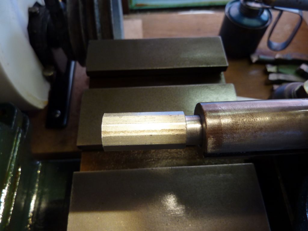

                            I got around to doing some more measurements on my tapers, this time by making some bars of known diameter and measuring how far they go in. The results are pretty clear and don't make happy reading.
                            The basic setup is as per the photo – I used one of my die holders from the Cowells as a 'pusher' and then measured between the spindle end and the die holder using vernier calipers. I also measured with a ground piece of tool steel bridging the taper bore to get a starting datum for each bar.
                            I took several measurements and reset each setup a few times to reduce any errors.
                            I won't try to post tables of numbers on here but after doing the maths, I got the following
                            Headstock taper: 1 in 24.1
                            Tailstock taper: 1 in 20.9
                            Now there is plenty of room for error in the making of my bars and the measurement setup, but it's clear that these numbers are miles apart. I re-checked them after I did the sums
                            and while the actual numbers may be subject to doubt, the difference between them is not.
                            Most of the measurements came out very similar for both headstock and tailstock but one did not namely how far the smaller bar entered each taper. The difference is obvious in the two photos below.
                            MT1 should be 1 in 20.04 so both tapers are shallower than they should be which agrees with my observation that a hopefully reliable Jacobs arbor only grips at the fat end.
                            The headstock number is pretty close to a Brown and Sharpe taper. I have no idea where and when B&S tapers were used but the fact that the tailstock taper is closer to MT1 rather persuades me that the headstock taper is just plain wrong.
                            So now what? My guess is that the headstock taper at least is too far wrong for the finishing reamers sold by the usual suppliers to rectify it.

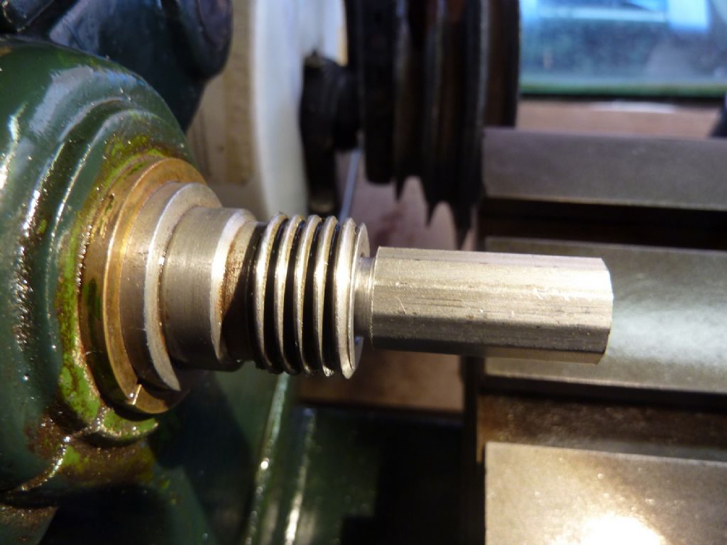

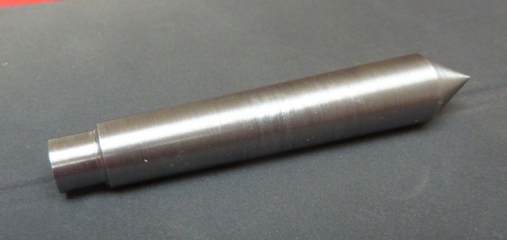

                                            Yesterday evening I turned up a new soft centre to the measurements I'd taken from the headstock taper.
                                            After some trial and error I think I hit the calculated taper angle to within the accuracy that I can achieve but that might still not be the right answer…
                                            The pointy end was turned down with the centre in the headstock once the taper had been done. Once I was past half way through this process I found that the centre was regularly breaking loose and it became rather a frustrating exercise for a while.
                                            As the job progressed I spotted a problem – the cutting tool was slightly above centre (in my defence, bear in mind that up to this point I only had MT1 centres that did not fit the spindle properly and had visible runout at the tip). I corrected this and was able to complete the pointy end without any more breaking loose. I also pop marked it so that I can put it back in the spindle in the same position next time.
                                            So how well does it fit? Initially it seemed to grip very well but the breaking loose did not inspire confidence. All of that mucking about has, however burnished the turning marks to show me where it is gripping and where it is not. The result surprised me a little.
                                            The taper is roughly 2 inches long. At the thick end there is perhaps 1/4 inch which is inside the spindle taper but has not burnished. Then about an inch that is burnished. The remaining part of the thin end has much less burnishing.
                                            This result puzzled me – I was expecting it to grip at either the thick end or the thin end depending on whether my angle was to steep or too shallow… but in fact it is gripping in the middle and at neither end. My theory to explain this is as follows…
                                            The actual machined taper in the headstock is shallower than the taper on the centre but repeated use of MT1 tooling by a previous owner has worn the first 1/4 inch or so into a steeper taper. The upshot of this is that my measurement inside the taper was also wrong because the 'fat end' measurement was measuring inside the worn part.
                                            At the moment I'm thinking that having an inch of the fattest usable part of the taper engaged is not so terrible for a dead centre so I'm not intending to have a second attempt. This should at least allow me to accurately set tools to centre height and do a much better check on the tailstock alignment than I've been able to manage so far.
                                            The tailstock definitely aims low – that is clear from the behaviour when centre drilling but my previous attempts to check the alignment with two centres was inconclusive.
                                            Given my conclusions about the state of the headstock taper I will abandon any thoughts of making a drill chuck arbor to fit. It will either be a collet chuck on the spindle thread or else re-machining the taper to MT1. I have no plans to attempt to machine the taper though until I have had a lot more practice at machining tapers accurately.
