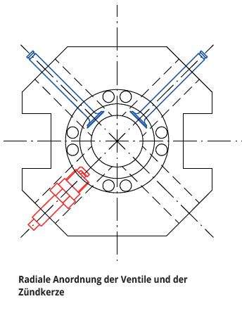

      Building an engine with a verticle cylinder with two opposed pistons.The cylinder head is octagonal with valves ,spark plug and compresion adjuster at opposing positions around the cylinder head.The depth from outside of the cylinder head to inside of the cylinder is 25mm,what i need is to know the distance from the bottom of the plug to the inside of the cylinder to give a good ignition please.

      #730336
        It can vary quite a lot from engine to engine, some I have made have the tip of the plug right inside the combustion chamber others the plug is in a completely different casting and 40mm or so from the chamber.
        Can you not use the image in part 1 to give you an idea of where it should be

        #730365
        Hopper
          @hopper
          Generally speaking, it is a good idea to have the sparkplug located so the cool intake charge passes over it and cools it off. If you put it next to the exhaust valve, it will get overheated by the exhaust gasses flowing over it.
          Found that out on old sidevalve motorbike engines with the sparkplug in one of the screw-in valve access plugs above the valve head. Get the access plugs mixed up and put the spark plug above the exhaust valve instead of inlet, the sparkplug will have a short but heated life.

            Jason,I will take your advice and having worked out a scale to fit the drawing ,I get 6mm but to ensure the top of the plug clears the bore I have increased it to 7.5mm .
            Hopper,I find what you say interesting,the inlet is opposite, would you think this is correct.
            Thank you both for your assitance.

            #730548
              Position is probably irrelevent on a model engine like this you are not going to be using high revs for any length of time as a bike or car engine would

                Knowing nothing about what engine you are building, I could not really say. If you are working to an established design, best stick with that.
                That said, if the valve opposite is the intake then I suppose the incoming charge will be directed generally at the sparkplug, albeit perhaps somewhat masked by the valve head itself.
                As Jason says, probably not critical on a model running short demonstration runs under no load. Bit different from a vintage motorbike engine lugging up mountain roads dragging a couple of hundredweight of bike and rider along.

                  Directing the incoming charge at the spark plug definately makes starting easier.

                    If possible, recess the spark plug as little as possible. It will be accessible to the cool incoming charge, and will require less advance to ignite the charge. (Shortens the path for the flame front to heat and ignite the full body of the charge) Obviously, you cannot have the plug body or its points from fouling the piston

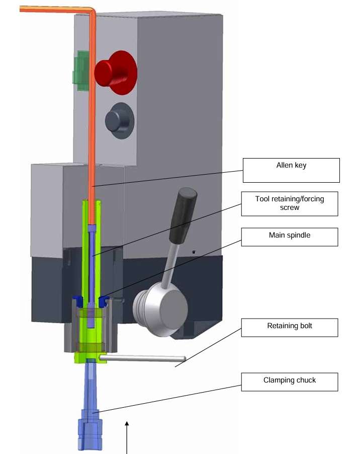

                      Hello, this is my first time of asking for help here, so please bear with me.
                      I have a Wabeco 1210 mill. For virtually all its time I have kept it fitted with the MT2 collet chuck that I bought at the same time as the mill (many years ago). I decided to remove the MT2 collet holder (chuck) and fit an MT2 drill chuck for a job I have coming up soon. The issue is that I cannot remove the collet chuck. Wabeco hold the MT2 collet chuck in place with a special Wabeco draw bar. The bar has a RH thread on both ends, one end screws into the MT2 taper end. The other end of the draw bar with larger diameter and finer thread screws into the top of the quill. According to Wabeco instructions they say just turn the draw bar in an anticlockwise direction by inserting the special hex key (quite long) into the hex socket on the top of the draw bar and push with some force to loosen the MT2 socket which can then be undone by hand. Needless to say I cannot undo the draw bar. I have applied so much force I am starting to bend the hex wrench. Does anyone know if it would be possible to turn the spanner flats on the MT2 collet holder. my view is it would not be possible as the MT2 is not moving at all. Anyone ever had this issue, cause I cannot see a way out at the moment. Cheers.

                      Robert Atkinson 2
                        @robertatkinson2
                        If the drawbar won’t loosen you certainly won’t be able to turn the Morse Taper fitting.
                        You could try running penerating oil down the drawbar.
                        Other options are to heat the MT chuck. Ideally use a hot air gun (paint stripper) rather than a flame. It will take time to heat through. Next you could use a proper long hex impact key with a impact driver. Even the hammer type would do but lower the head so the chuck rests on a metal block on the table. This will increase the force on the screw and protect the bearings.
                        Robert.
                        #799562
                        Robert Atkinson 2
                          @robertatkinson2
                          Follow up on the above.
                          As there are two different pitch threads on the drawbar if it was tighned when warm it will tighten excessively when cold. So penetraing oil down the tube the long hex key goes into is the first port of call. For heating the quill would warm and lengthen before the draw bar making it tighter. So you would have to let mild heating, say 50 60 degrees with the quill extended soak through so the drawbar gets warm then cool the quickly cool the quill tube with ice packs or similar to shrink it while trying to unscrew the drawbar.
                          The design is very prone to locking up through over tightning. You can’t turn the mosrs taper until the joint is broken. The taper is designed to lock in place so you can’t unscrew it from that end.
                          Robert.

                            #799577
                            Robert Atkinson 2
                              @robertatkinson2
                              I don’t think wedges will do anygood against an M10 drawbar.
                              Penetrating oil both ends first. Measure the depth that the key needs to be to reach the hex head of the drawbar. Then buy a long 8mm 1/2″ drive hex driver like this:
                              https://www.lasertools.co.uk/Product/8584/Extra-Long-Impact-Hex-Bit-1-2-inch-drive-8mm
                              and put a breaker bar on it.
                              Robert.

                                #799639
                                duncan webster 1
                                  @duncanwebster1
                                  I think there is some confusion. The present problem seems to be that the drawbar cannot be released, not the taper, although of course that could be next. If I’m correct no amount of tapping axially or wedges will help.

                                    #799669
                                    Peter Cook 6
                                      @petercook6
                                      Wabeco
                                      What a poor design. I suspect Robert A’s solution is going to be the most likely
                                      #799705
                                      Robert Atkinson 2
                                        @robertatkinson2
                                        For those who haven’t looked into the detail, the “tool retaining / forcing screw” a.k.a drawbar, shown in blue in the image from the manual kindly posted by Peter above, has two threaded sections. The first is a coarse thread that engages the Morse Taper fitting as is normal. The other is a fine thread on the head of the bar. They are both RH threads. This engages a long section of female thread inside the top of the quill. The idea is the drawbar is screwed to the bottom of the fine thread, backed off 2-3 turns. the MT fitting is inserted from below and rotated so it engages on the (non rotating) drawbar and moves up until it engages on the female taper. The drawbar is then rotated CW to tighten the MT.  This is bad on so many levels and open to all sorts of errors or seizures the could cause the symptoms of a locked drawbar.
                                        Given the long time since the drawbar was last unscrewed I betting on corrosion of one or more of the threads. Hopefully the collet chuck has a passage through so penetrating oil can get to the drawbar thread.
                                        Robert.
                                        #799971
                                        ChrisLH
                                          @chrislh
                                          Like Jeff220 I acquired a Wabeco 1210  many years ago. Whist the drawbar with differential threads worked it was very inconvenient to use as the fine top thread required a lot of twiddling with an awkward tool to accomodate the various lengths of MT2 tools I use. I also had a near seizure of the fine thread. Could this be the problem with unseating your MT2 shank ? Unlike Jeff220 my use involves frequent changes of tooling so in the end I abandoned the Wabeco design for something home made, more convenient and which didn’t risk seizure of the fine thread. Would not have pleased the accountants though, one component replaced by 5 !
                                          #800011
                                          Dave Halford
                                            @davehalford22513
                                            Jeff,
                                            As the mill does not have a wedge slot in the quill for removing a drill chuck you will need to make the parallel wedges anyway.
                                            I suspect ‘push with some force to loosen the MT2 socket’ might translate better as tap with a hammer.
