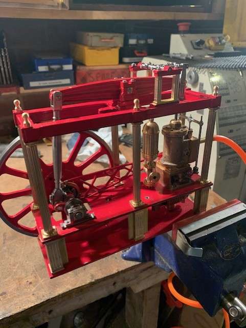

                Hi Derek, I never had the drawings. I took all of the dimensions from the build series and never had any issues. The only issue I had during the build was machining the Entablature due to very little excess material prior to maching. I was left with very little material for maching to size. Tomorrow I will go up the workshop and measure the position of the cylinder. I have attached a photo of Lady S I built. At this stage I had not finished the governor and a couple of other bits.
                Lady Stephanie 2

                              Hi Derek, as promised I checked the dimension’s of the cylinder and can confirm that it’s 2 1/2″ from the centre line. Also I put the beam horizontal and at the cylinder end of the beam the cylinder piston rod is perfectly in line with the centre of the parallel motion linkages and beam locating hole.
                              Hope this makes sense and helps.

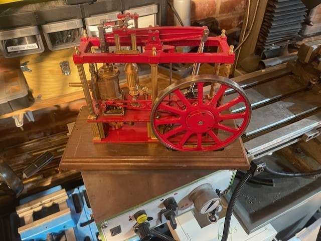

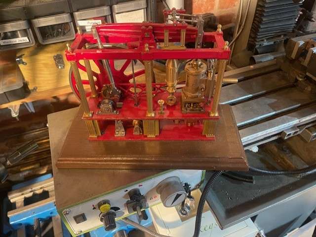

                                            Hi Derek, I mounted mine on a wooden plinth as described by Jason. I’m going up to my workshop now and will take a couple of photo’s of the plinth and the underside. Will post them tonight.
                                            Alan

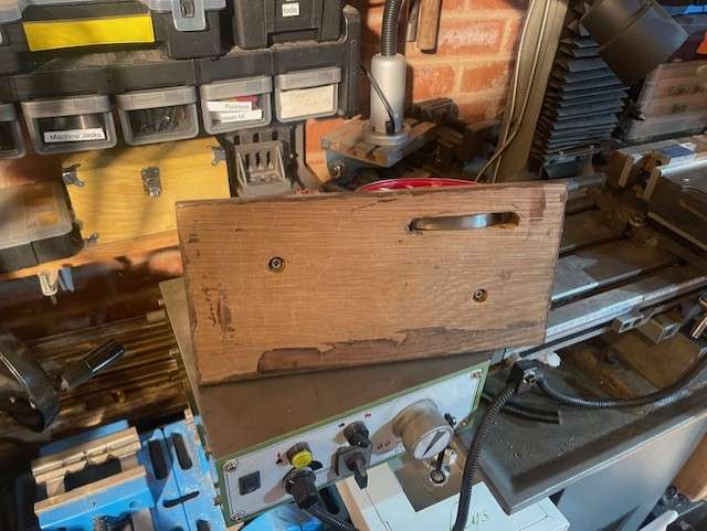

                                                Hi Derek, just come back from my workshop. I have attached some photo’s for you.
                                                Also in the text of the buildn series regarding the cabinet base, there are 4 holes 5/32″. In the text it refers to these holes as:- “four 5/32″ holes for the holding down bolts”. If you look at the left hand pillar in my photo’s you can just make out the head of the hold doen bolt. I only used two of the holes.
                                                Hope this helps.
                                                Lady S 1
                                                Lady S 2
                                                Lady S 3
                                                Alan.

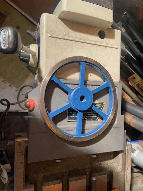

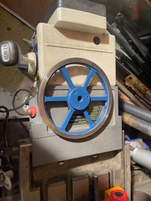

                                                    Derek, I forgot to mention that the flywheel is none standard. I happened to go into Aldi one day and they were selling small dumb bell weights cheap. £3 for 4 of them. So thought they could be machined into fly wheels, so I bought them. I have used 2 of them for fly wheels.
                                                    This is the second flywheel in question. I just need a project to use it on!!
                                                    Lady S 4
                                                    Lady S 5
                                                    Alan.
