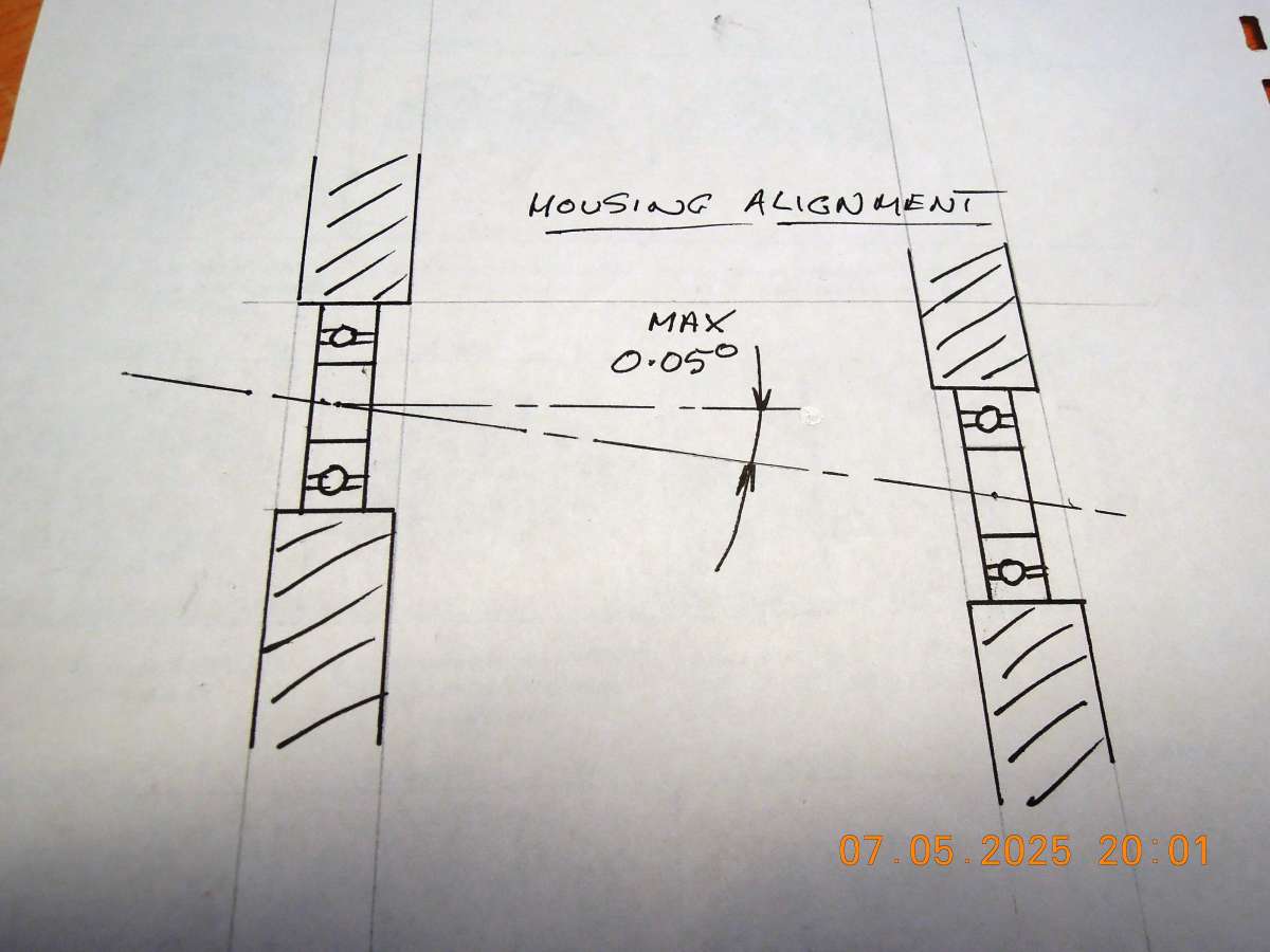

        Regarding housing alignment, this is what I’m referring to.
        DSCN1765
        Obviously the permissable lateral displacement depends on how far the housing are apart and can be calculated by simple geometry.
        In practical terms, Im not sure how you might achieve it because I haven’t yet studied the clock design! 🙂 I will try to do that shortly and come back you.

          Chris, I understand your challenge. I think my answer would be do it by good spigoting on your pillars.
          Make all the relevant holes with the small support plate glued or clamped to the back plate. (Don’t space the two parts and tram your mill first.) Ream the holes for good diameter and roundness.
          Then turn your pillar faces and spigot diameters between centres to ensure everything is as square and concentric as it can be.  Make your spigots good snug fit with the reamed holes in your plates. Clearances make position errors.
          Confirming you have achieved the required alignment between the two bearing housings in the finished assembly is a challenge for another day!

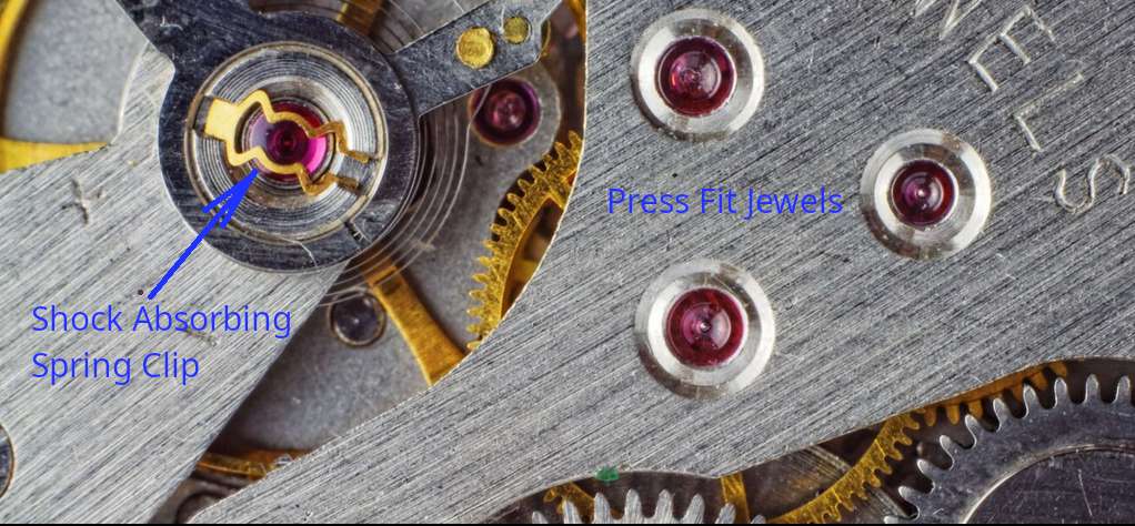

                The hole will need further cleaning.  This type of bearing requires a high-polish, otherwise the rough edges grind the steel part rapidly.  Ruby is carborundum, same as emery paper.  Polished in two ways:
                • Traditionally with successively finer grades of diamond powder.   Like emery paper, a succession of finer grades remove scratches left by it’s predecessor.  Might start with a 150 grit and end up with 3000.  Michael mentions the powder being applied on a Copper rod, which sounds right.
                • By passing a flame through the hole that’s hot enough to melt any raised edges.  I guess this would need a small Hydrogen / Oxygen flame.  Small torches and generators are made for jewellers, about £350, so  here’s a DIY design.
                Mounting.  Traditional jewels are pressed into a pocket.  I think press-fit is possible without ultra-precise machining because the jewels are thin enough to flex slightly.  As a thick home-made jewel wouldn’t flex, the alternative is some form of clip.  Most common in manufactured watches is a shock absorbing clip, good in watches because they get dropped:
                jewesl
                I guess the main problem with a home-made mounting would be accurately aligning the two ends – either by depthing, or by precision XY positioning with a mill.   Gut feel, by the time all the problems have been solved, might be cheaper to buy precision made commercial jewels.

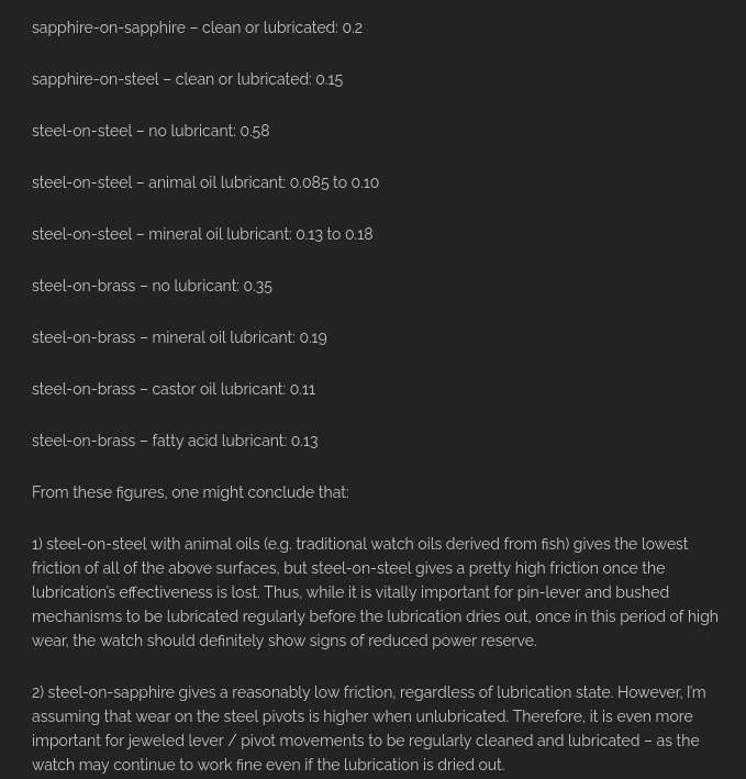

                Earlier I found this table of Horological Coefficients of friction with comments on the advantages of Sapphire bearings over Steel, and why un-lubricated steel on steel isn’t recommended!  Washing grease out of a bearing reduces friction briefly because grease is sticky, but then the steel starts grinding…
                horofriction
                Further investigation into jewels may be advised.  The table refers to Sapphire rather than Ruby!  Although they’re much the same chemically and both are synthesised, ‘Ruby’ isn’t simply a red sapphire.    Sapphire may be slicker than ruby, hence better for bearings…
