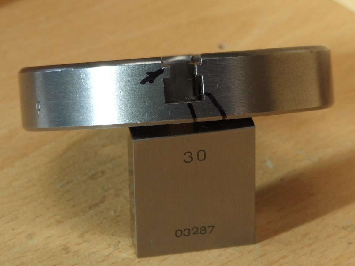

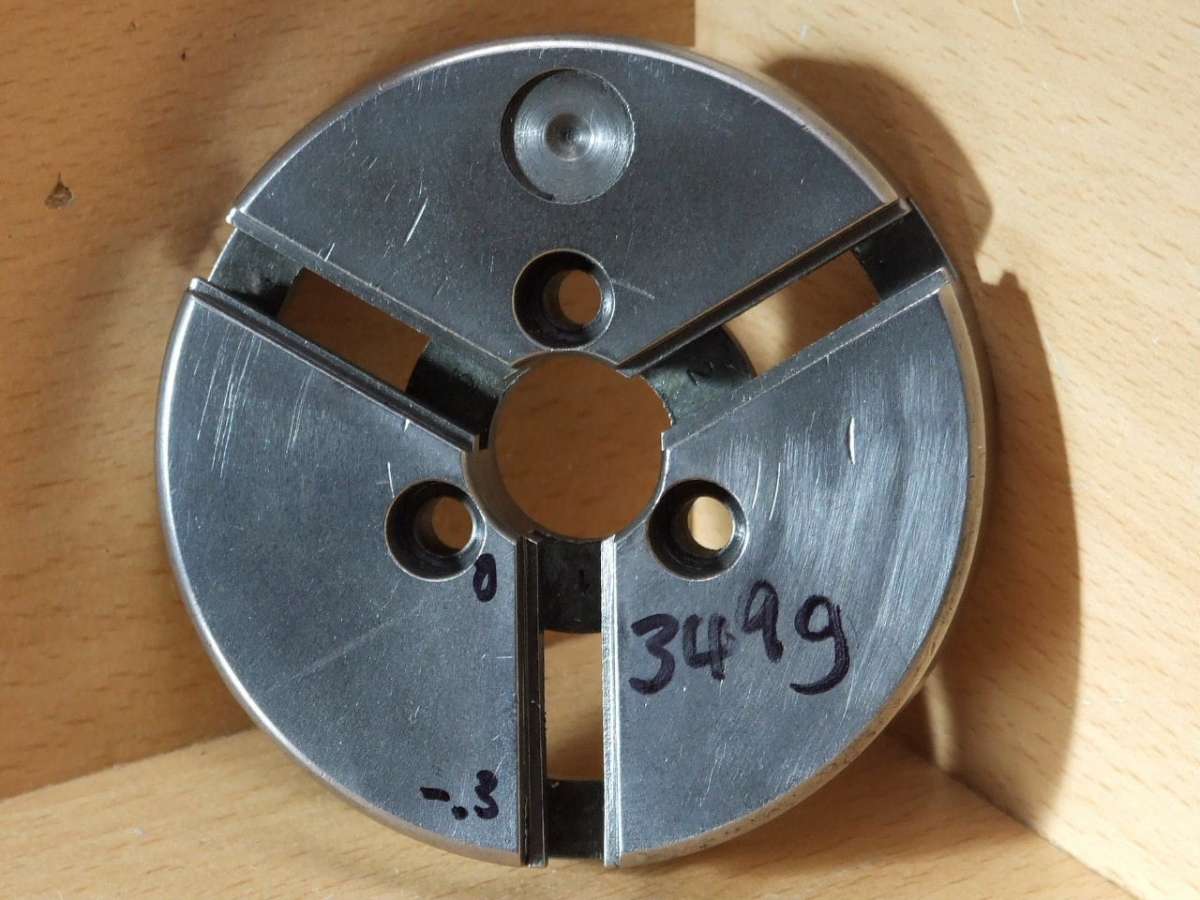

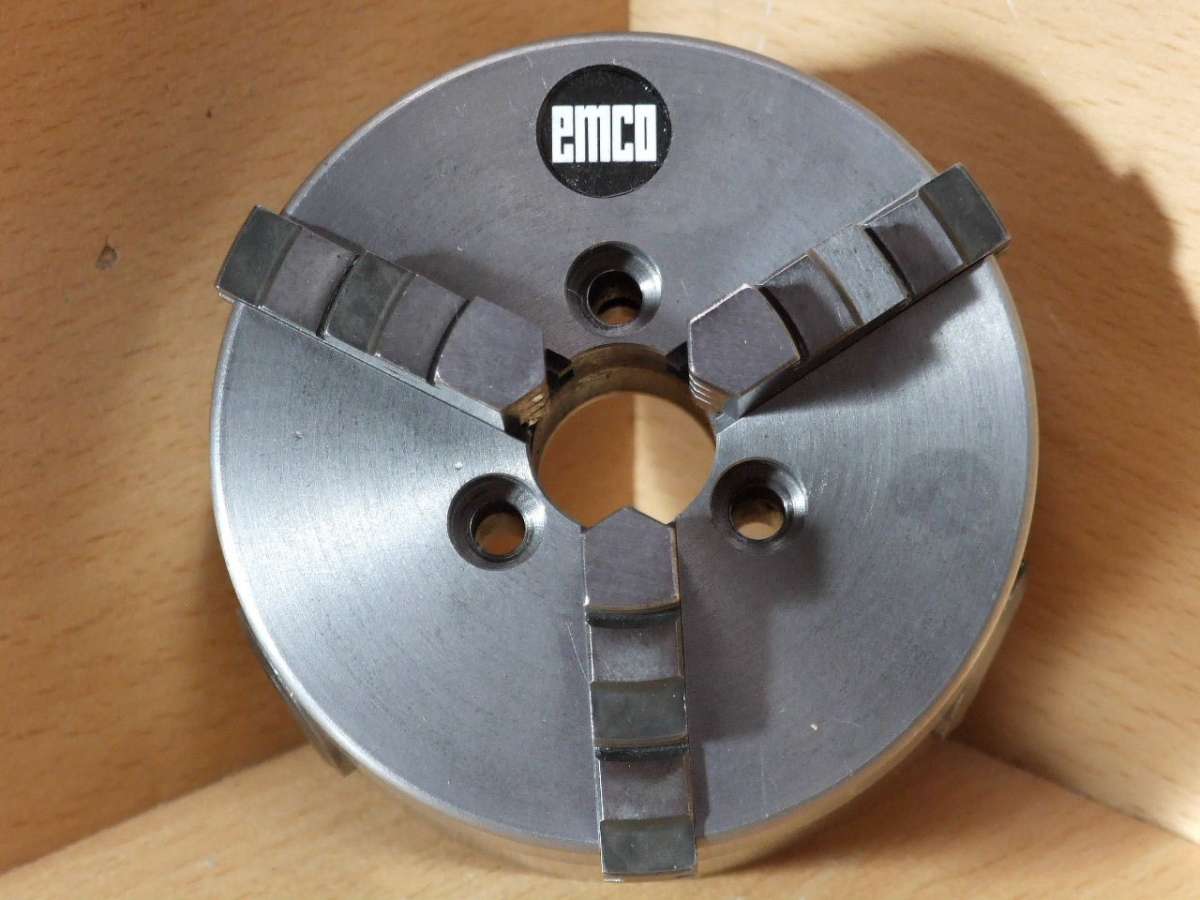

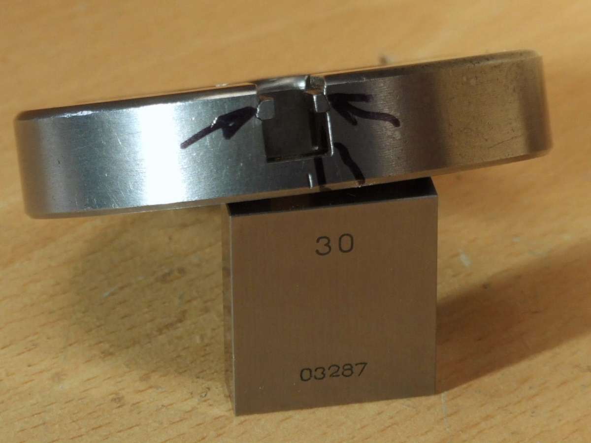

                                  There is a common misconception that the lathes with any hint of aluminium in their construction are not capable of any form of precision engineering.
                                  Damaged Part
                                  Areas of damage on No1 Jaw tenon
                                  Areas of damage on No2 Jaw Tenon
                                  The Finished 3 Jaw chuck
                                  My Emco Compact 5 recently turned a new front part for my recently purchased 80mm Emco chuck. The part above was machined from a 90 mm blank of Cast Iron with no problem at all. The finished item is open to any inspection as regards fit, function or run-out.
                                  The Proxxon PD 400 and the Compact 5 are of the same construction and capacity. Thus why do Proxxon machines have to be restricted to making toys and boats?
                                  You can see more work produced on the Compact 5 lathe and the Proxxon FF230 mill on my other two posts covering these machines.
