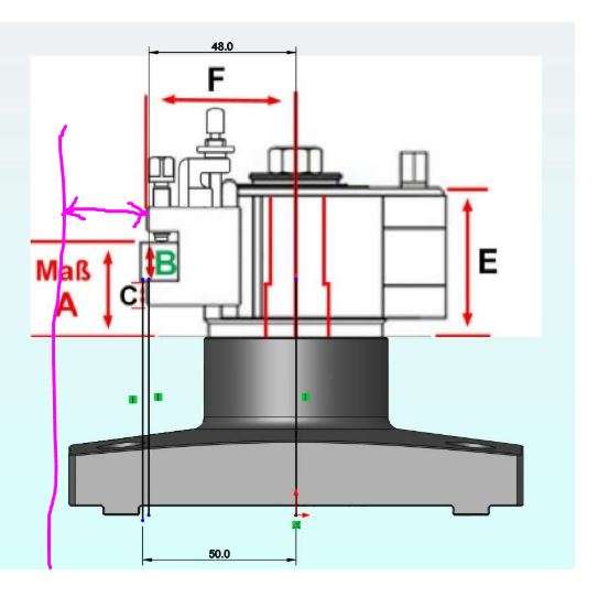

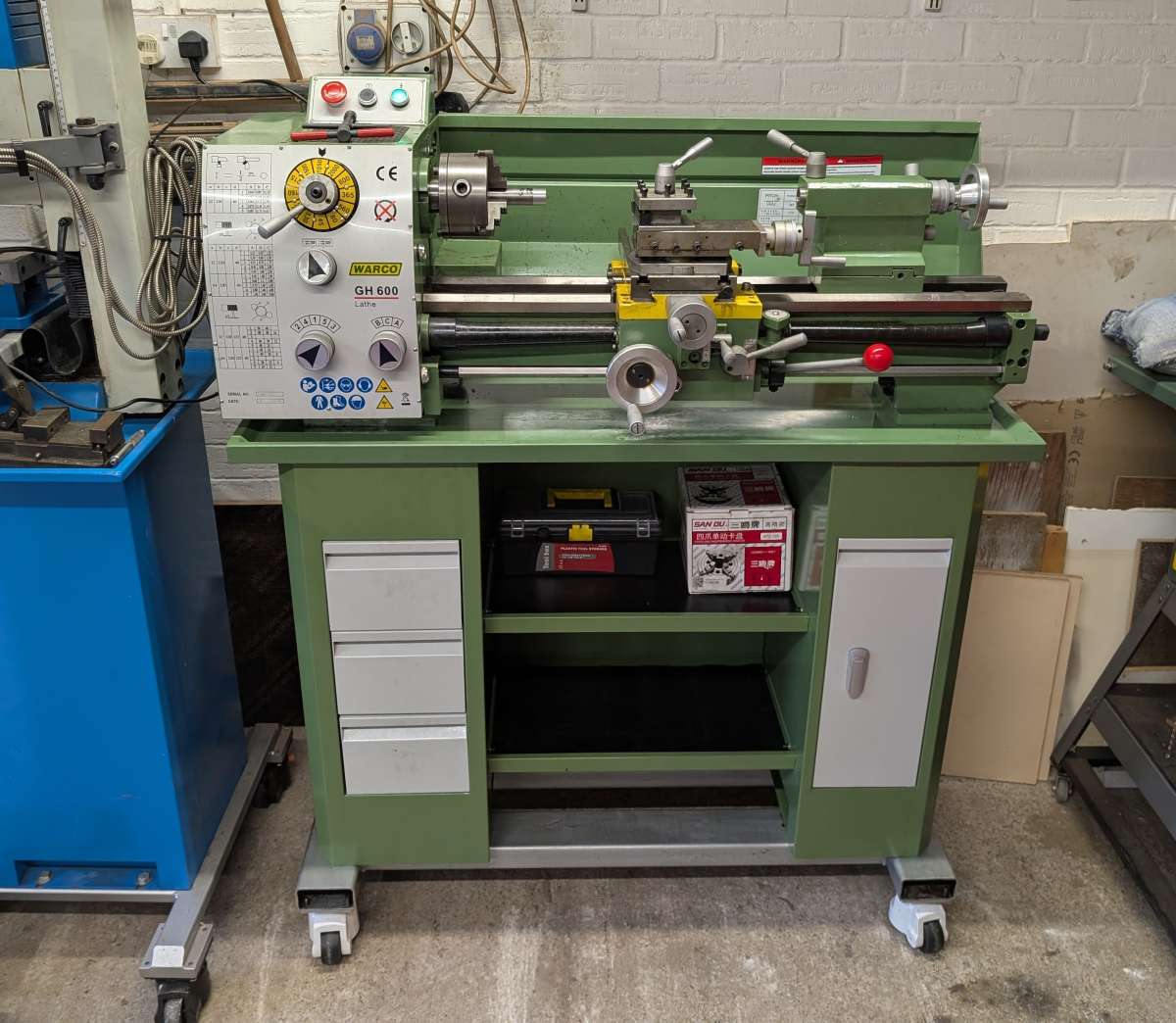

      Good Evening All,
      I am the new owner of a 2nd(3rd?) hand Warco GH600. My colchester student was too large and difficult to move, so it was time to downsize.
      PXL_20250309_151843936
      The lathe came with an unfitted ‘Multifix’ style toolpost and holders. The current topslide is too tall for it to be fitted to, so I am planning on making a solid block to mount it to.

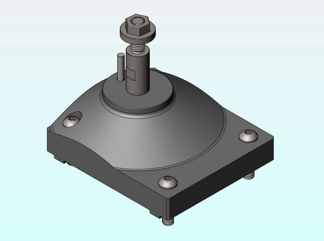

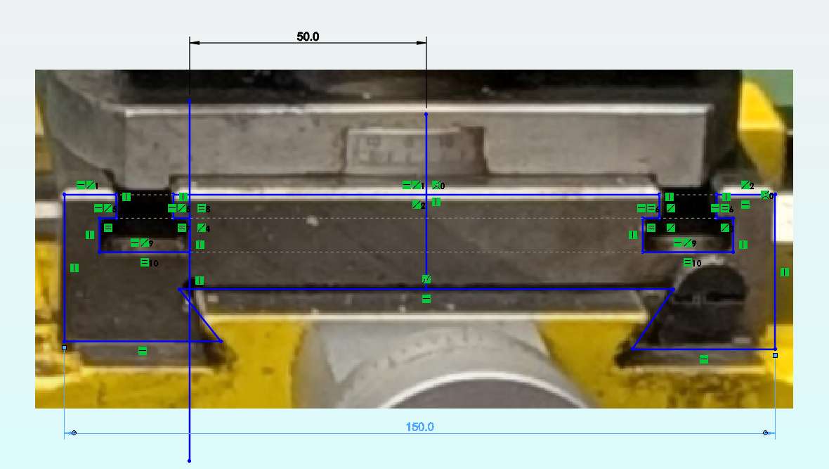

      My question is about overhang and Gibs.

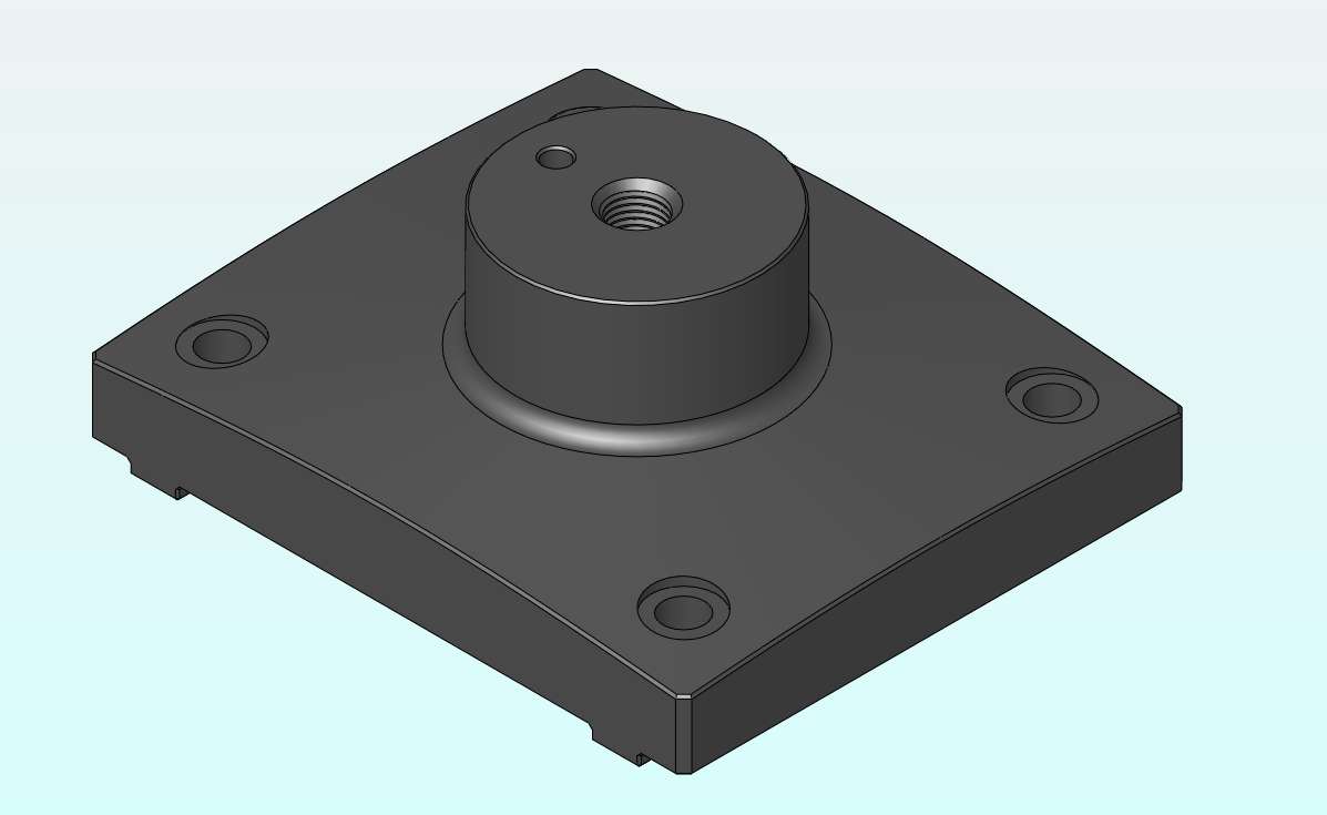

      The plan is to machine a piece of cast iron into the following shape, with the protrusion being centered in the block.
      (Dimensions yet to be finalised; height is likely to change, but I need to measure the lathe (currently away from home))
      Block
      However, looking at the cross slide, this will place the tool overhang at the weakest part.
      Topslide
      Mock-up
      So my question is, does this matter?
      In my head, the forces should just act through the center and won’t make a difference, but I’d really like a 2nd, 3rd, or 4th opinion.
      The design is not finalised, although I have ordered a 60x130x150mm piece of cast iron.
      Thanks,
      Richard
      #790579
      bernard towers
        @bernardtowers37738
        why have you made the central spigot so small?
        #790588
          The main issue I can see with the central spigot is that your tool will have excessive overhang when set parallel to the lathes axis and may not reach the work when set inline without risk of hitting chuck jaws when you have large work that needs facing in a 4-jaw or are using softjaws.
          overhang
          You may want to think about having the spigot towards the far left corner, similar to this.
          end
          like you he has made the spigot the same size as the base of the toolpost, can’t see making it larger would gain anything.
          One other thing as I can’t see a DRO on the lathe, say you want to take 0.2mm off the face of a part to bring it to final dimension, Will the carriage handwheel give that accuracy of reading, it’s not a problem to put on a cut that size with the topslide set parallel.

            #790613
            Clive Foster
              @clivefoster55965
              It would seem prudent to place the toolpost close enough to the edge of the slide to permit machining the largest diameter that can be swung over the machine bed. The length of maximum diameter that can be machined will depend on how far in front of the slide the cutting edge actually lies. Personally I’d arrange the toolpost so its base is barely inside the line of the front edge of the cross-slide so the tool and part of the carrier overhang. Structurally speaking the effective stiffness of the tool support is defined bay the diameter of the toolpost base so, as far as the tool is concerned, anything outside that circle does nothing.
              I’d not bother with pretty curves. Simple flat topped rectangular block will do fine and provide space to arrange mounts for specialist jobs if needed. Given the minimum of extra work needed I’d provide three tapped mounting holes for the toolpost. One at the front, one in the middle and one at the rear. On (rare) occasions the third set of mountings at the rear of my Dickson tool posts have proven very handy when working on tailstock centre supported components. I consider an extra mount placed so as to use the multifix in that way might also prove useful.
              Worth making a boring bar holder to bolt on the carrier block too. QC tool posts severely limit the size and therefore stiffness of boring bar that can be held. Nothing like a hefty bar to make producing a nice finish relatively easy. One for a round bar can be drilled in situ. One for square shank tools can easily be made by screwing and gluing stock sections together.
              Clve
              #790632
              David Senior
                @davidsenior29320
                Having the tool tip within the width of the slide as you have designed it is ideal – ie no overhang. Yes, there may be times when you would want it nearer the chuck, but at those times you just have to rotate the tool by 1 or 2 of the 9 degree steps.
                As the dovetails on your lathe are quite wide you could probably offset the central boss a little to advantage.
                On my Raglan 5″ the dovetails are closer together so I was able to keep everything central. I made the block as stiff as possible by tapering from top to bottom, but that may be unnecessary.

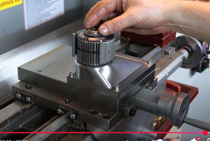

                  The main reason I asked this was because of the following two videos I saw during my research.
                  https://www.youtube.com/watch?v=S7GxY_QVDtk
                  https://www.youtube.com/watch?v=lbjWQ0G-ZQw
                  I had initially offset the spigot to the LHS.
                  The spigot dimensions and clearance etc are not finalised. But I would like to stick to a round feature so I can turn it on the lathe.
                  Bernard- I haven’t made anything yet, just a concept. At least 3 weeks before chips can fly.
                  John- I follow Clough42 and watch his videos regularly, so I have seen how he went about it.
                  Jason- The lathe did come with a DRO, but not installed. I was hoping to get the toolpost mounted before the DRO. So, it is next on the list, although my work doesn’t often require precision. Would you be able to link the video you took that screenshot from?

                    Clive’s suggestion of multiple mounting points is a good one even more so if you are going to fit the DRO scale to the right of the cross slide. When using tailstock support it can be useful to be able to wind the topslide fully to the right to avoid excess tailstock extension so being able to reposition the toolpost may be handy.
                    Changing the bottom locating ribs to pegs would allow the support to be repositioned 90deg which would allow a turned spigot to be mounted to the left or right.

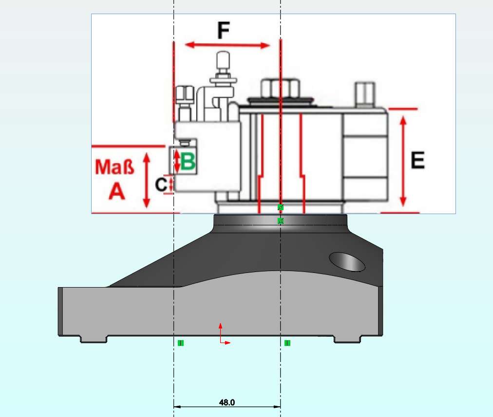

                      @dc31k
                      Another small thing to consider is versatility. Looking at the proposed design and the circular Raglan one, they are symmetrical. That reduces their versatility as they are the same any way you rotate the main block.
                      With the one described as “having the spigot towards the far left corner”, potentially that could be bolted to the cross slide in four different orientations. As shown it is ‘forward, inside’. Rotate the block 90 degrees anticlockwise and it would be ‘forward outside’ (handy for larger diameter turning). Rotate so it is ‘backward’ and it gives extra reach towards the tailstock end for turning long stuff.
                      Thus, my gut feeling is that having the spigot non-central to its base would offer both a ridgid and flexible solution.
                      #790753
                      Richard Kirkman 1
                        @richardkirkman1
                        Thanks for the link Jason
                        As far as I know, my plan is to mount the DRO scale to the LHS of the carriage, as that’s how Warco usually does it. I did enquire if they had any specific instructions, but they didn’t; they just sent a few pictures.

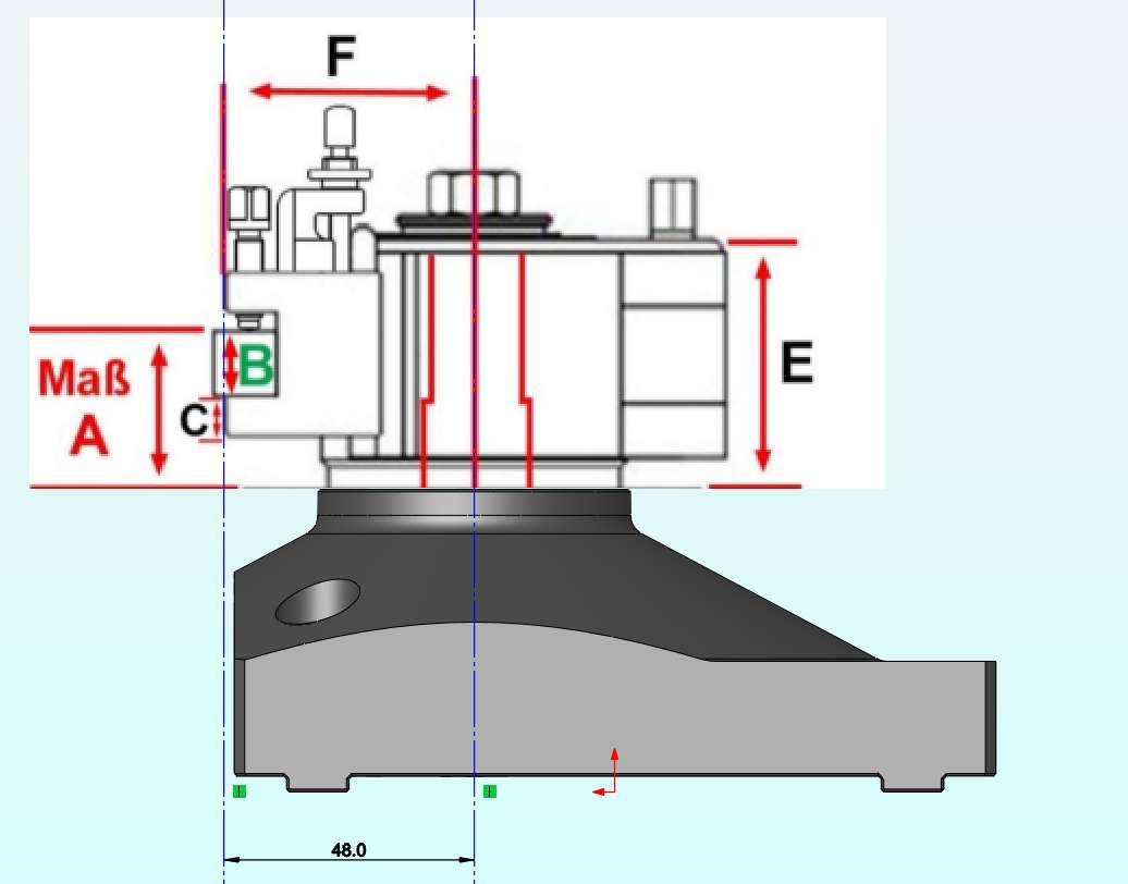

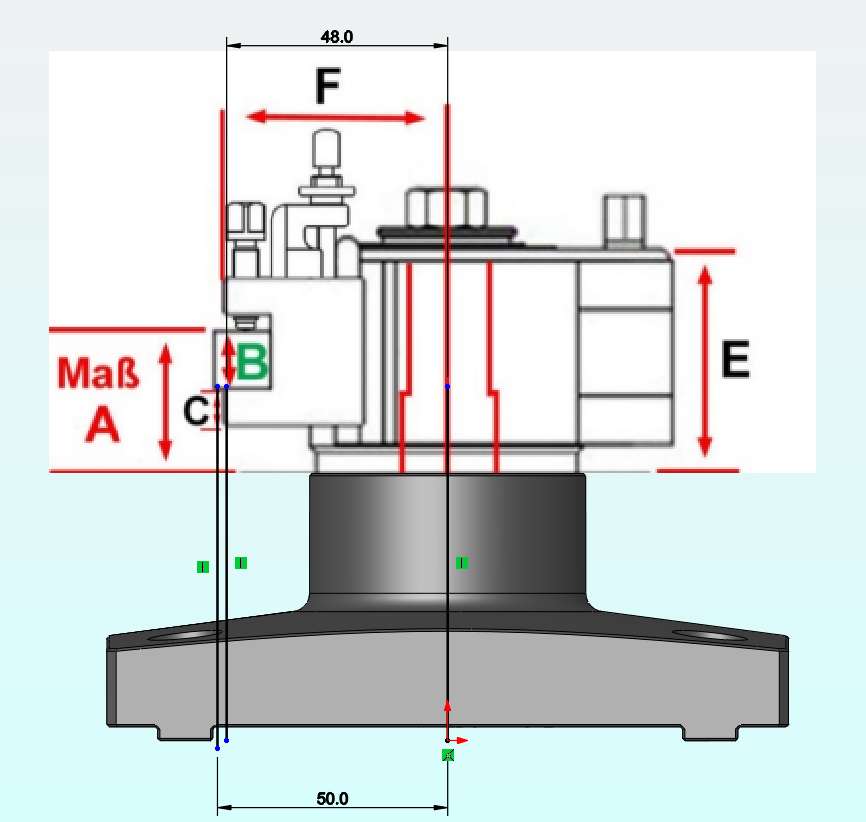

                        To summarise so far:
                        Moving the spigot to the LHS will give more clearance, maintain rigidity, and allow for reversal if needed. However, it will put more pressure on the left of the cross slide.
                        Having a central spigot will perhaps be more rigid and spread pressure more evenly but at the cost of clearance and versatility.
                        I am going to offset the spigot (or mounting point, depending on the final design).
                        I’ll test some more ideas and see what looks right. Ultimately, it will depend on the measurements I take from the lathe.
                        Thanks to all, always open to more suggestions/opinions.

                        Richard Kirkman 1
                          @richardkirkman1
                          LHS Mockup 1LHS Mockup 2Assembly

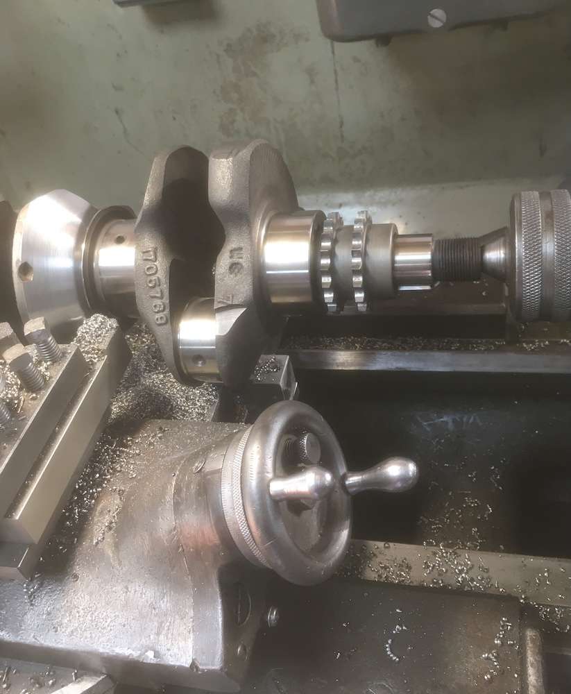

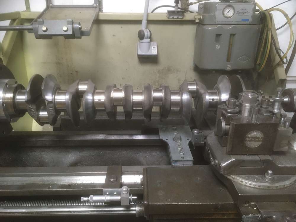

                                Clive Foster
                                  @clivefoster55965
                                  Jason, thanks for the support over having an alternative position for the toolpost.
                                  But not just for when you need to wiggle around the tailstock barrel though. Having left and right side mounts for the tool carriers on the Dickson made this little job so much easier that I’m convinced that equivalent functionality is highly desirable whatever breed of toolpost you use.
                                  BMW Crank 1 R
                                  BMW Crank 2 R
                                  That’s a 6 cylinder BMW crankshaft on the P&W B getting the weight watchers treatment to loose 2.5 kg for a classic saloon car racing engine. This sort of thing possibly explains why Jason and I tend to look at machining and set up issues a bit differently.
                                  Using a separate block to replace the topside as you plan without an extra mount point restricts how far back the MultiFix post can position the tool when swung round.
                                  As the top picture shows I was struggling for access even with a top slide to give rather more movement. I’ve learned from bitter experience that it’s best to engineer maximum versatility into the sort of modifications you are considering. I see little value in the cosmetic sweeps you are considering. For me a nice flat top so I can add a fixing hole or three if its the only way out of a tricky situation beats aesthetic appeal.
                                  Clive

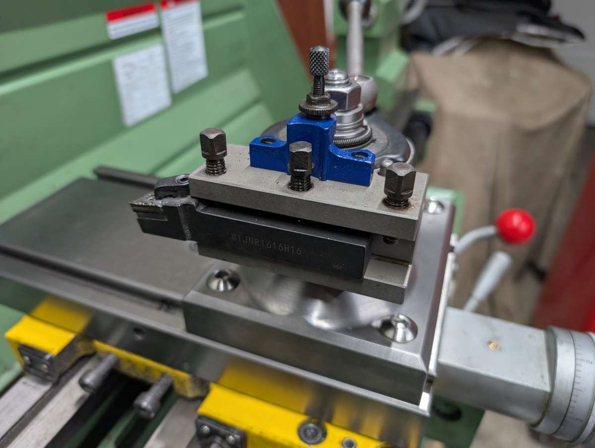

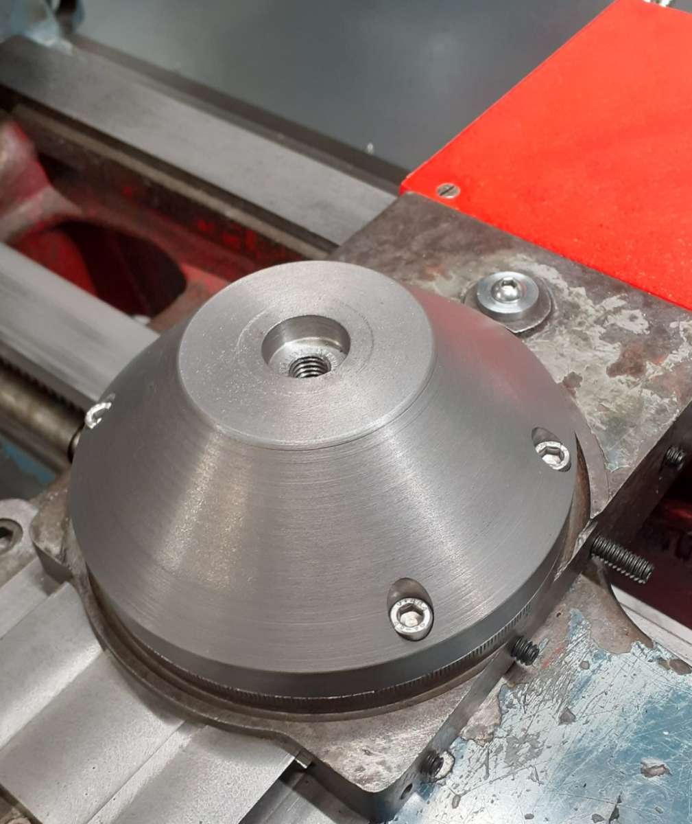

                                    #799874
                                    Richard Kirkman 1
                                      @richardkirkman1

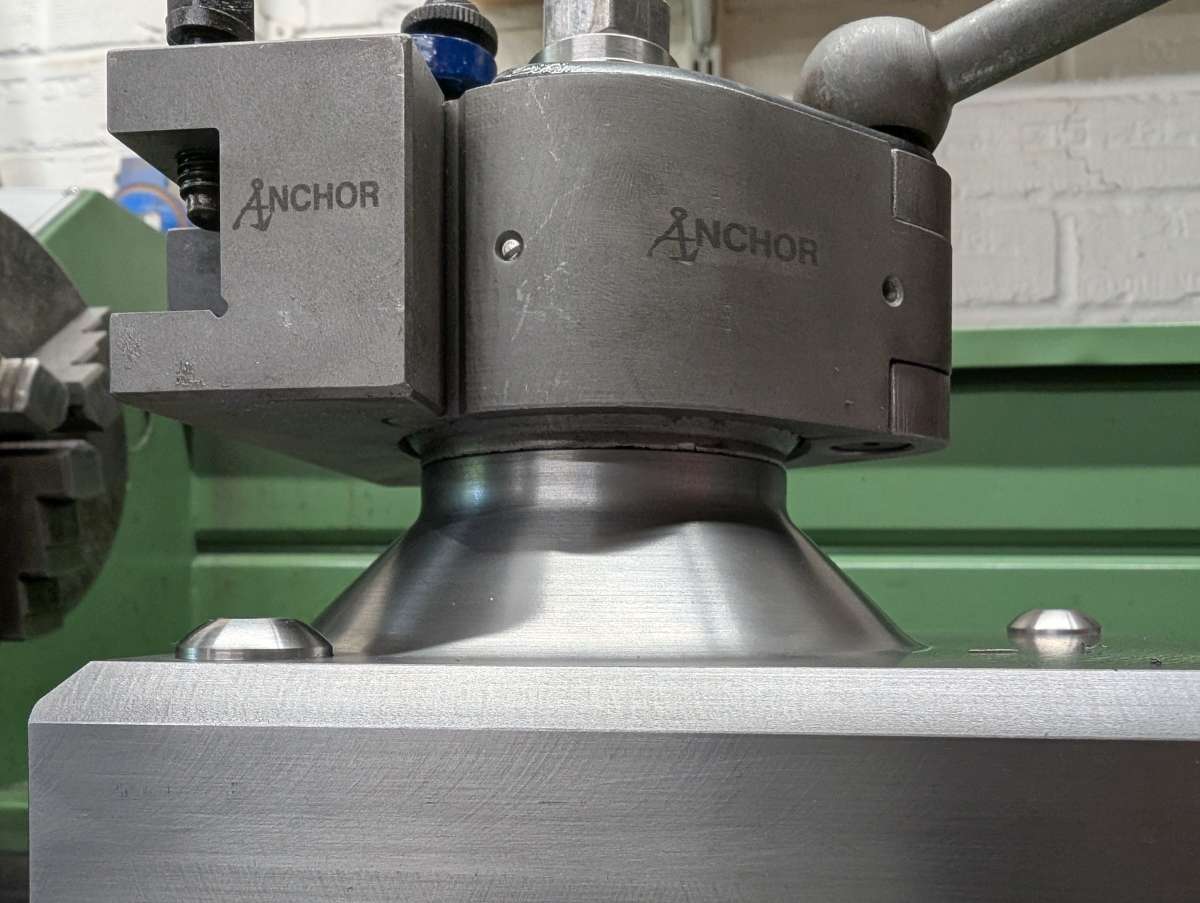

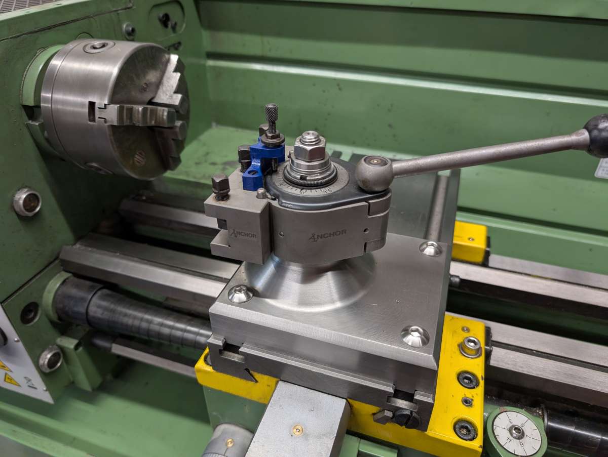

                                      Finally made the block. I’m quite happy with it, it was good fun to make. If it doesn’t suit all scenarios, then I can always swap back to the old compound.
                                      PXL_20250526_123158739
                                      PXL_20250526_123207252
                                      PXL_20250526_123225571
                                      #799901
                                      David Senior
                                        @davidsenior29320
                                        That looks like a good job to me.

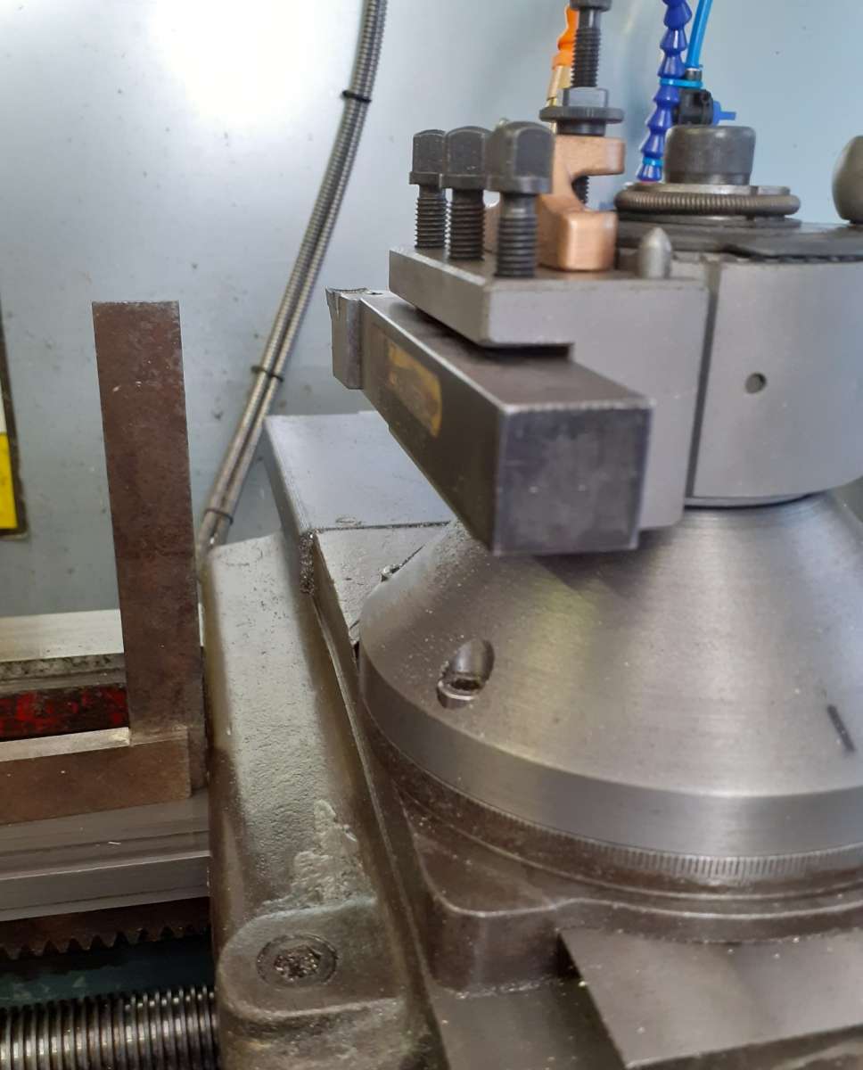

                                          I didn’t look at this thread when it first started but I would make the following observations as I do not use a compound slide on my lathe as I have CNC on Z and X axis.
                                          I often pull the index pin on my Dickson style tool mounting block to move the tool tip closer to the headstock by rotating the block or to get some clearance from standard inserts when machining tapers or curves.
                                          If you need a bit more precision than usual you can mount a mag base and DTI somewhere to measure carriage movement for small increments. You could even make a clamp on stop with a fine thread adjustment to work up to.
                                          Regarding the rear parting off tool holder, if I start to have parting off problems using my standard toolholder I know it’s time to adjust my headstock bearings. The rear tool post for parting off is probably something needed for lathes that have plain bearings with no adjustment.

                                          #800250
                                          Diogenes
                                            @diogenes
                                            Nicely done – will make it much easier to get the tailstock right up too..
                                            DRO will need to go on now? – the carriage handwheel is kind of do-able, but just requires too much concentration for comfort (..I find..)
                                            I’ve never felt the need for a rear toolpost, tho it’d be the way to go for repetition work..
