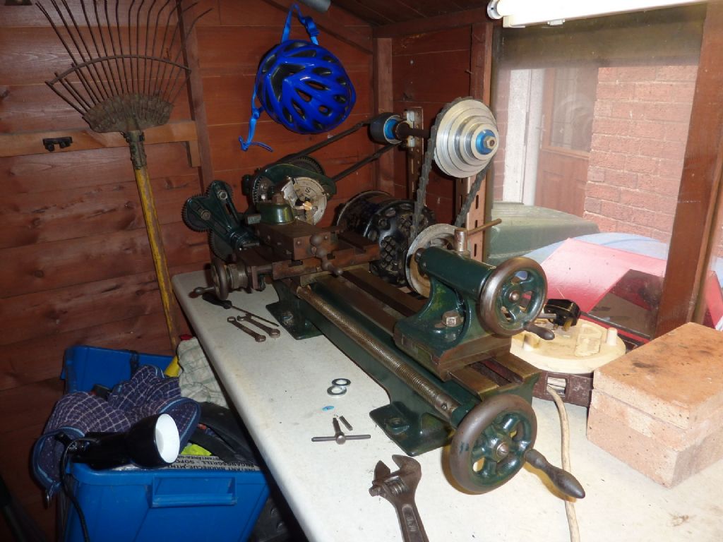

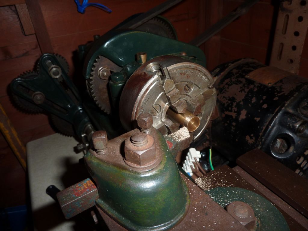

      A week to the day after buying it, I managed to make some swarf on my Faircut lathe.
      The lathe is not yet properly installed – I'm figuring out how to construct a sensible drive arrangement with the bits that came with the lathe.
      My first attempt more or less reproduced the arrangement that the previous owner had. Unfortunately he never really used the lathe after inheriting it so it turns out that his drive arrangement has a serious flaw – the back end of the cross slide can collide with the motor and/or the drive pulley… apart from the obvious matter of the pulley being in the firing line for swarf.

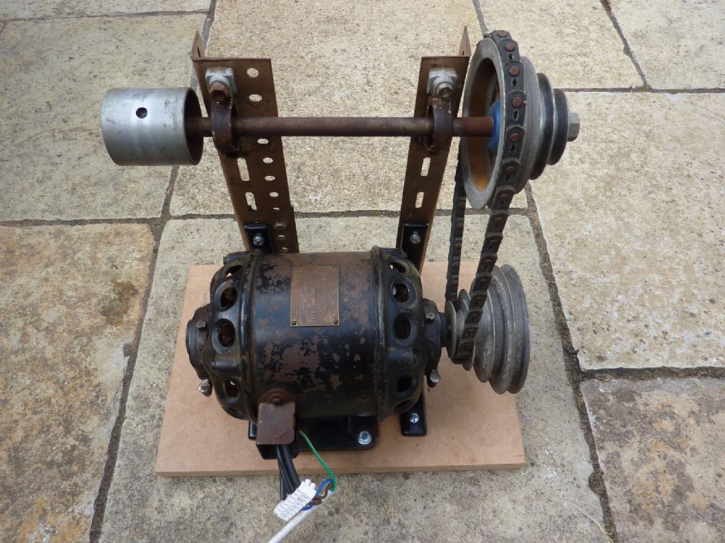

      I'm putting the drive system together on a 'sledge' to give me a way to tension the flat belt. The Mk 1 arrangement is below.
      I eventually want to get to an arrangement with 3 stepped flat pulleys to match the lathe but for now the objective is to get the thing up and running.
      I'm thinking that my next move is to get a pulley mounted in the middle of that shaft but that turns out to require some thought. I've now dismantled the Picador pulley shaft and discovered that it has stepped ends (and also a left hand thread which took me a while to twig). I also discovered that the shaft is aluminium so quite why it looks like rusty steel is a bit of a mystery really. Figuring out how to get the (ball) bearings off would be useful.
      The snagging list for the lathe proper is getting longer each time I look at it but the priorities just now are getting the drive system sorted and a sensible electrical arrangement put in place.

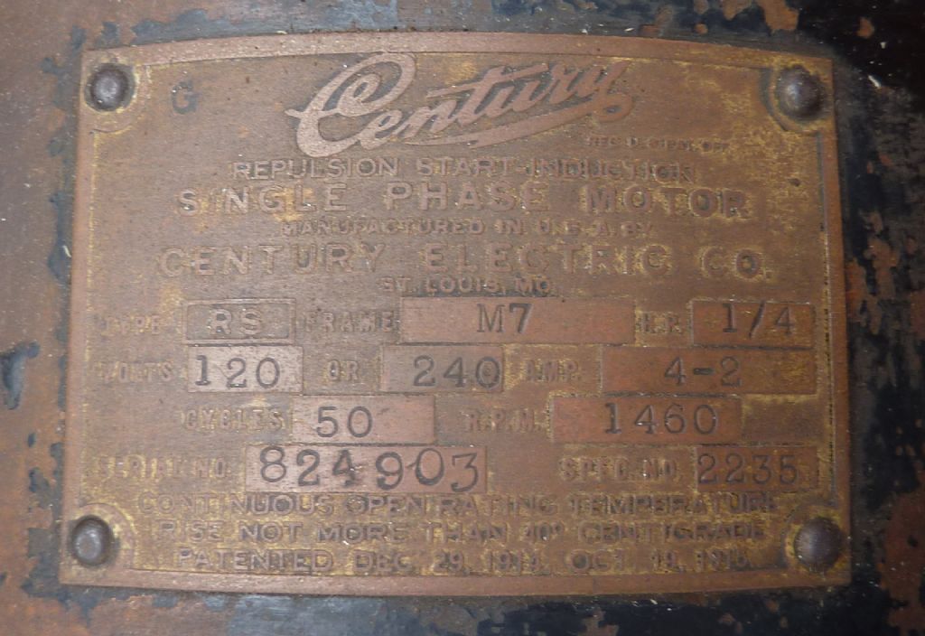

          Motor looks familiar 1/4hp American Century Electric Co. with brushes, WW1 vintage?
          Edited By Dave Halford on 18/08/2019 20:35:42
          #424929
          Andy Carlson
            @andycarlson18141
            Absolutely. Century Electric Co repulsion start induction motor.
            My original thought on collecting it was 'what a piece of junk, take it to the scrapyard' but I've now found out a bit more about it and I have done a complete about face on that plan.
            Date-wise I dont know. The last patent date on the plaque is 1918 and the info I've found online suggests that they started using an alphabetic prefix to the serial numbers in 1938, so that leaves a 20 year band of uncertainty but I suspect it's early in that band.
            I've given it a good clean up and freed up the sticking brushes. The external leads were a complete rat's nest so I've tidied those up and pushed some modern insulation sleeving as far into the casing as it will go. Runs a treat

                      First thoughts re motor placement –
                      1. cut a hole in the bench for the belt run, mount motor under bench. Make sheetmetal swarf/hand guard around belt. Belt would need to be lengthened to reach motor under bench.
                      2. Pivoting around the jackshaft, swing motor/frame/jackshaft up to a pre-made sturdy wood frame mounted to wall and roof under the rafters, little bit higher and to the right of the blue bike helmet.
                      Good luck. Glad you made some chips already!

                            Posted by Jeff Dayman on 18/08/2019 21:29:43:
                            Thanks. The underneath of the bench is spoken for. I'm pretty much at the limit of the available real estate for machine tool related uses so above the bench it must be. Changing the belt length should be straightforward enough – they are jointed leather straps but lifting the motor higher is not an enticing prospect. It's flipping heavy! At the moment I'm trying to arrange it so that it can go further back towards the headstock end.

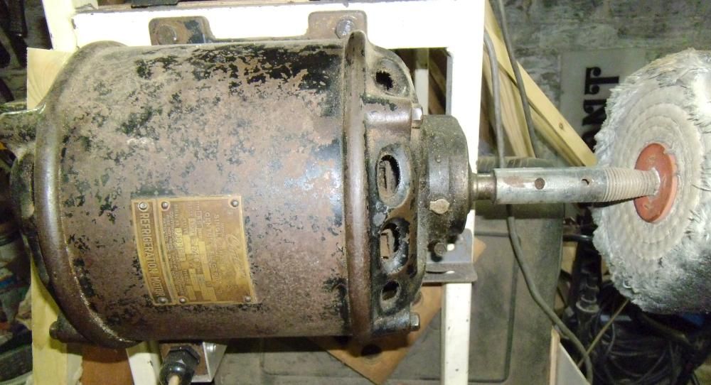

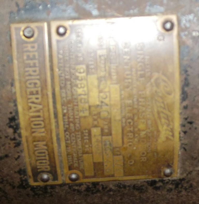

                                        Posted by Dave Halford on 18/08/2019 20:32:38:
                                        I've got a 1/2HP motor of the same make which I use for a buffing machine, in addition to the brass plate shown mine has an additional plate reading 'Refrigeration Motor'.

                                            Sandgrounder
                                              @sandgrounder
                                              Posted by Andy Carlson on 19/08/2019 08:03:54:
                                              Posted by Sandgrounder on 19/08/2019 06:53:03:
                                              Care to share any photos of your motor?
                                              This is the best I can do at the moment, the camera does'nt seem to do close ups very well, and excuse the workshop clutter as I'm just re-arranging things, I've tried to crop most of it out. The motor serial no is 958784
                                              Edited By Sandgrounder on 19/08/2019 10:11:50
