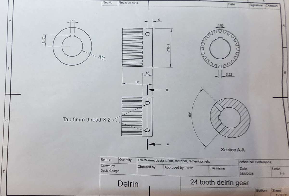

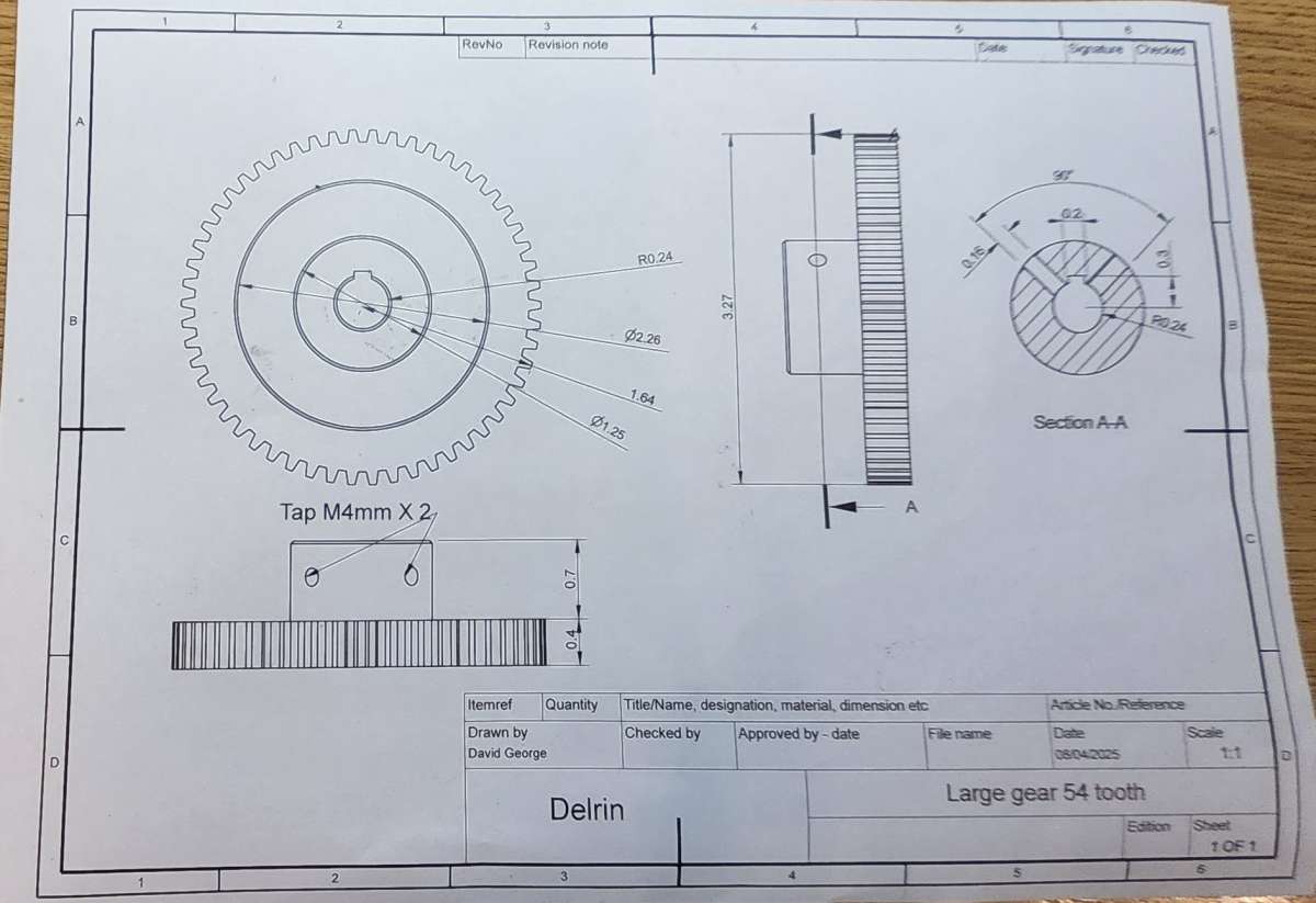

      I have to replace some gears for a friend. They are for an arcade game which has a steering wheel and the gears are for control from steering wheel to position senser.
      The smaller gear is   1.5″ ( 38.1 mm ) diameter with 24 tooth.
      The larger gear is   3.27″ (83.05mm) diameter 54 tooth
      I have no problem with cutting the gears as I have dividing head and a small mill etc but I don’t know what cutter to use i.e. what pressure angle etc to order a cutter for the job an so if anyone can help I would most appreciate it.
      24 toothe gear
      54 tooth gear
      David

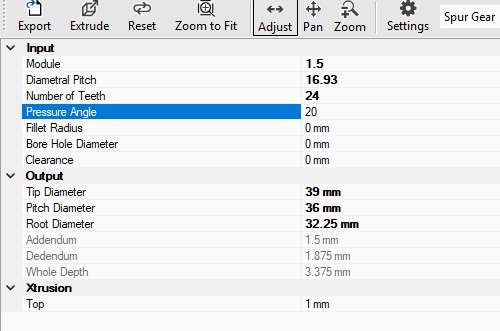

        Bit of an odd one there as I get 17.3333DP  or MOD1.465 or 0.181″ circular pitch
        What are the gear ctrs as the OD may not be to the book and giving a false PCD

          You would do well to discuss the practicalities of the top drawing with your client and give the CAD jockey a wrap on the knuckles.
          A blind keyway is a challenge, so repeating it 24 times as a gear tooth up to a square shoulder will be a greater challenge.
          Use two timing gears and a belt and hold the controller upside down.
          As a very last resort, it may be possible to use 1.5 MOD gears and slot the holes in the position sensor to make the centre distance correct.

            I get the same odd-one answer as Jason, and guess it’s MOD1.5 with teeth clipped back slightly from 84.0mm to David’s 83.05 measurement.
                You would do well to look at the drawing again as I don’t see a blind keyway.

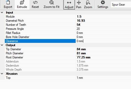

                Though it  can be a bit tricky to model the gear profile as the cutter feathers out the teeth in CAD which may be what you mistook for a blind keyway

                    David,
                    How much, if any, leeway is there in the spacing between the gears?  Using my gear calculator. I get 84.00mm diameter for the 54 tooth gear and 39.00mm for the 24 tooth one :
                    54T Mod 1.5  24T Mod1.5

                          David, I would be tempted to look at DAVALL stock gears. They do a 24T 1.5mod and a 54T 1.5 mod, the small one in steel and the large one in polyacetal. Might be easier and quicker.

                            Like the others, the dimensions suggest 1.5 Module gears, in which case the Pressure Angle is likely to be 20 degrees.
                            I think that Module Gear Cutters are numbered in the opposite sequence to DP cutters; so my guess is that for a 24T you will need a No 4 1.5 Module cutter, and for the 54T a No 6 1.5 Module cutter.
                            The depth of cut (D+f) will be engraved on the cutter
                            For the 54T you can run right through, but the 24T teeth will have a radiused end rather  than a perpendicular one, unless it is possible to reduce the OD of the blank end so that the cutter only just touches the reduced OD.

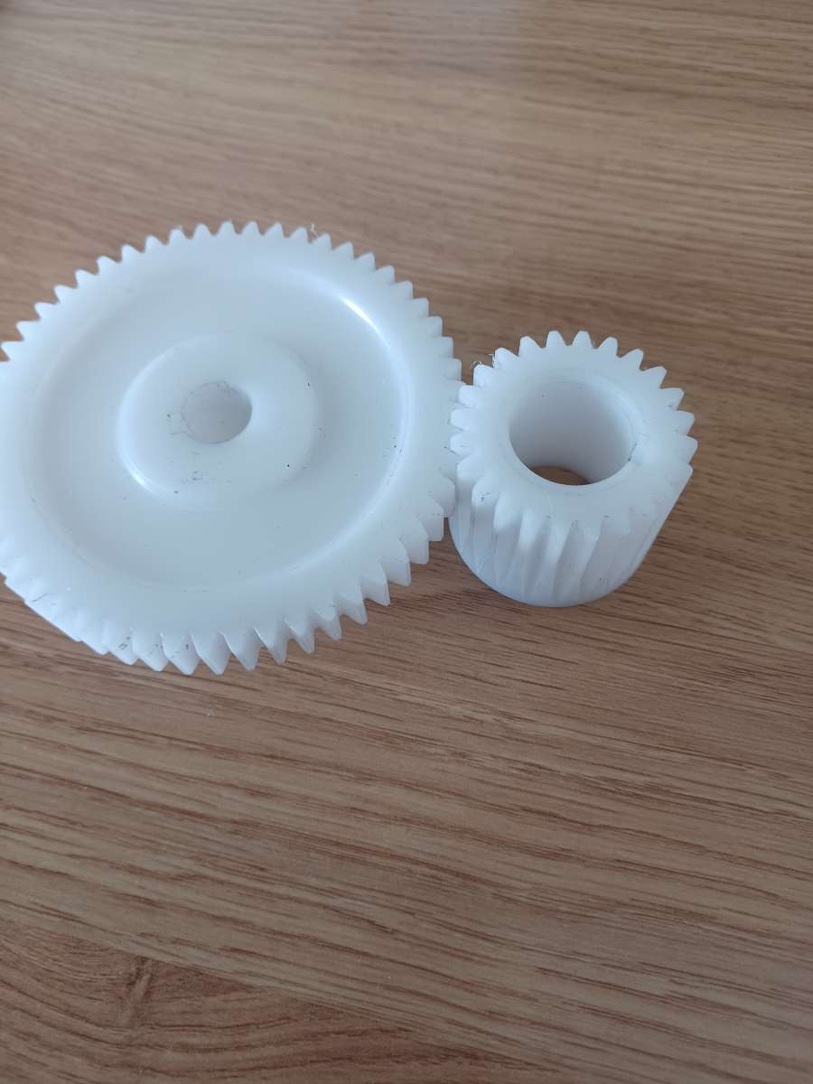

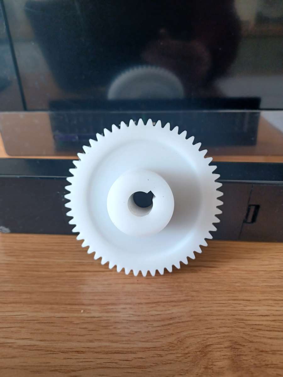

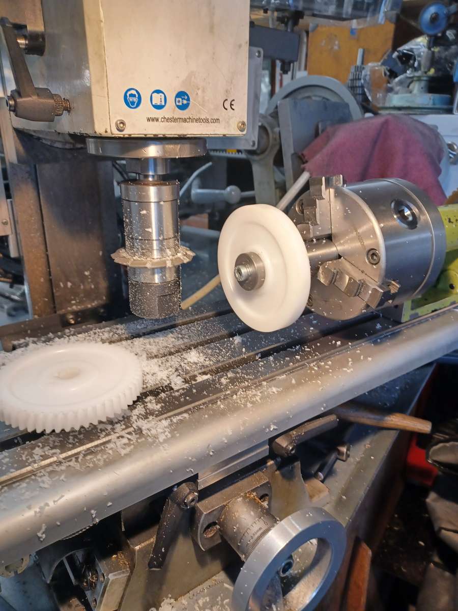

                                                      Just thought I would let you know that the Delrin Gears are finished and working well. A couple of pictures of the gears and thanks for information.
                                                      20250507_154740
                                                      20250507_113846
                                                      20250508_143803
