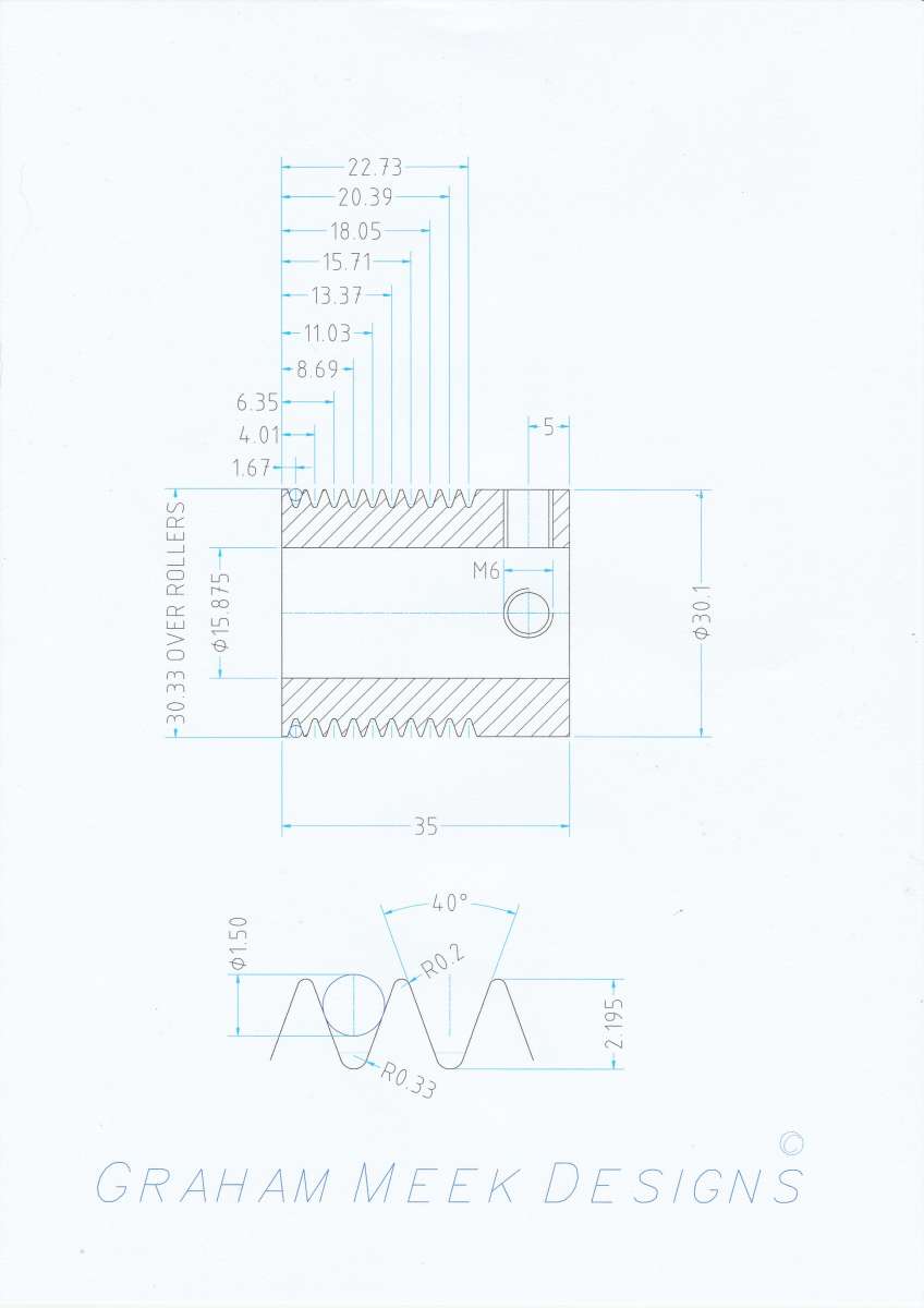

      A few days ago I promised that I would post a few photographs of the conversion.
      The next photograph shows the new ribbed pulley. Which is all that is required to be made to convert this machine.
      Lastly the saw in action, if you notice from the the blurr on the hacksaw frame this is taken with the saw in motion.
      The material is 40 mm Aluminium and the saw cut through this in several minutes.

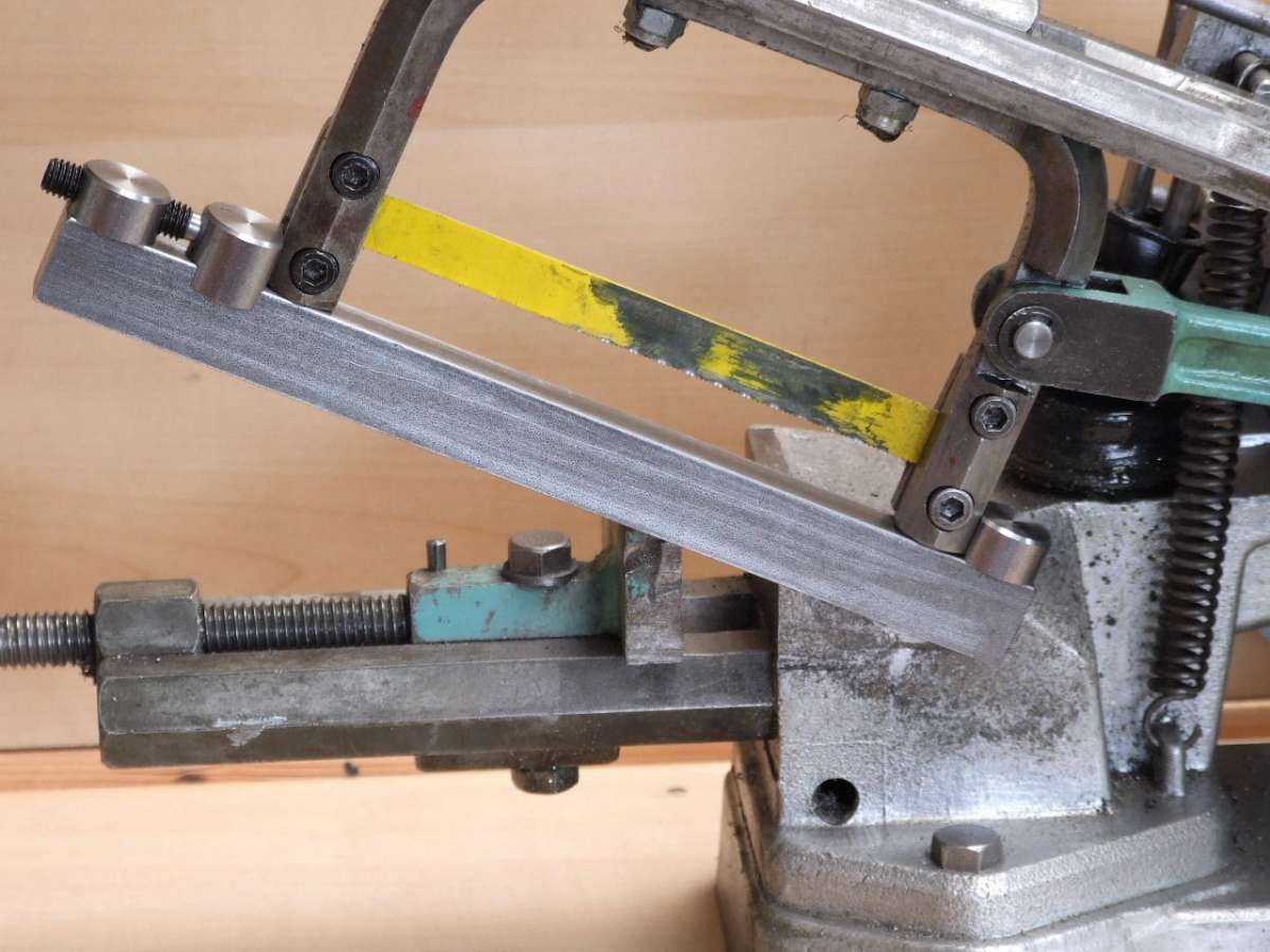

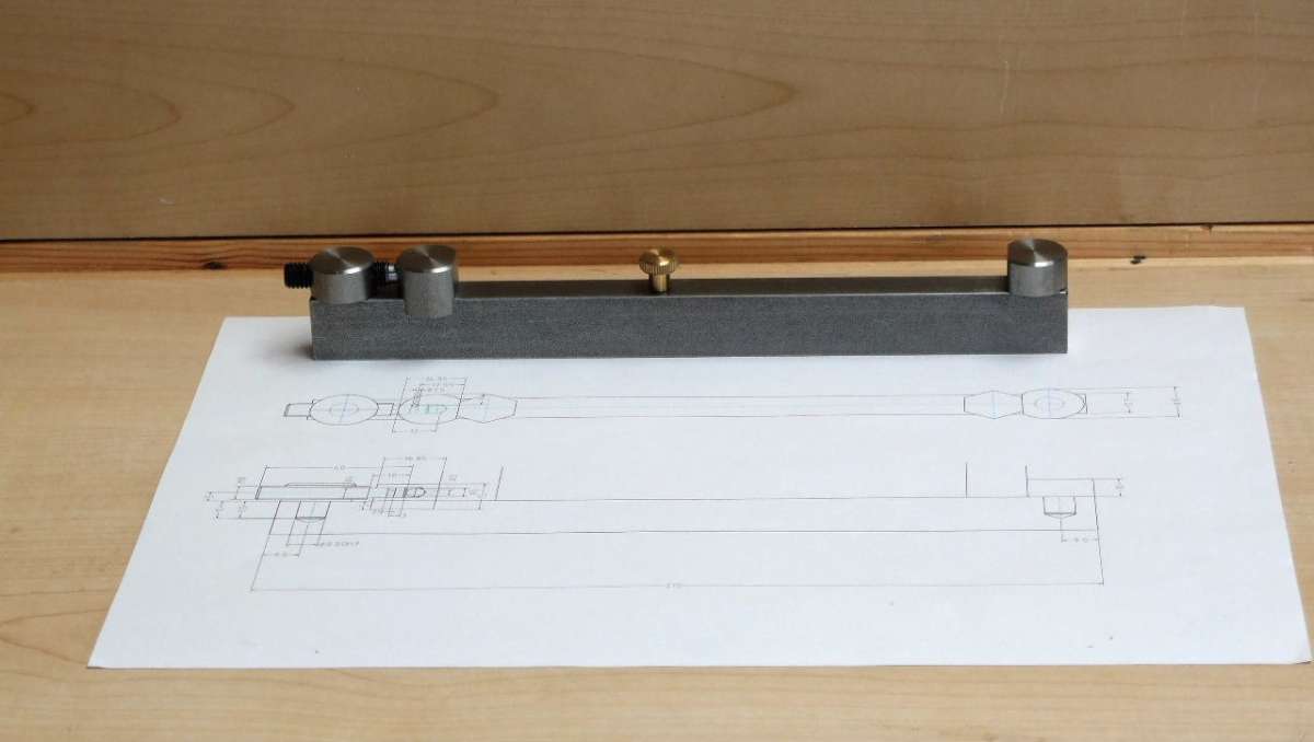

                A while ago I noticed on Ian’s 90 Saw above that there is a blade tensioning facility. While I have not as yet checked to see if this was standard on the 90. I thought the blade on the 60 would probably give a better finish if it was under some form of Tension. Plus it may even lead to extending the life of the blade.
                Using a similar arrangement as the 90 was not really possible as the blades for the 60 are cut into two. The standard hole in the hacksaw blade would only work for one end of the hacksaw, (NB, tooth direction on the blade). Duplicating any such adjustment was deemed too much of an overkill.
                I tried compressing the frame of the 60 using a Record 12″ “G”-clamp. The amount of effort required was negligible and the resultant cut surface did not show the previous striations of the previous set-up and was generally much better. The saw blade would ring slightly as it was cutting, so it was under tension.
                While I could of continued to use the “G”-clamp the set-up. The size of the clamp pad faces made extracting the old blade and inserting the new one time consuming. Something simpler was needed.
                Tensioner in position
                The above shot shows the finished design in-situ. It will be noticed that the blade can easily be removed as the clamp does not go high enough to cause a problem.
                Kennedy Hacksaw Blade Tensioner
                (Please ignore the Brass thumbscrew, the Camera, or the Operator were having difficulty getting the focus right)
                In use the 4mm Allen key in the M8 grubscrew is very easy to turn, due to the ball bearing at the bottom of the hole in the clamp pad. There is an added bonus in that when the adjuster is put onto the machine and slightly “nipped-up”. Before releasing the clamp screws on the blade to remove the old blade. This setting will not interfere with the original blade setting. Thus once the optimum setting is found, (This I found was about a 1/4 to 1/3 of a turn from the free state), this initial setting will remain for ever and a day.
                Regards
                Gray,

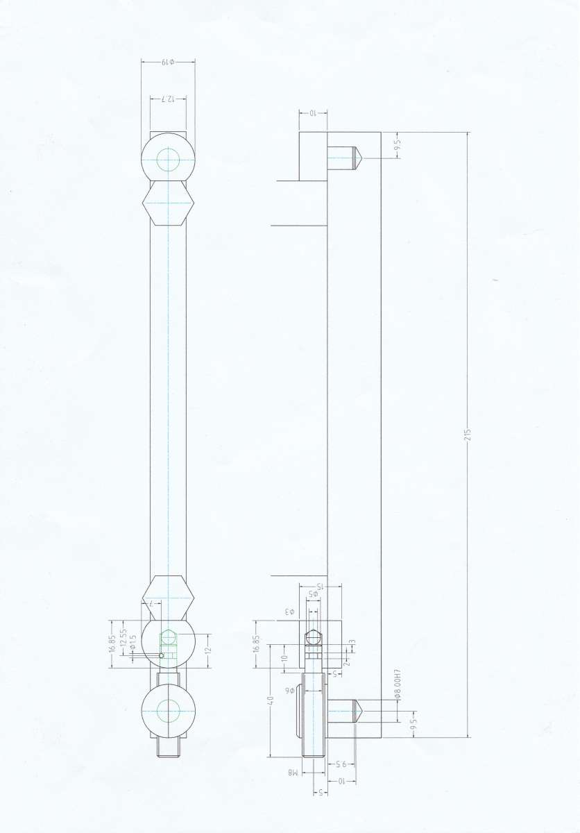

                    I thought other Kennedy owners might want to make this little item, so I have loaded the drawing below. Having this here will save the un-needed exchange of PM’s and emails. The manufacture of this device took hours rather than days, so will no doubt repay its construction equally as quick.
                    Kennedy blade tensioner

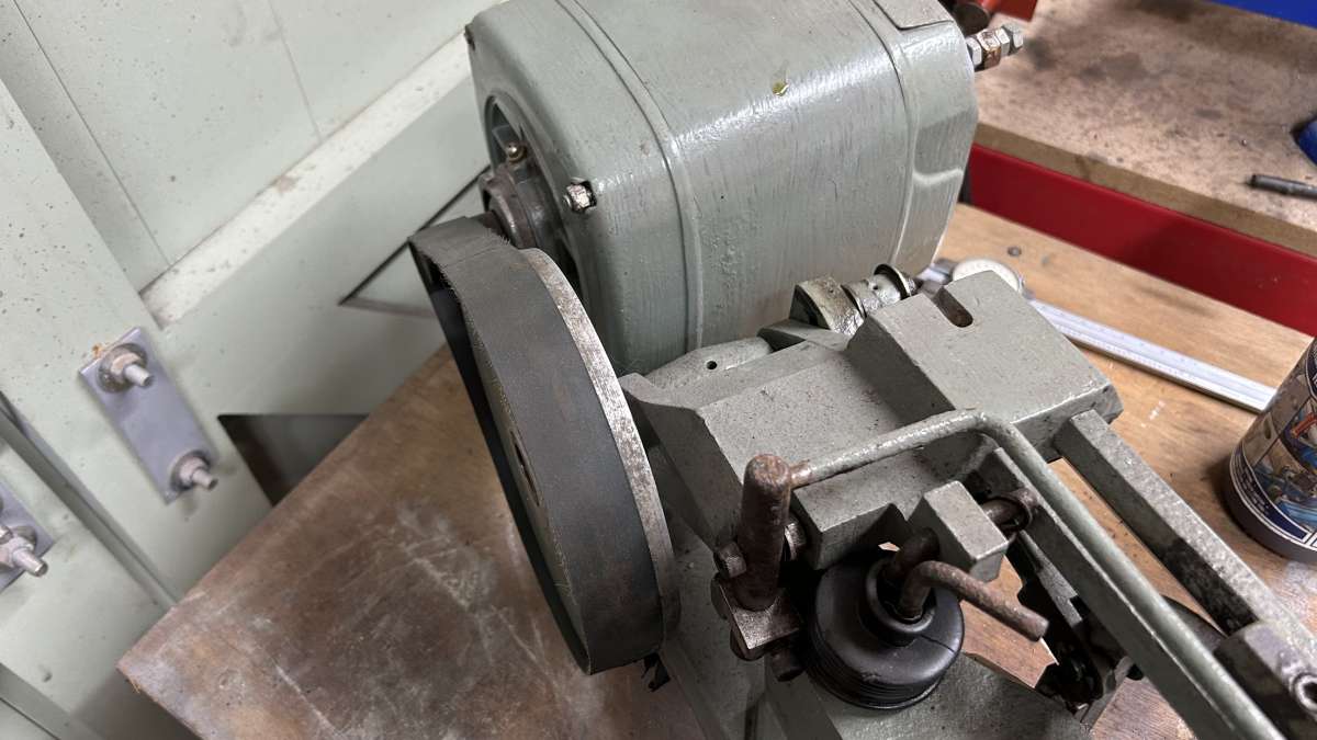

                        Good morning all – apologies for the thread necromancy on this one – but some years ago I bought a Kennedy Hexacut sight unseen and while usable it came to me with a few problems and I was hoping to seek some help from the kind folk here to get it back in tip-top shape:
                        1. There is no belt guard – would it be at all possible for someone to provide some outline dimensions of the belt guard so I might fabricate one please?
                        2. The cuts are not square – drifting left when viewed from the front of the machine. I gather this may be due to worn bushings. If that is the case, am I best to replace bearings with Oilite or plain Phosphor bronze?
                        3. The auto-stop lever has broken – An extended stud on the Hoover motor has a nut on it, to which a bent piece of rod has been soldered. I think this may be after-market, as it doesn’t quite match any expected dimensions and the solder joint has broken (and been repaired) – I have thought about making a new one, with a silver-soldered boss for pivoting. Does anyone have the original dimensions of the auto-stop lever please?
                        4. The belt is in bad condition and not centred on the motor shaft, which is just domed over – I understand I can buy a straight replacement for it (540mm x 25mm flat belt – bearing boys) or a ribbed version as discussed in this thread (559P/220J _10 RIBS – simply bearings) – should I expect to bush the motor shaft with a pulley to bring things back in line? There doesn’t appear to be enough lateral adjustment.

                          Normally, a flat belt will self centre when running over a slightly domed pulley.
                          Why? I cannot recall the proof shown MANY years ago at Technical College.
                          Possibly, a ribbed belt might behave in similar fashion

                              The ribbed belt needs its own motor pulley and it needs far less tension to work. This pays dividends as regards the life of the original Phos Bronze bearings.
                              These bearings are cast into the parts of the machine. It is not a simple case of pressing the old ones out and pressing in new ones. They will need to be machined out. something I have to get around to on my machine one day.
                              The “cutting off to the left” is most probably as you have assumed a result of worn bearings.

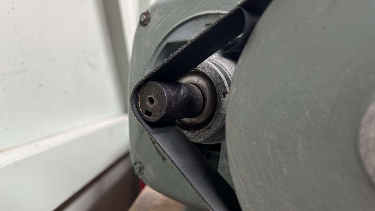

                                Thanks Graham – it’s not the end of the world, I’m never doing precision work on it anyway, just using it to hack through big chunks of steel or CI I don’t want to expend the sweat on – but it would be nice to get it back into shape.
                                With regard to the pulley/ribs – I know I’ll need a new one for a ribbed belt, but I’m more just a bit confused as to what mine is doing. It would appear that it’s a sleeve on the motor spindle that has been rounded over, but has been slightly misaligned to pull the flat belt off the centre of the drive pulley?
                                IMG_7562IMG_7561
                                Is it worth trying to lever off that sleeve on the motor spindle? Would you please be able to PM/Email me your plans for the 10-rib motor pulley on the chance I can get it off?
                                The bushings sound like a pain to replace – do you have any tips please?

                                  The original pulley on my machine was slightly larger than that shown on your machine. It had an Allen grub screw into the keyway of the motor shaft. If my memory serves me correctly it was also slightly “Crowned”. Whether this was an original fitting or not I cannot say. I suspect the belt tracking problem has been a perennial problem for the previous and countless owners.
                                  I would get a can of “Plus Gas” to spray the pulley with before I attempted to remove it, or if you have some Diesel handy this will do. Failing that a Dremel type tool with a slitting wheel and cut down the keyway slot.

                                      Luckily I remembered I sent another Forum member a PDF of the pulley. Fortunately it was in the files of my current computer.
                                      Kennedy Poly Vee Pulley
                                      The oil is Morris Golden Film AG 140, Non-EP. This according to Morris’s Technical Dept is the equivalent to the Kennedy specification, which I sent them at the time.
