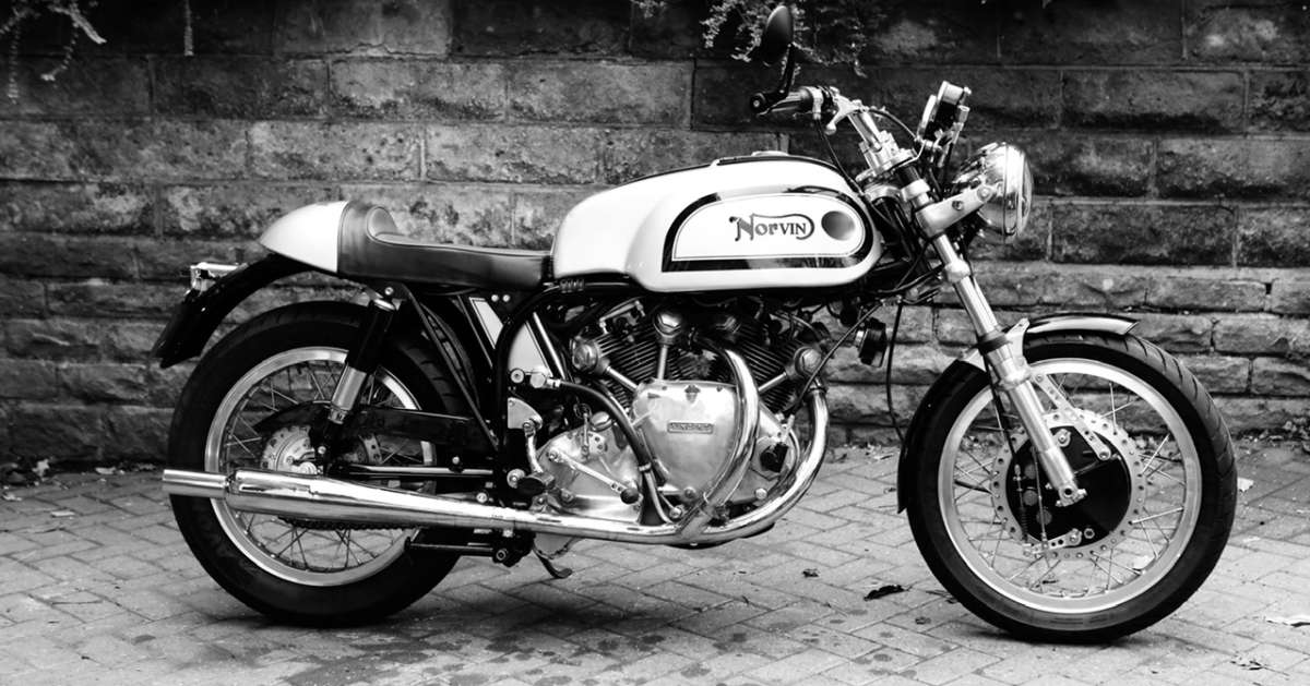

              #773583
              colin brannigan
                @colinbrannigan54160

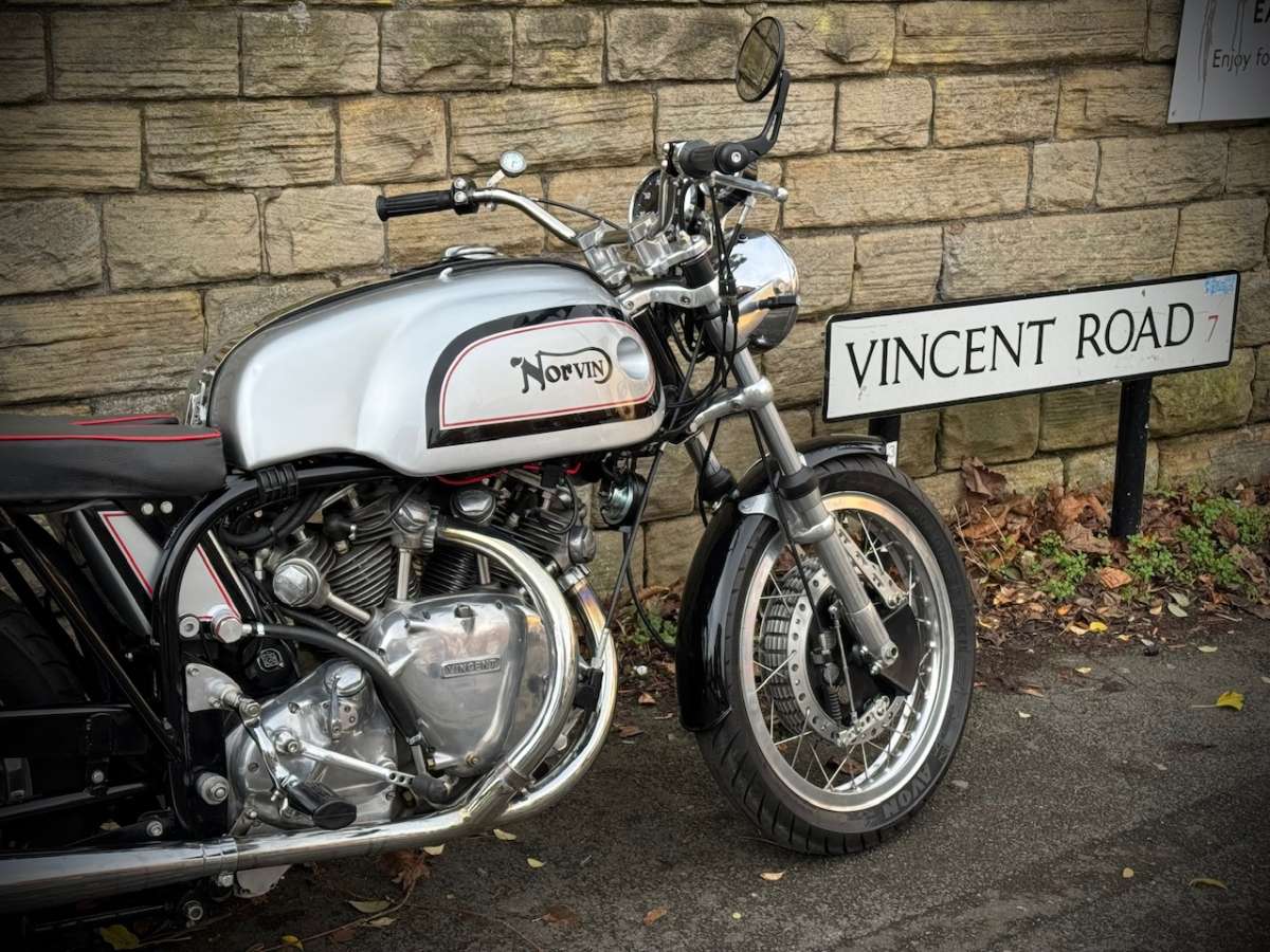

                Absolutely stunning, nothing like this finds it’s way into my shed they usually come in many boxes and not all the same model or even make, ’tis a work of art.
                Any chance of a few more photos.
                Kind regards Colin

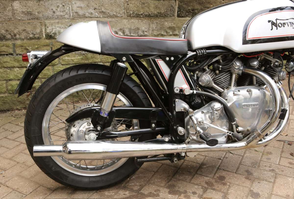

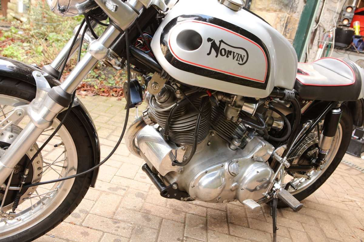

                #773584
                Ian Parkin
                  @ianparkin39383
                  Here’s a few more then Colin…I’m still looking in awe at it myself and what I’ve let myself in for…
                  IANP1391IMG_7465IANP1380IANP1384

                    Thanks Ian, my Triton now looks cheap and shabby along this master piece, I understand your trepidation but I hope you enjoy it every aspect of owning such a machine
                    I used to ride a B31 around the farm when I was thirteen or there abouts and a Postman called Flippo would help out at busy times and he rode a Vincent, I was in awe of the marque then as I am now

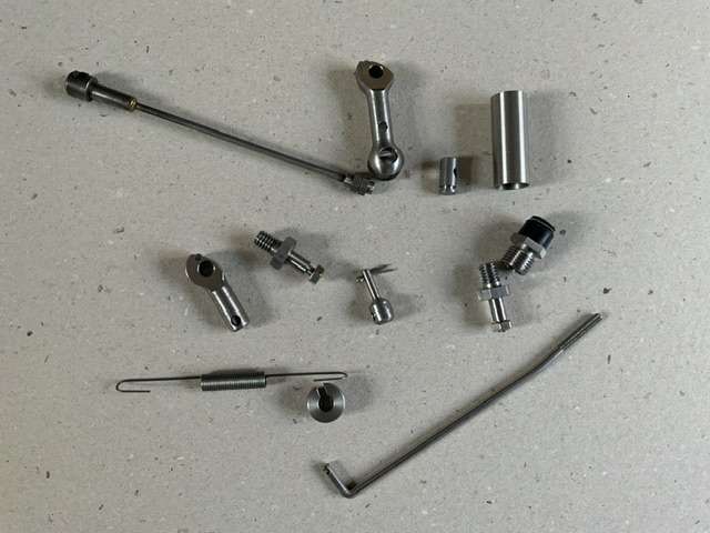

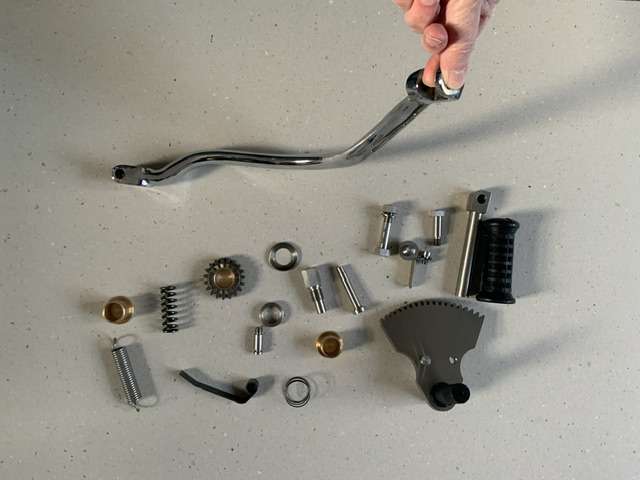

                              #776444
                              Ian Parkin
                                @ianparkin39383

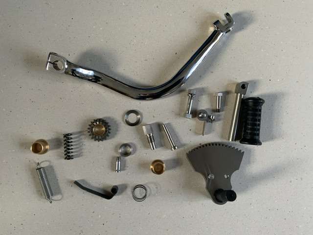

                                I went into deepest Lincolnshire yesterday to Maughans the manufacturer of almost all Vincent parts you would need and bought this lot
                                IMG_3146IMG_3147IMG_3145
                                So thats all the parts to fit a kickstart and valve lifter..
                                the chap at maughans said that the kickstart lever itself was forged rather than some which are cast..
                                what does forged mean in this application? Drop forged into a die? A blacksmith hitting a bar of steel until its close?
                                I must say all the parts are very well made and beautifully finished and individually not too bad in price..but the whole was eye watering price wise

                                  #776503
                                    what does forged mean in this application? …
                                    Drop forged for sure.  Apart from traditional work blacksmith forging is rarely done these days.  Welding does a better job most of the time.
                                    Drop forging is common whenever strength is important.  Whacking metal into a die with a giant hammer improves the metal by compressing the grain.
