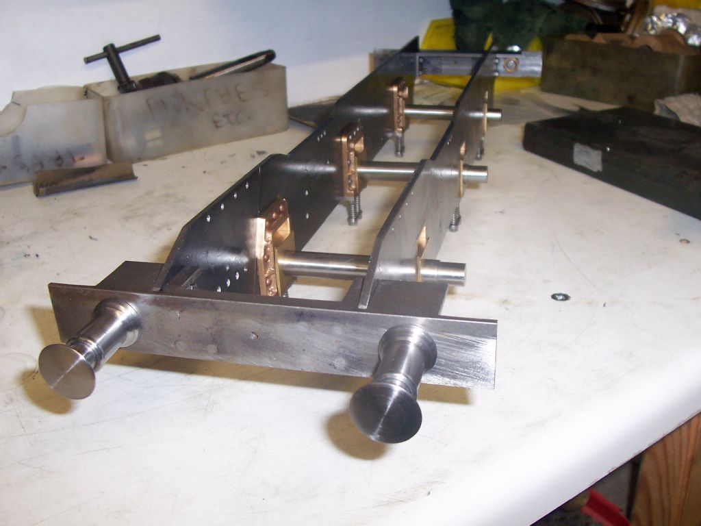

                Glad you sorted out the problem, I'm building a 3 1/2" Molly too! Difficult to find much info on this model.
                I got as far as building up the frames, axles and buffers then work stopped as other things took priority.
                You say it is part made, It would be great if you could post up your progress, hopefully it will give me inspiration to start again.

                    Thanks for the link David. And despite looking I think I have probably only seen one of these Molly's at model engineering shows.
                    Just noticed the dates of the original postings, my photo is a few years old too!
