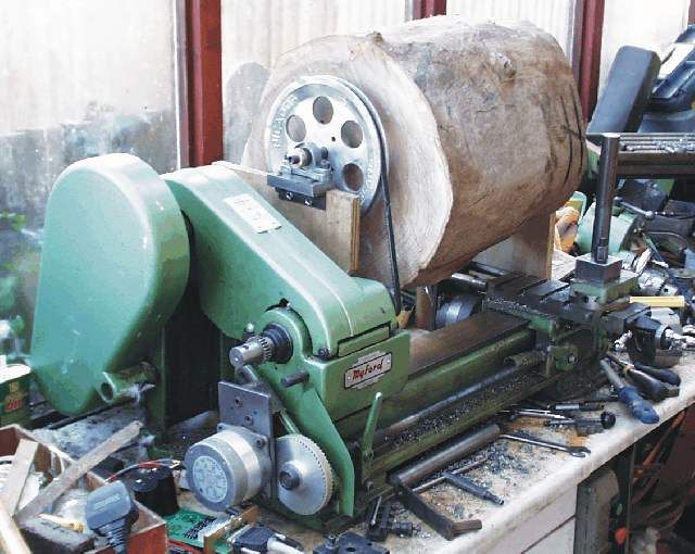

                As Howard points out, the faceplate gives you considerable increase in swing. Re. speed control. I cannot recommend too highly fitting a VFD/3hase motor combo. Transforms speed control (even pn my TriLeva)
                rgds
                Bill
                #438721
                Georgineer
                  @georgineer
                  There are other ways…
                  George
