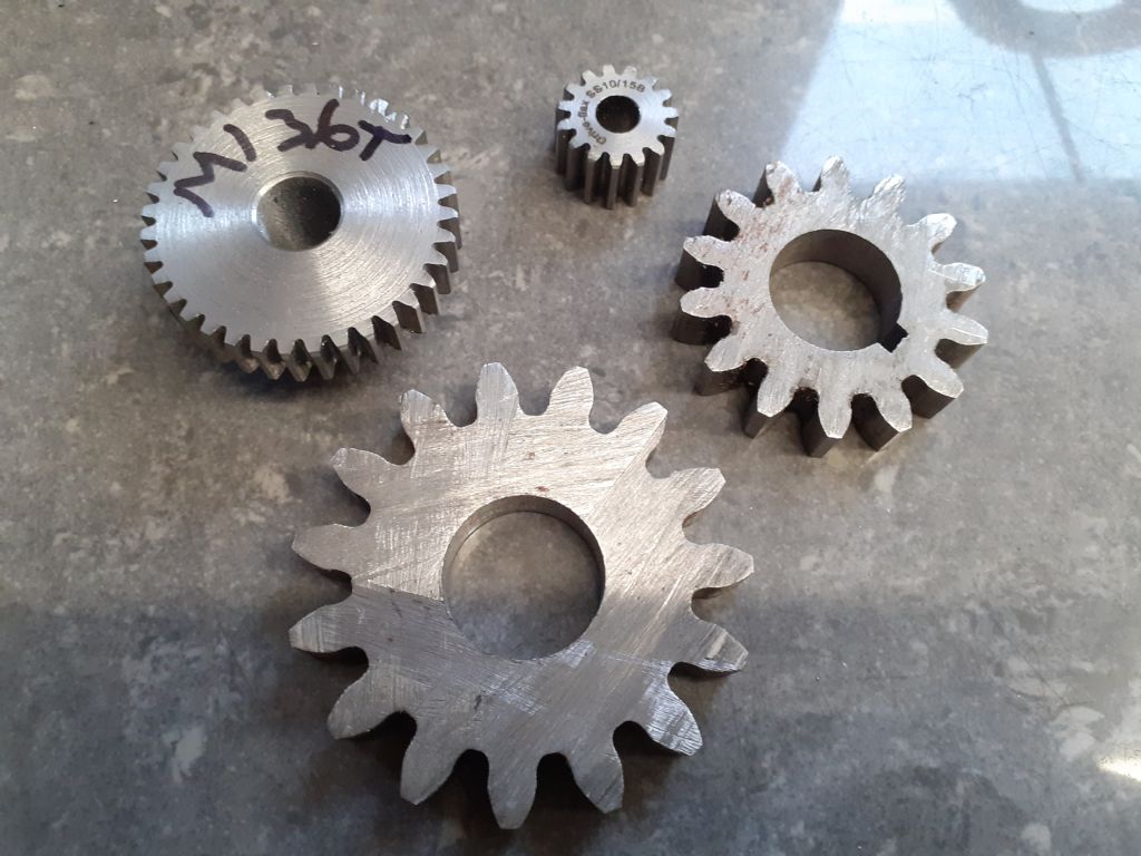

                          …but can't seem to find anywhere to buy pre-made gears…
                          Not to the specific pattern for a particular engine, no, but you've a chance if they are to regular DP or module sizes and tooth-counts.
                          For there are transmission-components dealers who sell stock gears, usually made with hefty great bosses, keyways and grub-screw holes, but cut in a machinable steel so capable of being modified if necessary for the application.
                          Many industrial gear users now use this approach, rather than cutting their own wheels. It's cheaper, without sacrificing quality!
                          #534309
                          not done it yet
                            @notdoneityet
                            Many gears can be cut just using a lathe – no mill and no rotary table involved. I know of at least one youtube channel where the you-tuber has demonstrated making gears with his lathe.
                            #534310
                              As Nigel says you can get off the shelf gears that can be modified. HPC will have the DP gears which are wide enough to give you two to the thickness required if sawn in half and faced to thickness.
                              Slightly cheaper would be to use imported metric gears from someone like Beltingonline, again thick enough to get two for one. 1MOD would works out just about right if you used 76T & 15T rather than the 72T & 14T of the 24DP size.
                              Both options probably cheaper and better than laser cut

                                      Using this site (https://www.mechanicdrive.com/spur-gear-calculation) for Myfordboy's TE I get:
                                      72/24DP = outside circle of 76,176mm dia
                                      14/24DP = outside circle of 14,812mm dia
                                      Centre distance 45,494mm
                                      Using 75 and 15T 1Mod gears I get:
                                      75/Mod1 = outside circle of 75mm
                                      15/Mod1 = outside circle of 15mm
                                      Centre distance of 45mm
                                      So that really is perfect.
                                      Unfortunately both belting and HPC are charging £19+ for the larger gerars and I'm not sure I can cut a 76mm gear in half lengthways! I think rather than £60 on gears I'd rather spend £150 on the VDH or £120 on an off the shelf rotary table/DH and make my own going forward!
                                      #534444
                                        Think I meant to write 75 & 16 T which will give just 0.004mm error that can be taken care of by depthing the gears.

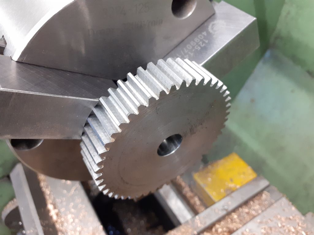

                                          Just for the sake of argument how would I go about facing them? A superglue arbor or something?

                                                Facing them: you could use a superglue arbor, and the worst likely to happen if the tool digs in, is the glue shearing.
                                                Alternatively use an arbor that mimics the shaft it will fit on the engine, and holds the gear in the same way.
                                                I have tackled a similar task recently by holding the component to the faceplate by screws tapped into holes in it – but this was a part that either had four holes in it anyway, or their inclusion made no functional or aesthetic difference to the finished part.
                                                As a guide, an ML7 faceplate is 9" dia., and the T-slotted saddle turns the lathe into a small horizontal borer for bulkier lumps such as the smoke-box and cylinder.
                                                #534468

                                                      Posted by William Ayerst on 17/03/2021 20:04:42:
                                                      bought or homemade softjaws are the ideal thing for that and unlike an arbor will allow you to face the whole surface.
                                                      A few spare halves from gears that were thicker than needed, more have been shared with people making the same engines. Unless your hacksawing skills are really off then as the MB gears are quite thin you will not get into trouble if the saw wanders a bit so no real need for staring with a parting tool. Just leave the gear in the vice and saw it in several sessions while working on something else
